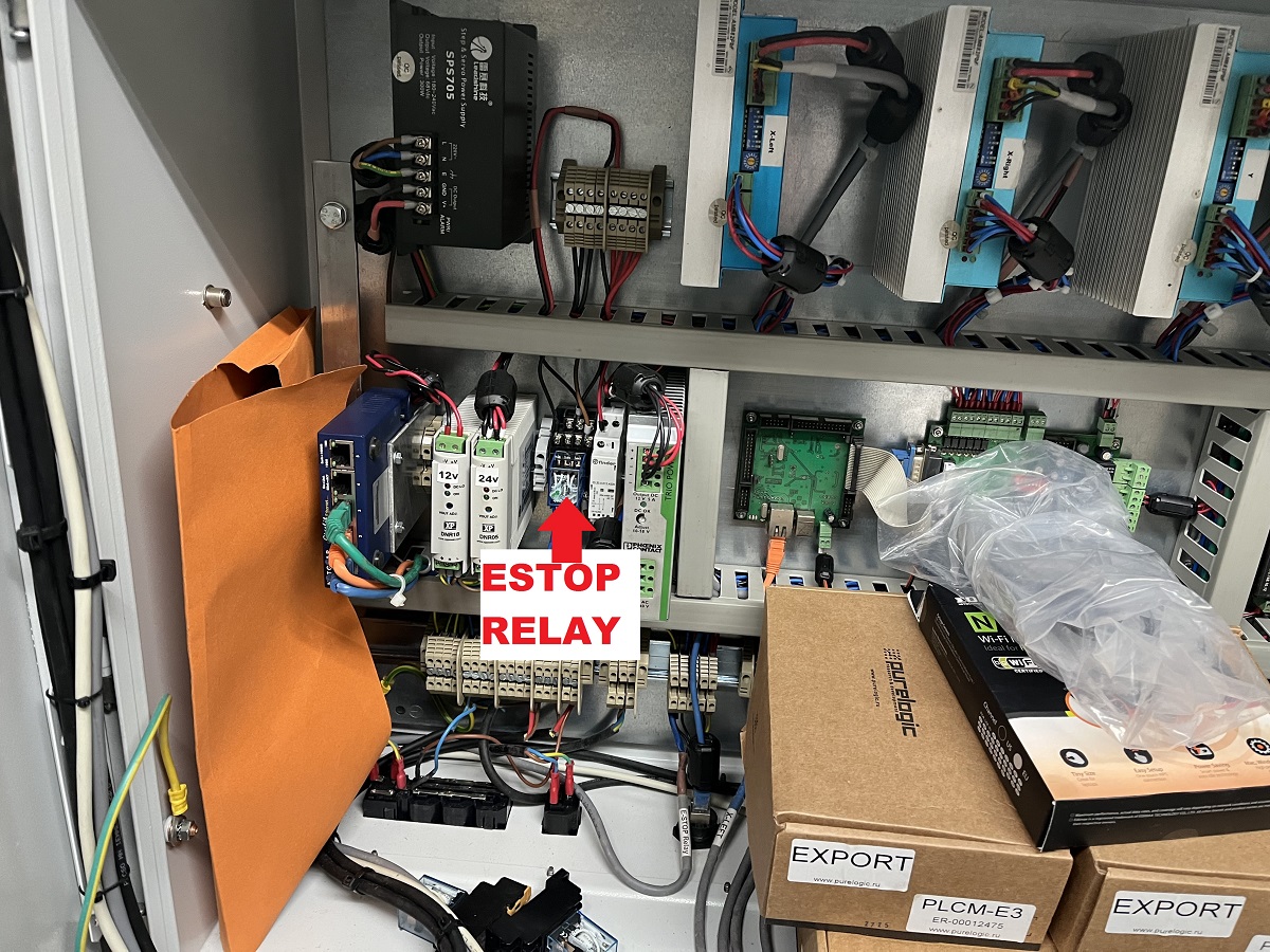

I've been chasing an intermittent fault on my home brew CNC Plasma Table for ages, and I THINK I may have bottomed it at last. Symptoms were that after maybe half an hour of use or maybe much longer I would loose control of the steppers. Mach3 screen positions would change but not the steppers.
Now as it's electronics are in an industrial cabinet with a safety interlock it was impossible just to 'open the box' and measure stuff. Fault most often arose at the end of a job, and then the other day I noticed that a sharp tap on the cabinet would bring on the issue. OK overcoming the interlock I started running with the door open and applied the 'tap test' ie tapping in the manner of a reasonable man with an insulated screwdriver handle. I soon narrowed it down to the area of the Omron relay that is my Estop.. Could be wiring, the relay socket or possibly the relay itself.
Wiring seemed sound as a bell, socket looked fine as did the relay. Spare relay and socket ordered, which arrived today. Quick test to prove that I could still bring on the fault (I could) then install the new relay. Much tapping banging and thumping later - fault gone.
That was 6 hours ago, and I can no longer induce the fault
The offending relay:
My theory is that as the coil is powered all the time it must run a bit warm and the way it is mounted it is under the four sets of change over contacts - spring retainer not quite strong enough and vibration (or me thumping it!) was inducing contact bounce tripping the 68 volt power supply for the stepper motors.
. . .trouble is with intermittent faults . . how long before you KNOW it's cured !

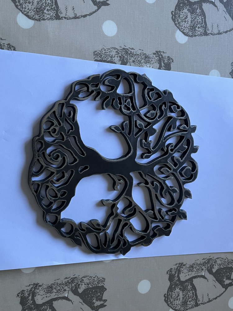

Thanks Pete, yes so far all seems well. Yesterday I left it powered up for a good 12 hours with no issuue, and today I cut a 'Tree off Life' which is a complex path set and a lengthy cut both in terms of time and cut length, with no problems. Quite a relief as unreliable kit is a pain.I think you can call it done. Well done finding the fault, even with all the clever test equipment sometimes the frying-pan test is all you need. Intermittent faults are the bane of our life on the demo robots I've sent the same machine back 3 times because it would power up fine in the workshop but knock the earth leakage trip out on site. Workshop blamed the site power, site blamed the machine. The thing is, we had three other machines on site all running fine so the last time I sent it back I told them if they sent it again I wouldn't even try to unload it.

Interestingly Big Clive did a video some time ago about fake Omron relays over heating. Now mine probably is a fake as it was only £4.50 on ebay - genuine ones (presumeably) on RS components are about £15 so if I have further issues I'll get a real one!it manifests as a smell
what thickness is that?Thanks Pete, yes so far all seems well. Yesterday I left it powered up for a good 12 hours with no issuue, and today I cut a 'Tree off Life' which is a complex path set and a lengthy cut both in terms of time and cut length, with no problems. Quite a relief as unreliable kit is a pain.
6 mm - well actually probably 6.35 as it's old imperial stock.what thickness is that?
nice, looks like it cuts that no problem!6 mm - well actually probably 6.35 as it's old imperial stock.
