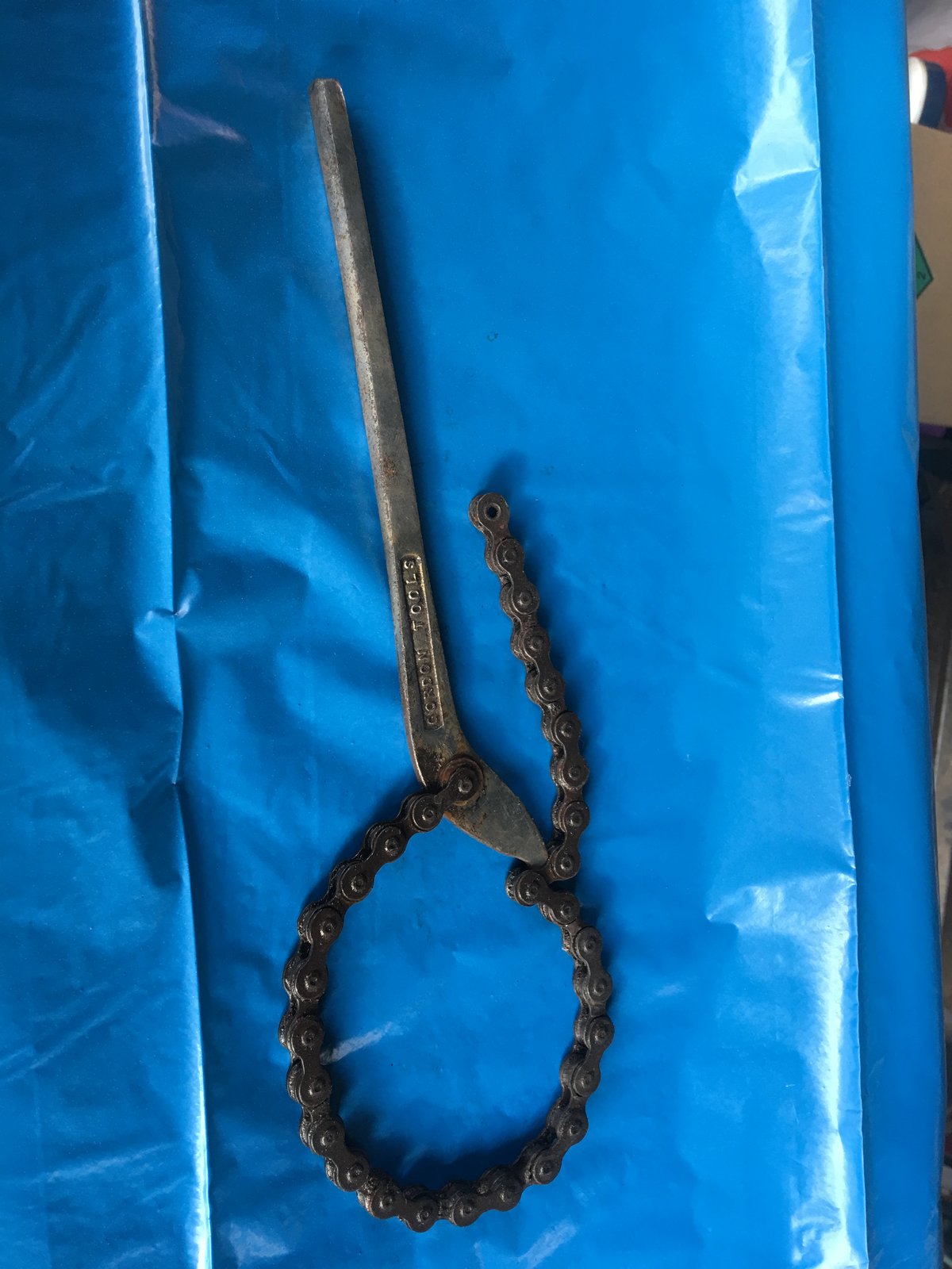

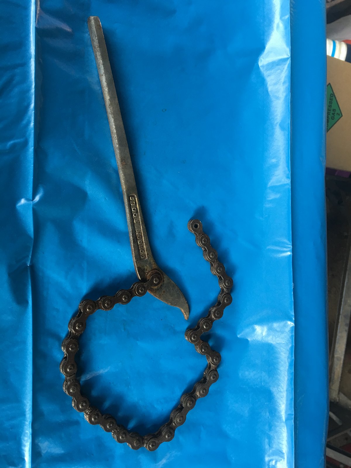

interesting homemade chain wrench video
Here is the chain wrench that I posted above, Very simple, Very effective and fully adjustable, One leg from a pair of eagle beaks (water pump pliers) with the end ground to enter any of the bike chain links, It's even got my name on the handle.![]()
