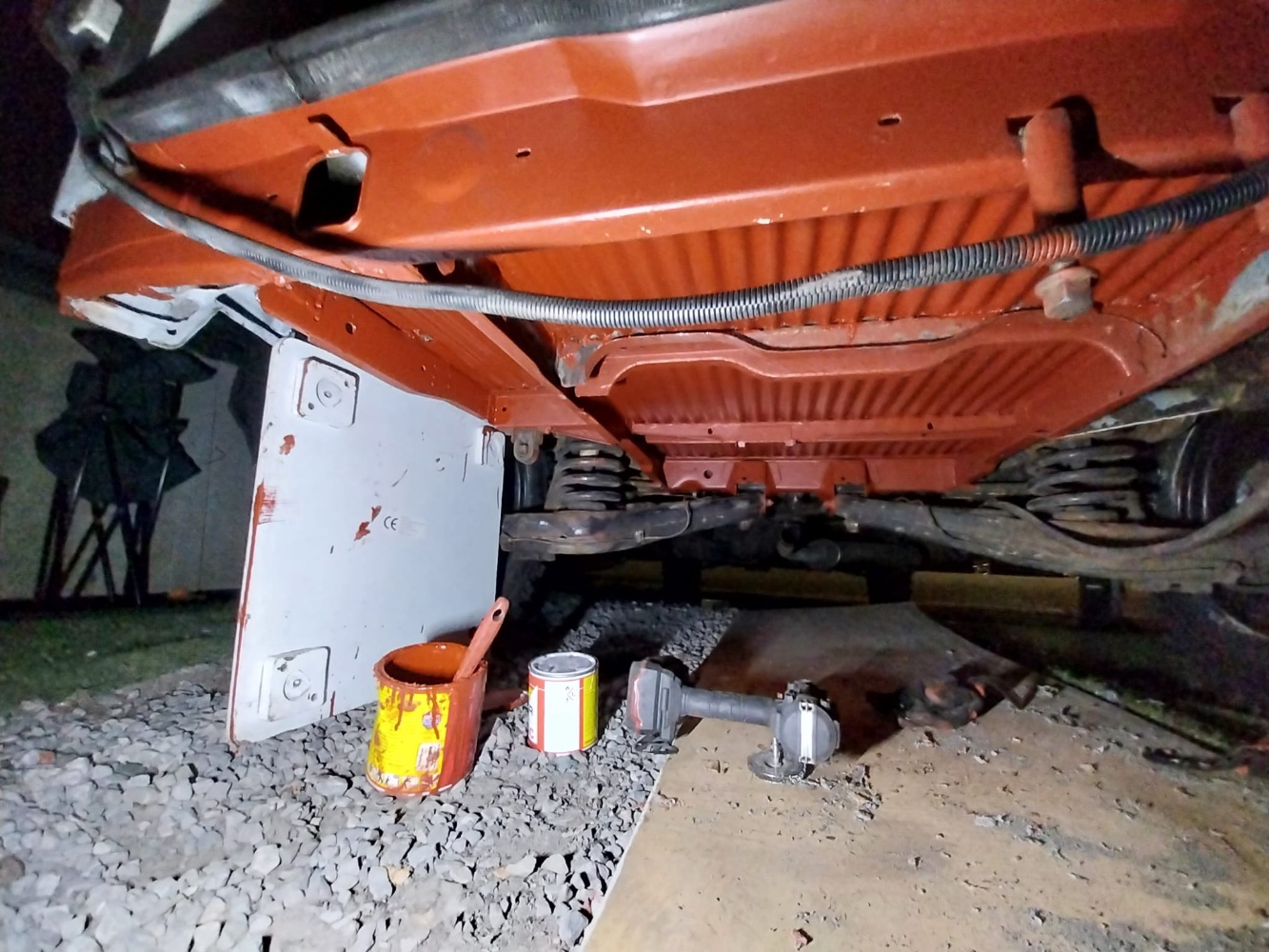

Im using both - for cavities and seams im using Electrox, for anything not covered or boxed in im using Bondarust.Obviously Electrox seemed to be the best outcome but pound for pound. Where did you stick your money in your restoration?
Main reason for that is that its much easier to get Bondarust to adhere well than Electrox. Not such an issue in inaccessible areas but could be a nightmare if paint lifts through abrasion elsewhere.
When it came back from rust and paint removal, it had been sprayed with a weld through primer. I took the primer off the chassis and sprayed it with Bondarust. Several years on, the weld through primer is rusting underneath on the bodywork (curiously especially where grinding dust falls on it) but the chassis primer I redid with Bondarust is perfect.
