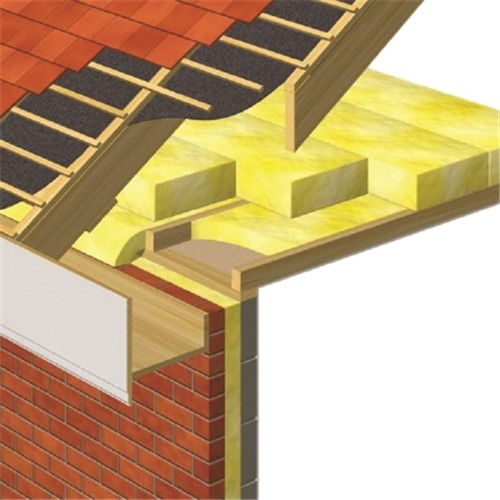

The warmer home grant people surveying our bungalow took one look in my roof void and said it's all got to come out as most of it has turned to dust.you will be fine as long as it resmbles this normally the 4" insulation between the ceiling joists is enough for over the first wall
the second roll is rolled out and pushed into the rafters thats more than ample enough
on some you can fit another layer ontop at the edges and it still will allow 1" of air to be in the loft space across the whole roof area its more than enough to allow air flow in the loft as a cold roof method
