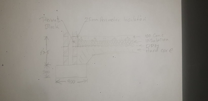

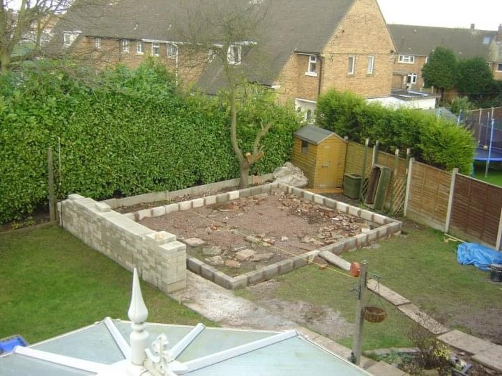

When I built mine I dug footings, poured concrete, then built two layers of 6" solid concrete blocks to what would be floor level. That was backfilled, hammered down then a DPM laid in. I never bothered with insulation but I could have left some of the rubble out and put a good few of polystyrene in at this point then concrete over that. And I could have put a layer around the edges, effectively insulting the concrete slab totally.aha, so basically I'd pour footings / normal strip foundations first, then build walls (at least up to floor level), and then pour the flor slab afterwards?
You can get special, thermally insulating, yet structural, blocks for doing just this thing. "Foamglas" or similar:Thank you everyone for all the replies! Much food for thought
I should clarify I actually live in south east England just inside the m25, but originally from Sweden.
I like the thermal brick idea with the extra lining between the floor slab and wall because it seems achievable with reasonable diy skills and the manpower I have available - I think I’ll probably build something like that.
As for if it’s worth it, I want the “reasonable best” I can afford and am able to build. I’ve always had terrible workshops and garages here, with bouncy floors, damp etc etc. I want something where the lathe won’t rust, and where I can passively heat as much as possible etc.
Will post a thread in projects when I have some photos to show.
I want to insulate it, because I may at some point want to use it as an office, and tbh in Scandinavia we insulate the crap out of everything and it's just nicer to be in an insulated space IMO
Will have a look at that thread![]()
50-100mm jablite polystyrene with DPM on top then just pour your slab with a layer of mesh.

if he doesn’t turn up, or the quote is ridiculous I will just dig it out myself.. unfortunately the house is stupid in terms of side access - 74 to play with without starting to remove downpipes etc, and about 85 if removed
might have to revert to normal block walls, but waterproof aircrete blocks that have a high insulation value and take a fraction of the time to lay sounds good otherwise.
Search for similar in your area ? .. these go through doorways easily they are not overly expensive either if you run it 24/7 and have plenty of lighting & fuel to see you work into the nightCurrently waiting for a chap to pop around to give me a quote to dig the foundation outif he doesn’t turn up, or the quote is ridiculous I will just dig it out myself.. unfortunately the house is stupid in terms of side access - 74 to play with without starting to remove downpipes etc, and about 85 if removed
The Scandinavians have some great looking bases - insulated blocks that fit together like Lego that concrete is poured into to make an insulated base … would take a day to build it that way, but sadly not available in the UK without crazy lead time.
Another thing I’m struggling with is finding blocks that support “thin layer mortar” systems - basically glue for blocks that make the whole building waterproof. The uk blocks are not straight and even enough to allow for this, seemingly, superior construction methodmight have to revert to normal block walls, but waterproof aircrete blocks that have a high insulation value and take a fraction of the time to lay sounds good otherwise.
