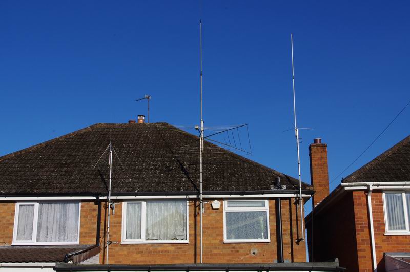

Do you think local fitters will put other antennas up? I need my 11m and 2m/70cm one on the chimney as its flat around here and they are not high enough on the gable
T&K brackets with poles?
I'm not too bad here, about 550' ASL with a decent takeoff.
