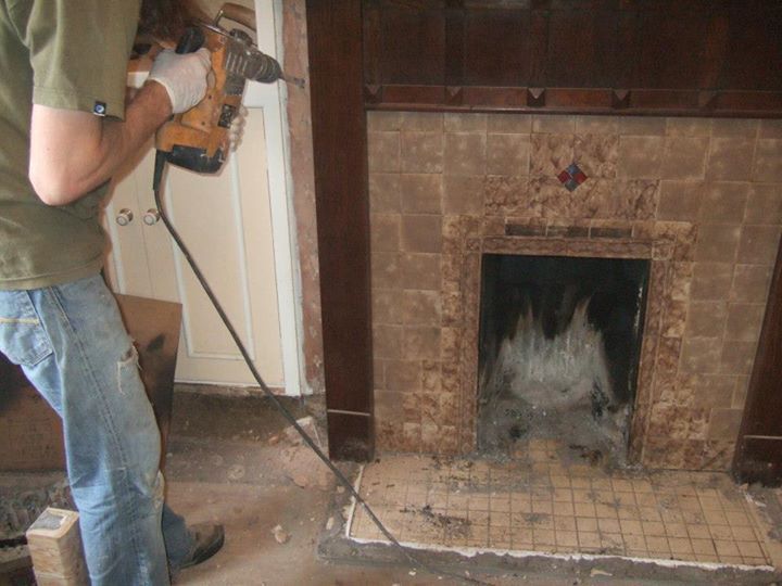

Not the best photos, but the only ones to hand (not missing an opportunity to post photos and all! ; )
This -
To this -
(yeah, i know its not complete in the photo, but its all i have to hand)
And this -
To this -
