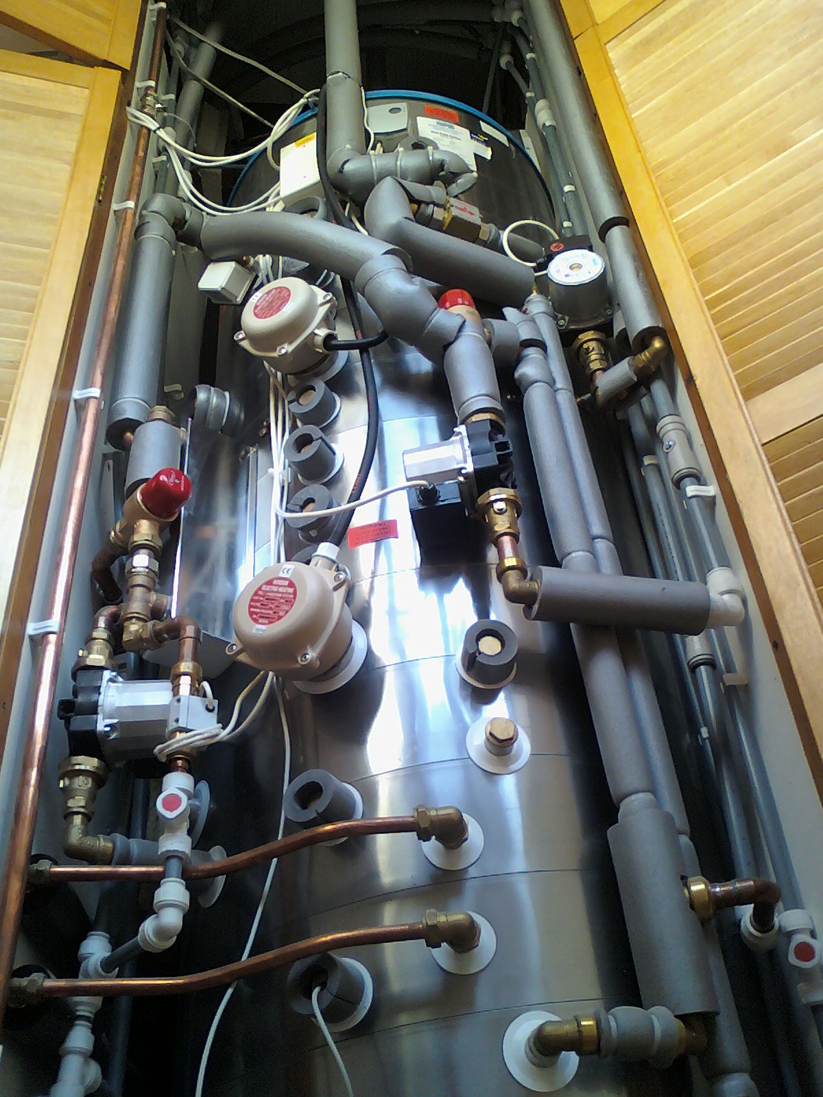

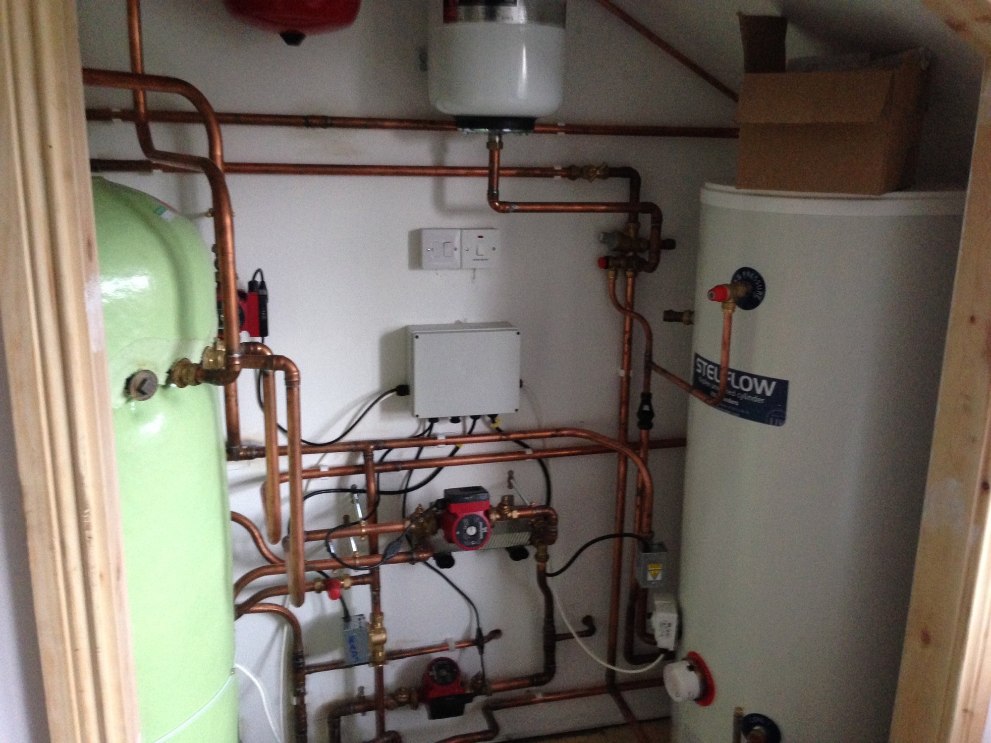

I looked at this about 9 years ago (planned, specced and installed it all myself and it's still working!) I went for a thermal store/heat bank - 500l of well insulated water tank.
This tank is be heated by:
- solar hot water, (separate circuit)
- 2 x 6kw Immersions (on cheap electric overnight if needed)
- multifuel stove (7kw to room 18kw to back boiler)
- I can also plug in anything else in the future (I designed for a heat pump but decided to wait to see if needed)
For rads I used the skirting board type with individual room stats and an over all mixer at the tank, hot water is via a pumped heat exchanger so you get mains pressure hot water from a vented system (no expensive regular inspections).
It works well, except it is designed for a constant low level heat so it takes a while to get the whole place warm from a standing start.
Also not sure how a local plumber would react! (no it was not completely finished at this pic)
I got the tank from DPS that then became these guys http://www.heatweb.co.uk/

I also had a couple or rads bent to fit the bays downstairs.
