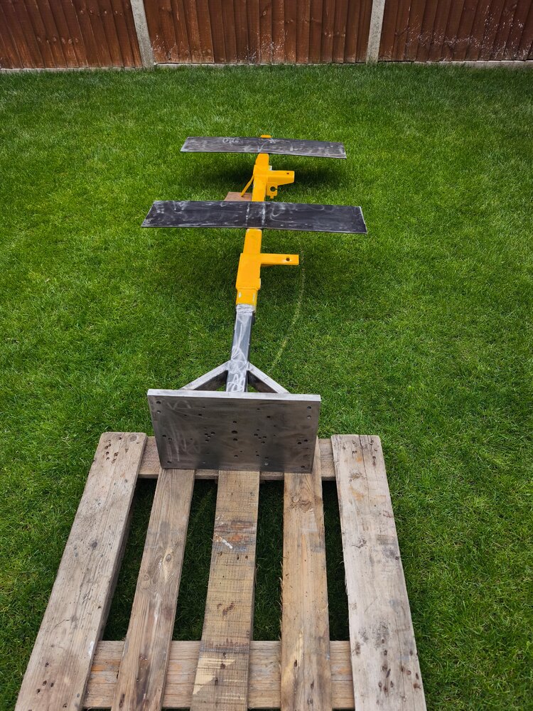

Earlier in the year, I spotted a 'van crane' on FB marketplace and thought it would be just the thing to install behind my lathe to help lift chucks and heavy stock.
While I can manage a 10" 4-Jaw chuck, it is heavy and awkward to lift when installing and removing it.
With my 'new' Huvema lathe, I also have a 320mm 3-jaw chuck that has quite a weight to it.

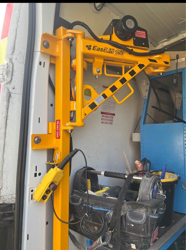

Here is one of the crane listing photos.
It is an Easilift 150 from bri-stor.co.uk

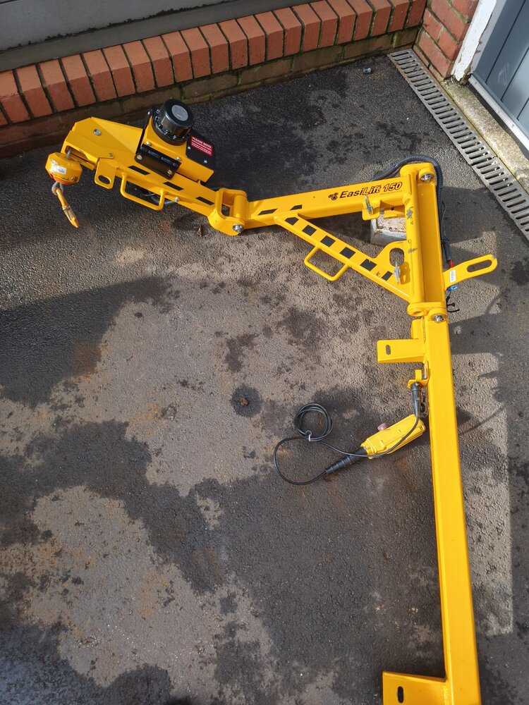

Photo of the crane once I got it home.

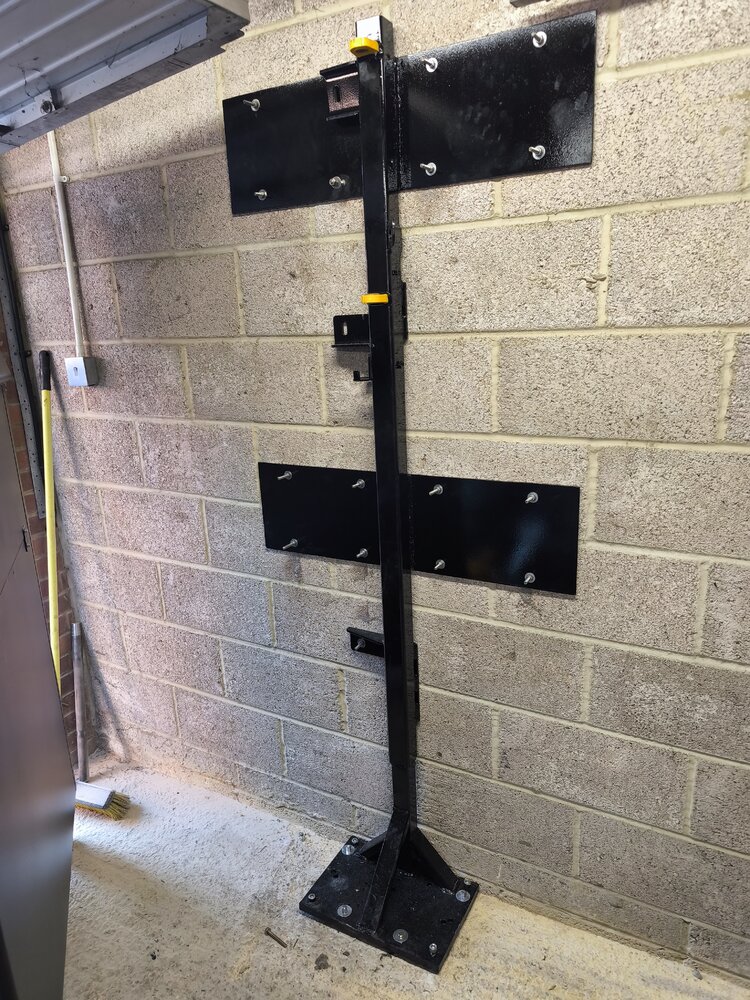

I expected the task of mounting the crane against the wall to be relatively quick and simple.
Wrong!
Some challenges:

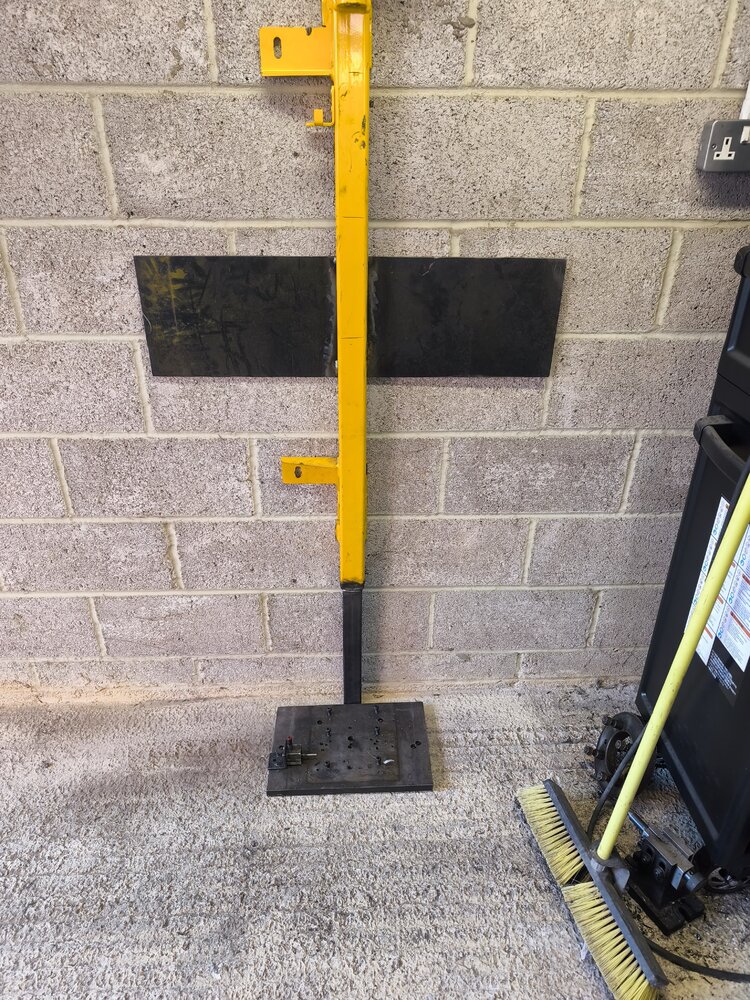

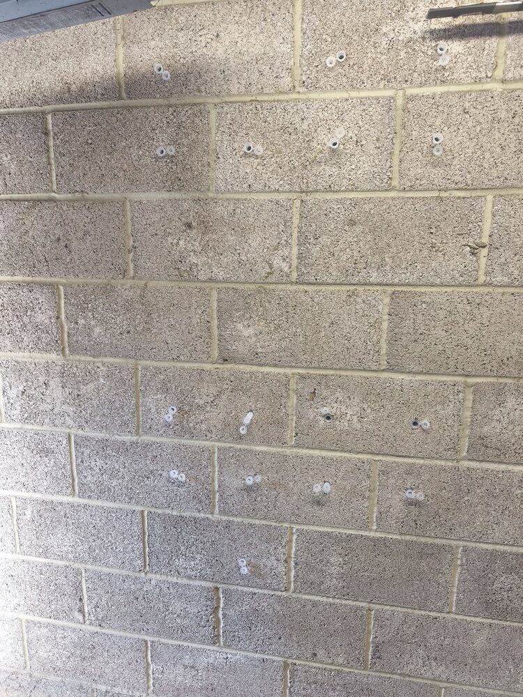

The wall I wanted to mount it to is made out of breeze blocks (not known for their exceptional strength in holding shear loads).

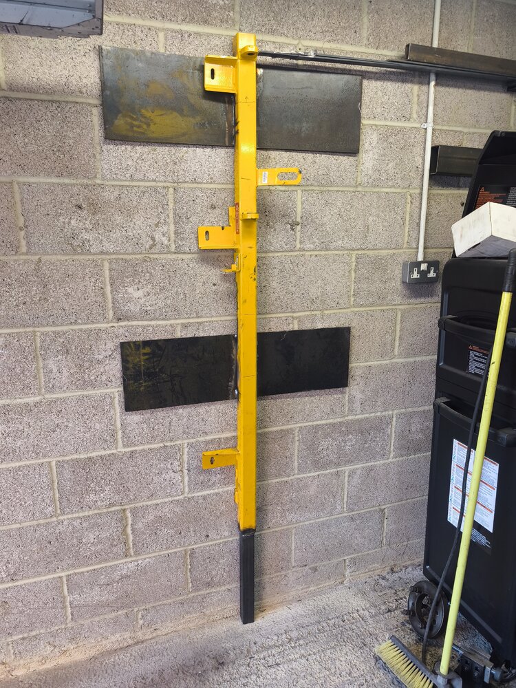

The column was too short (to reach the floor).
The column had brackets that prevented sitting flush against the wall.

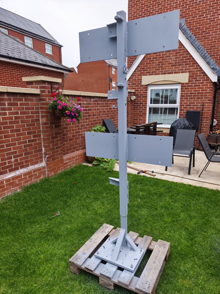

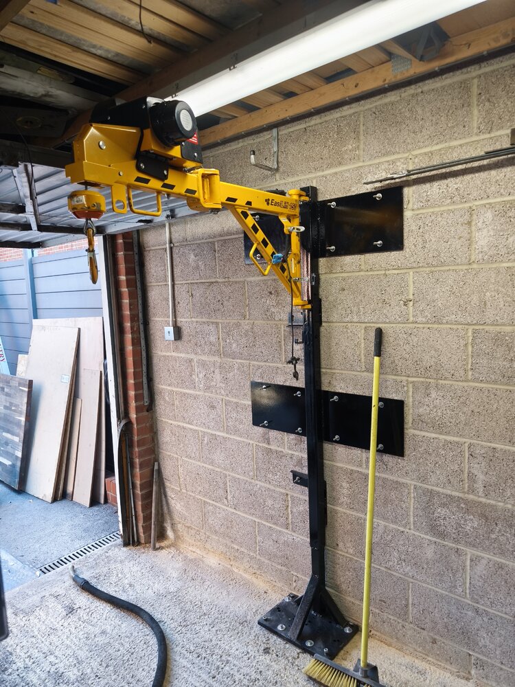

I cut the offending brackets off, extended the column and welded some steel plates onto the column so that I could spread the load on the breeze blocks, which should help to reduce the twisting force on the breeze blocks.

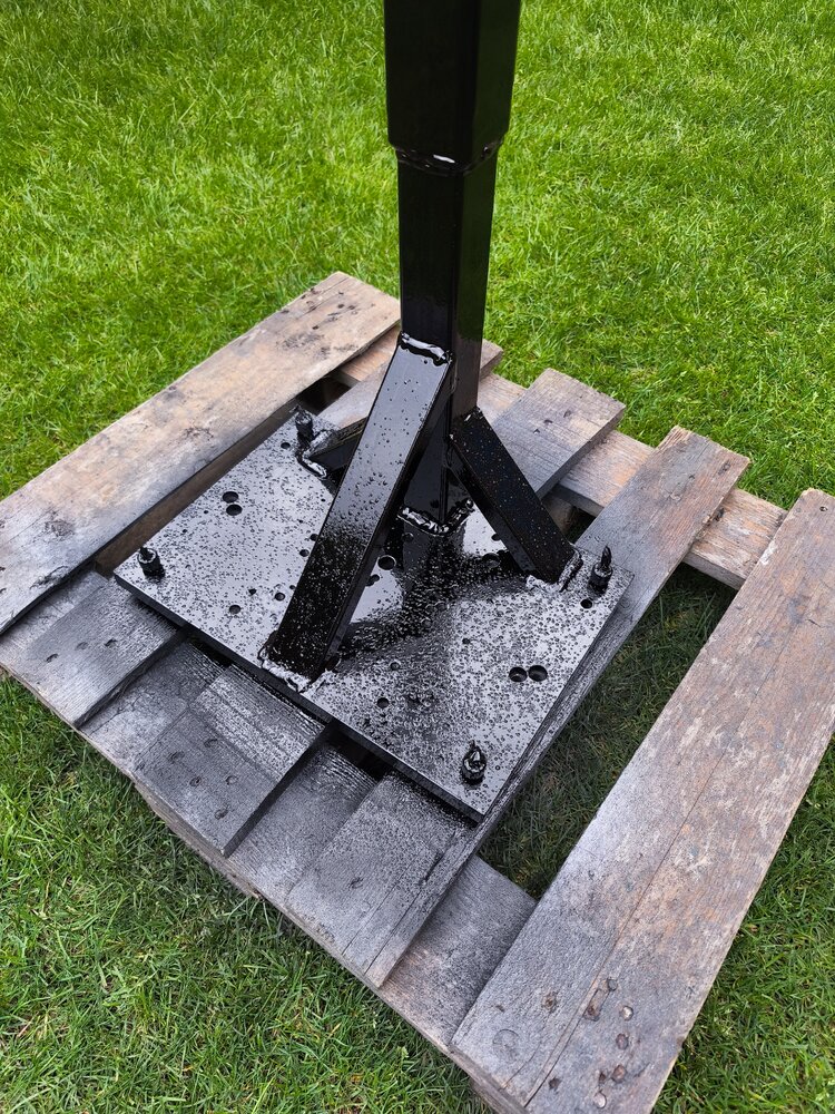

A baseplate anchored to the floor will further reduce the load on the breeze blocks, so I dug through my scrap pile until I found a thick (albeit small) plate.
I welded the column to the baseplate and also added some reinforcements.

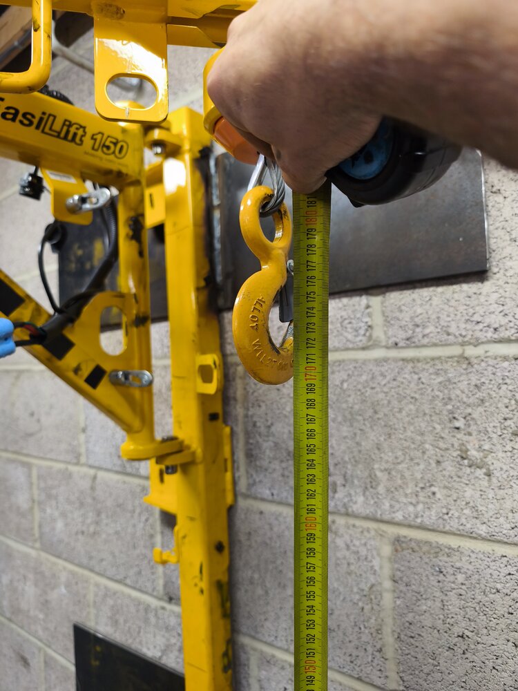

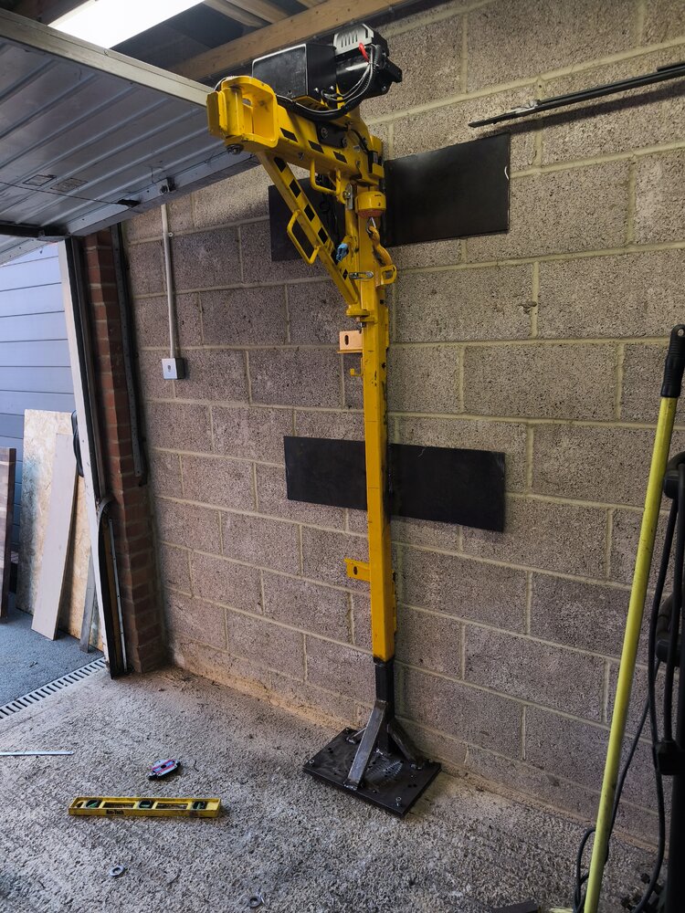

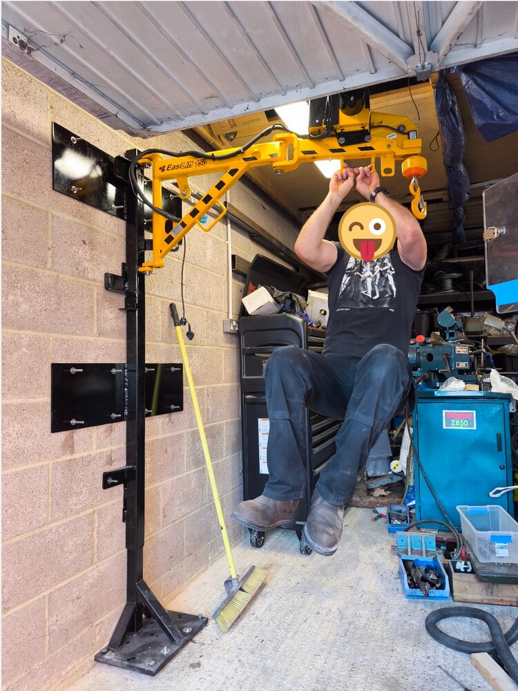

Quick test fit.
It gives me about 170cm to the bottom of the hook.
