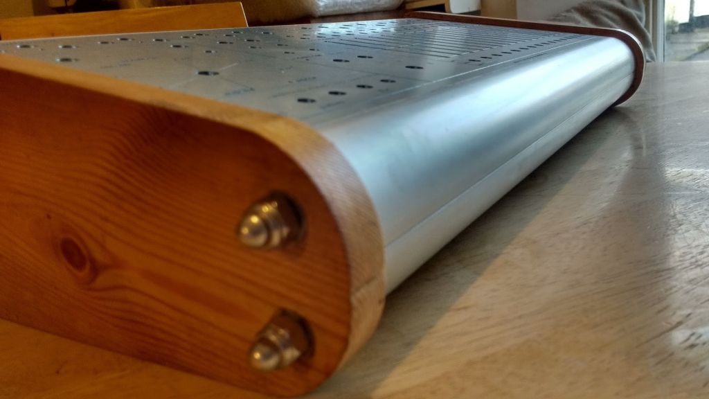

If strength is not an issue the rubber rawlplugs may do the job,there is a steel nut bonded into the rubber. M5 bolt with an 10mm od rubber threaded expansion plug.Just thoughts.
