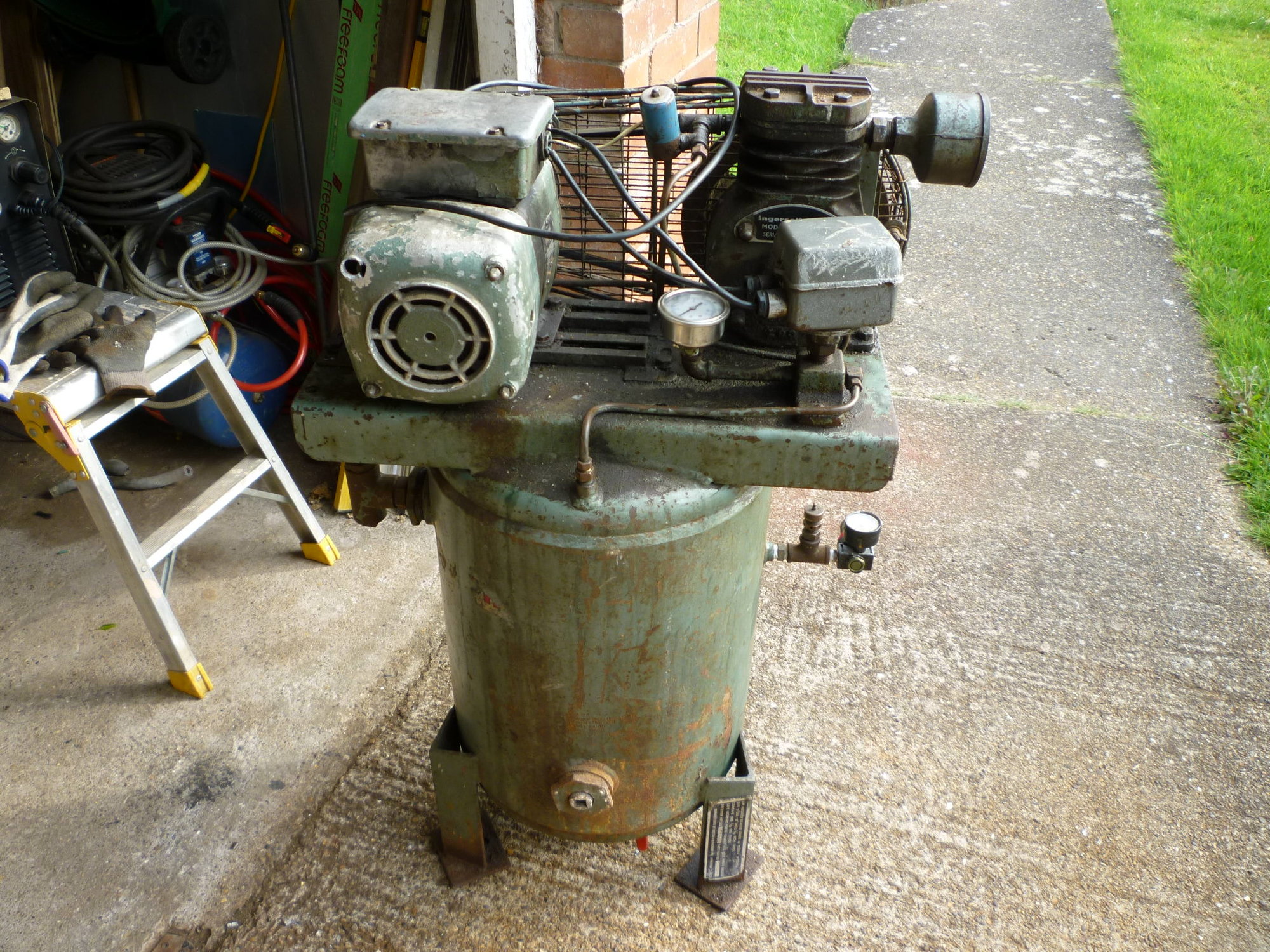

Last week I picked up an old ( 71 ) ingersol rand compressor and not having a great deal knowledge
on them I've some general questions . And please correct me if I'm wrong anywhere.
briefly it starts and runs up to 150psi (in about 3 1/2 minutes )and stops, open the drain and it cuts back in about 90 psi with no nasty noises or vibration. The mounting plate for the motor and comp are covered in oil crud so I suspect there's an oil leek on the compressor .but a local shop tells me they can get the gasket sets for a type A. So I'm hoping its worth spending a bit of time and money on it cost me £55 and a half hour drive.

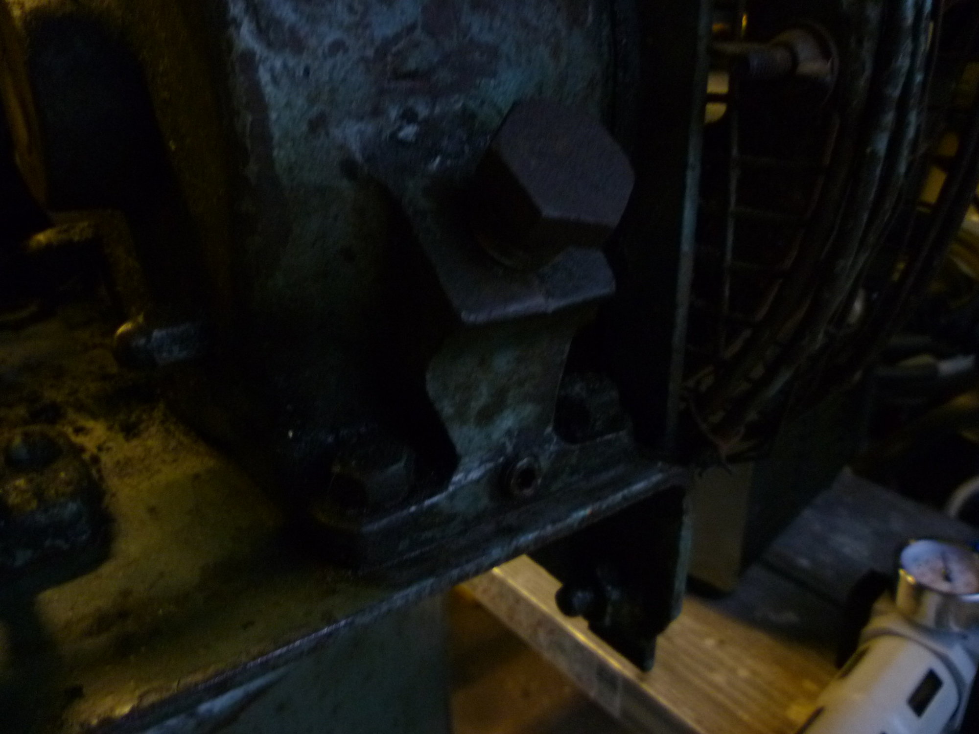

My questions are are on the side of the comp theres a a large bolt and a grub screw underneath
is this the oil fill and drain
so I've been told its SAE 30 mineral oil does it just fill to the bottom of of the plug as its no where near at present.

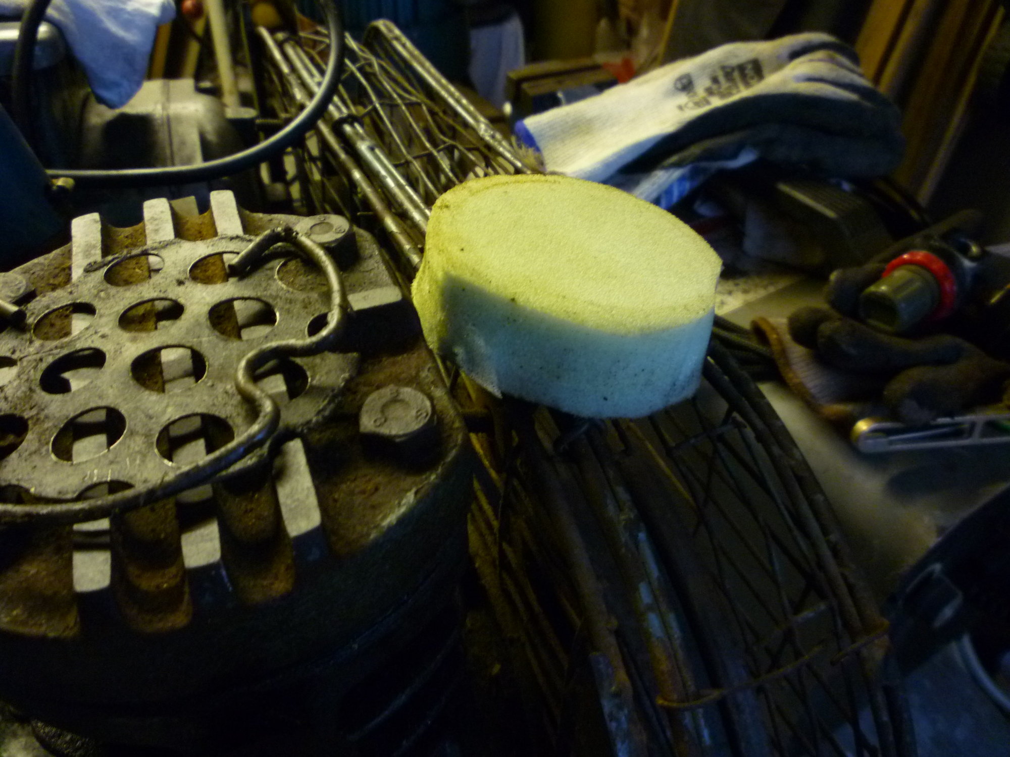

what should I use to make an air filter element at present its a bit of foam.

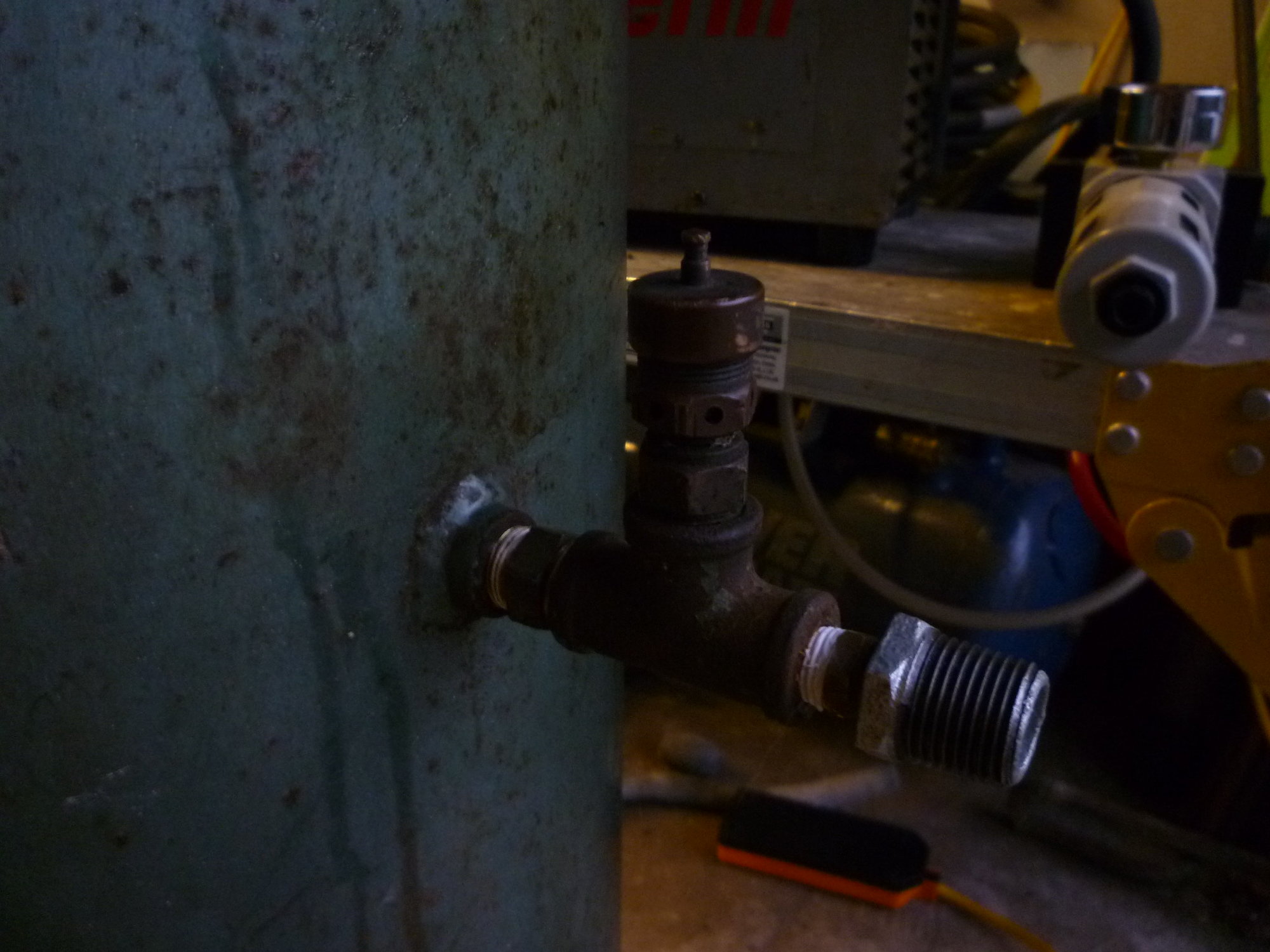

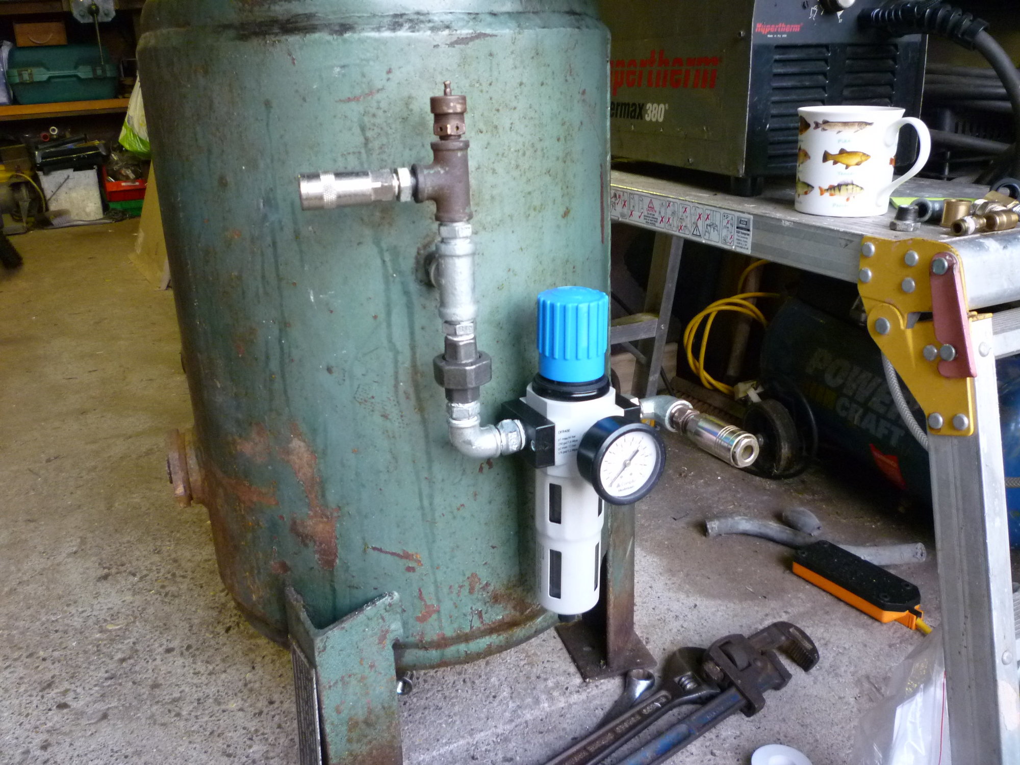

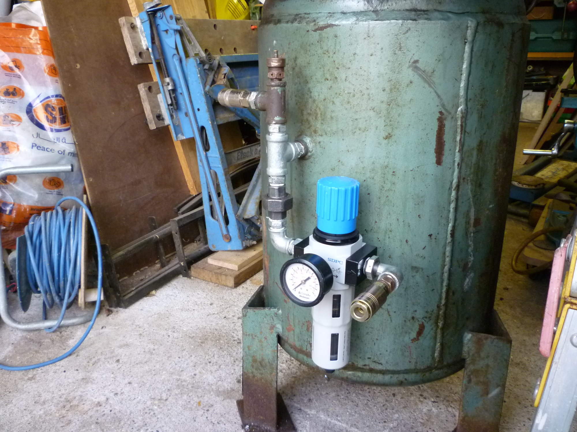

On the receiver outlet theres a 3/8 tee with a valve I'm presuming its the blowoff / safety valve .
has this got to be mounted vertically as I'd like to pipe the new regulator with a take before it and one after if that makes sense
and should I fit a new valve for safety sake ?

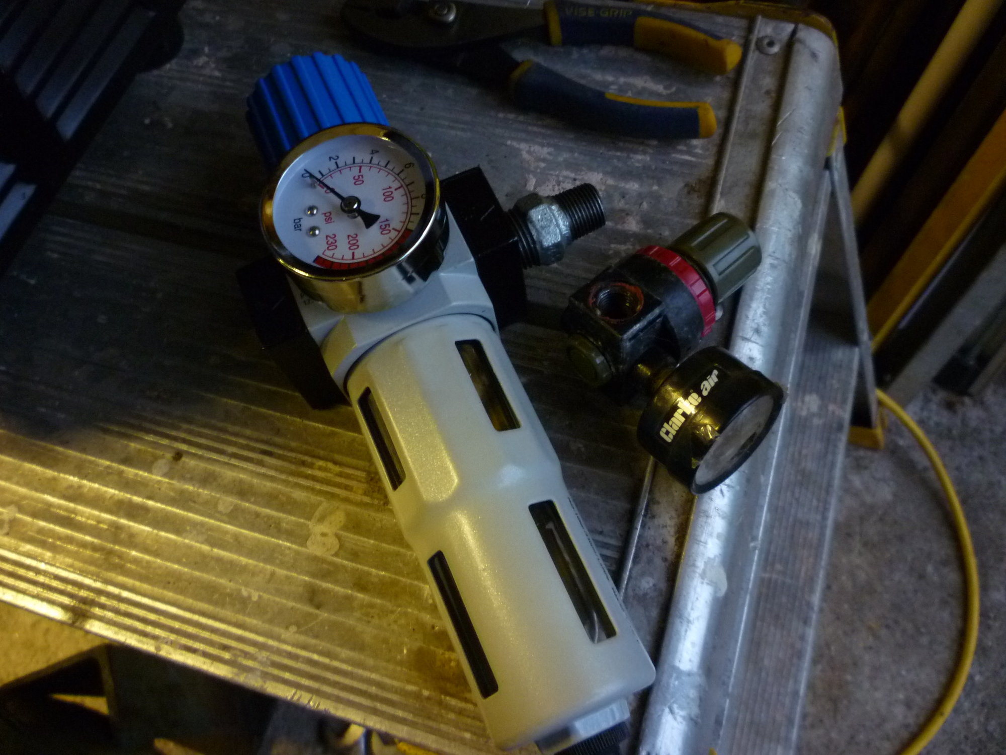

and finally I think Ive gone ott with the new regulator/water trap !

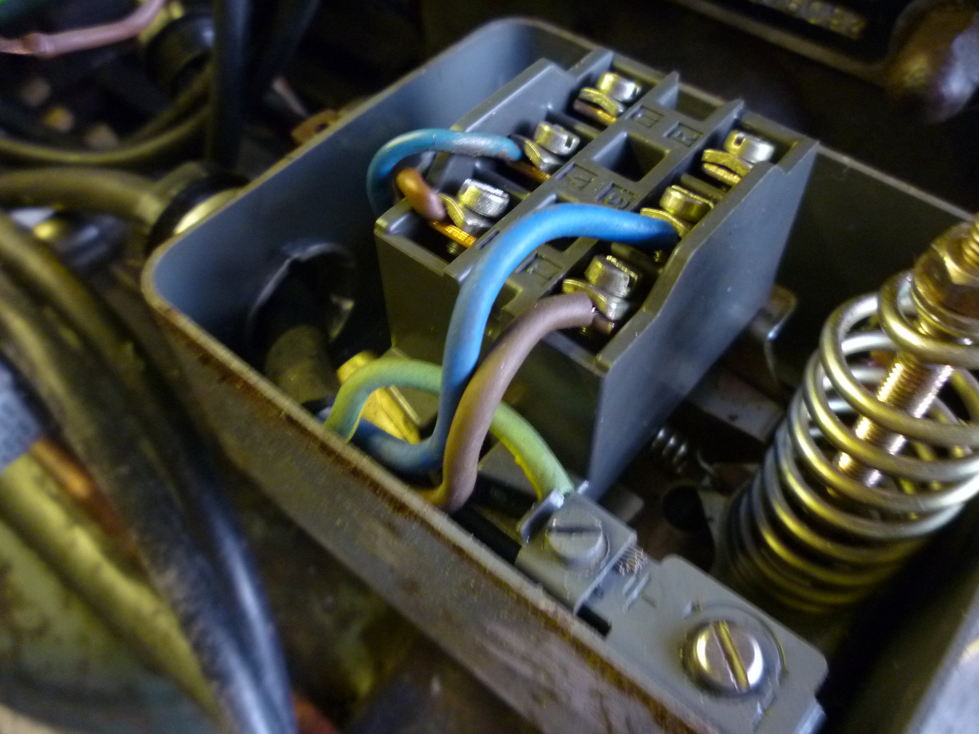

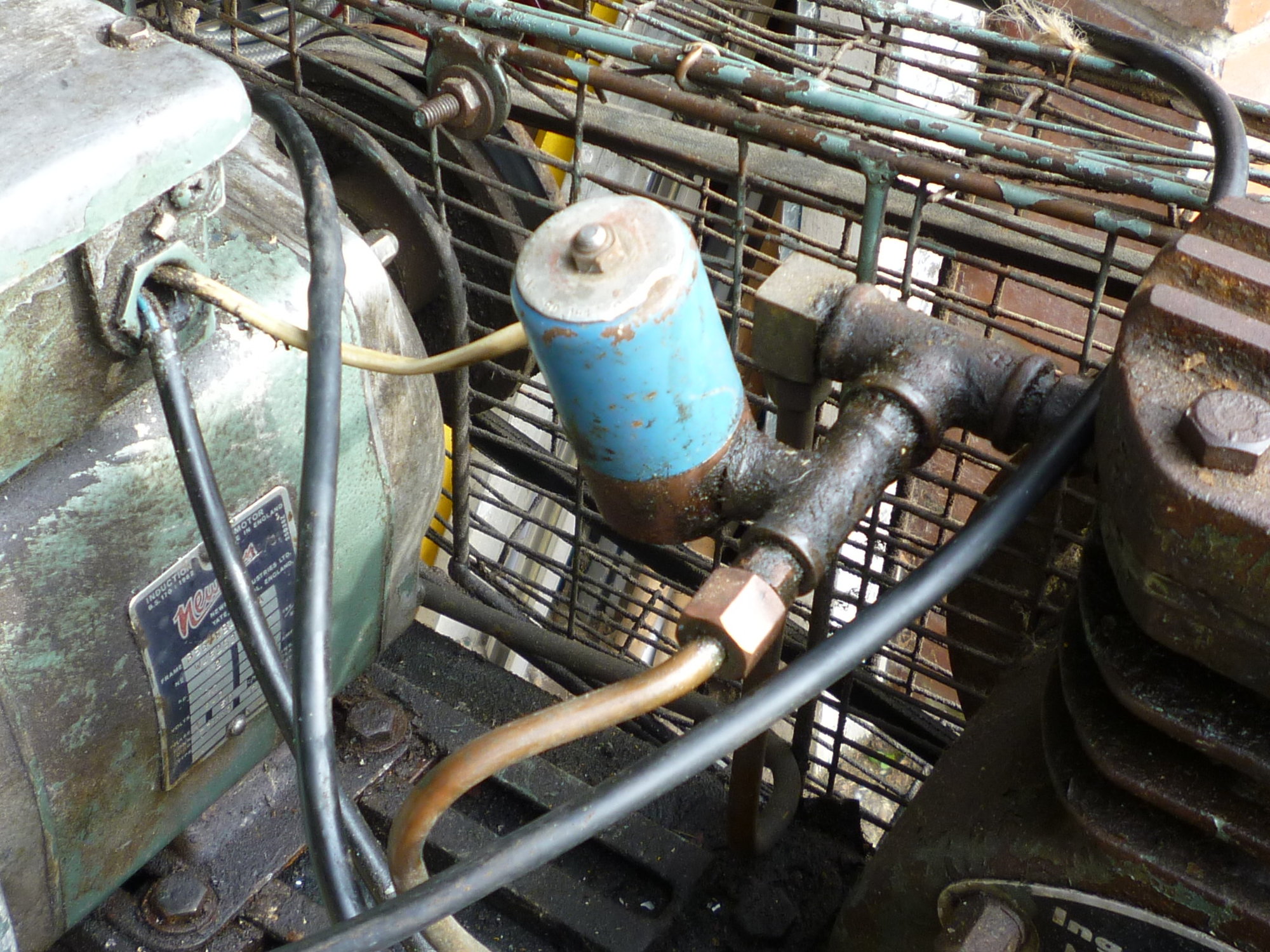

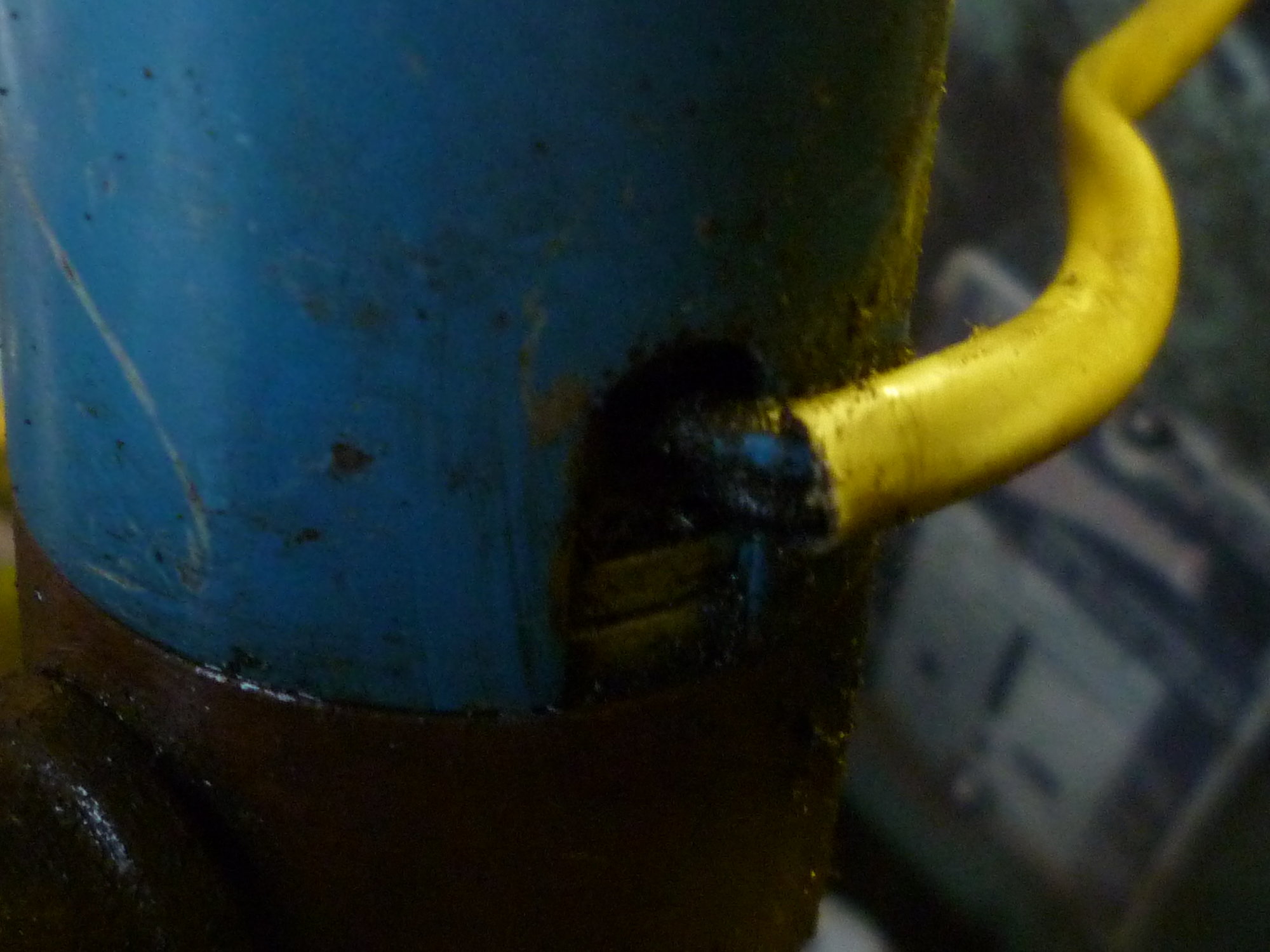

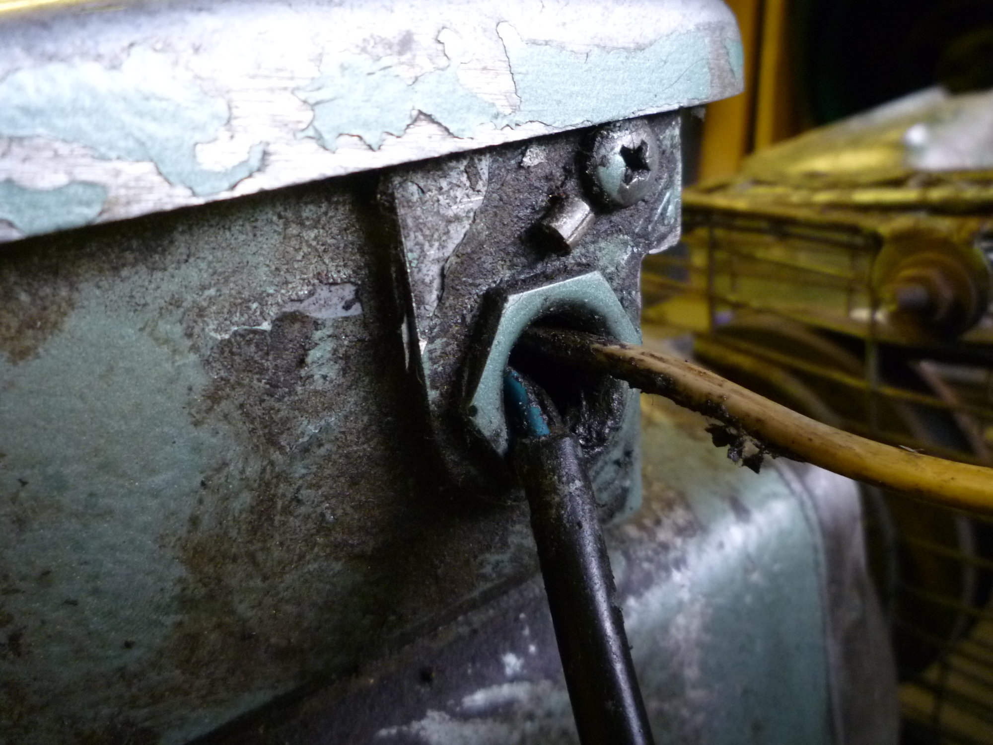

And lastly off the outlet of the compressor theres a tee back to the presure switch with a valve type thingy which is wired to the motor is this the unloader valve ? purely guessed by its position
