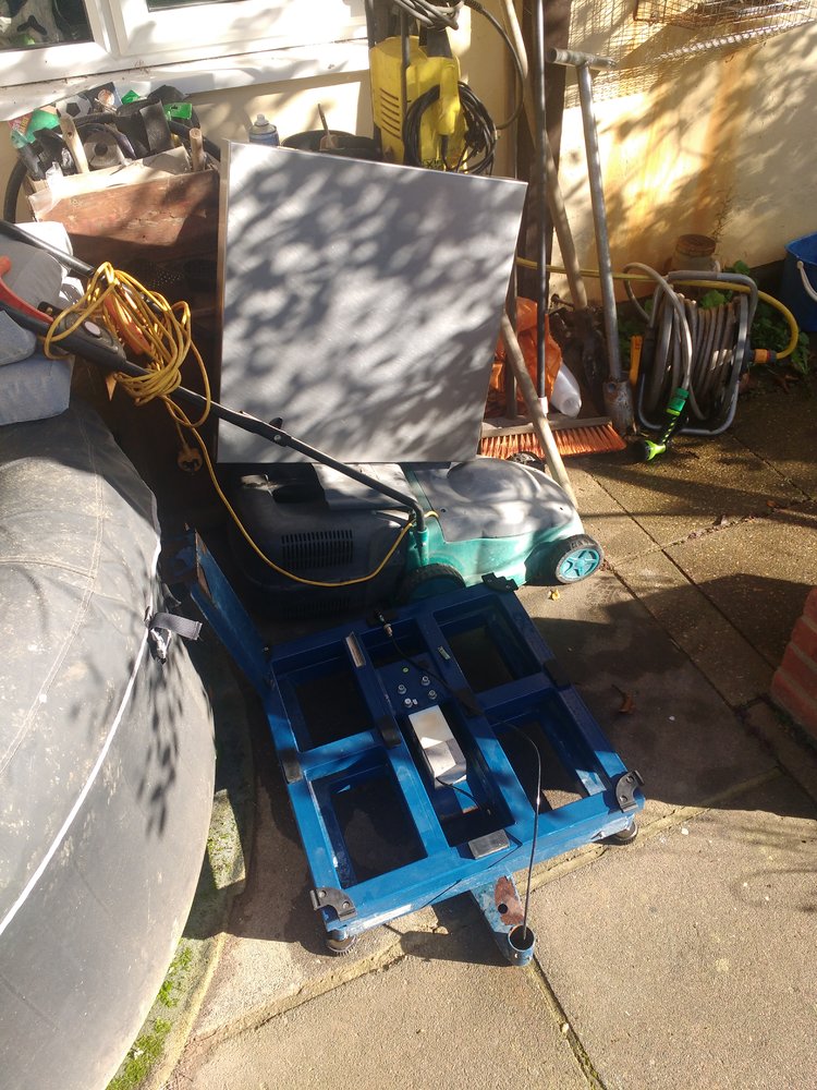

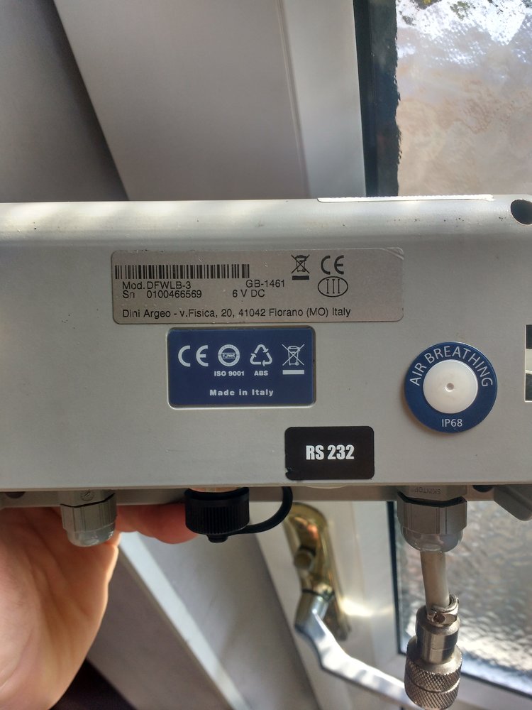

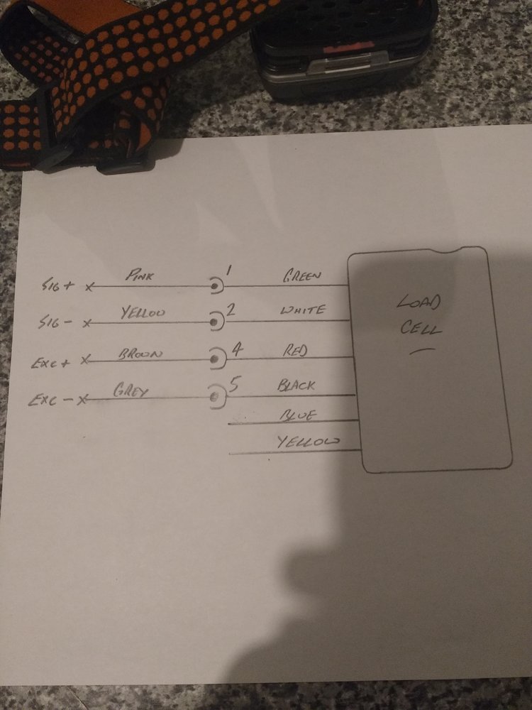

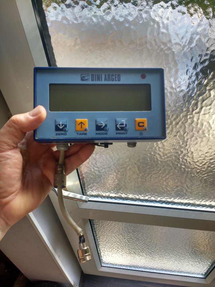

Picked up an industrial weigh scale. It was working. In fact a while back I replaced the grey cable to the control box as a favour.

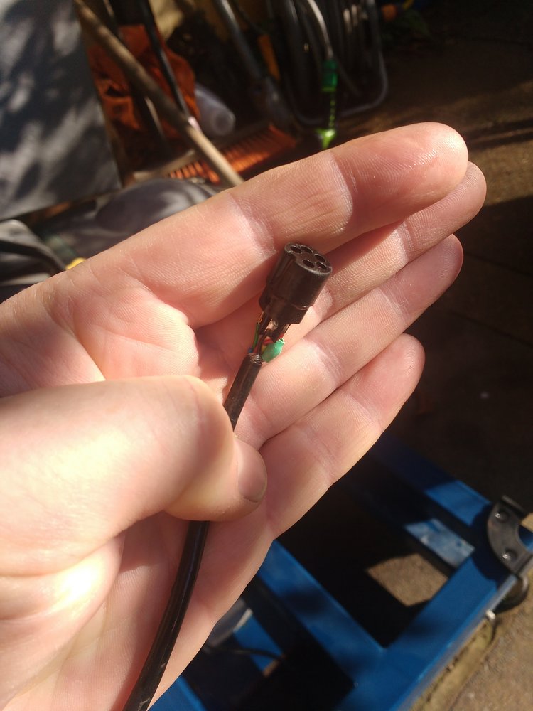

It then died and they said I could have it. The 5-pin DIN socket on the load cell lead had had a tug and only green, white and screen were still connected inside the socket. Red, black, blue and yellow were all disconnected.

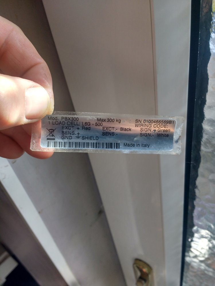

Load cell:

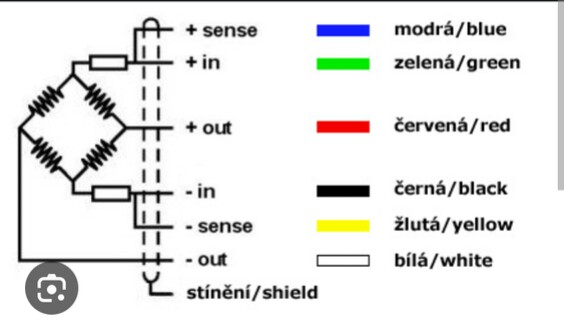

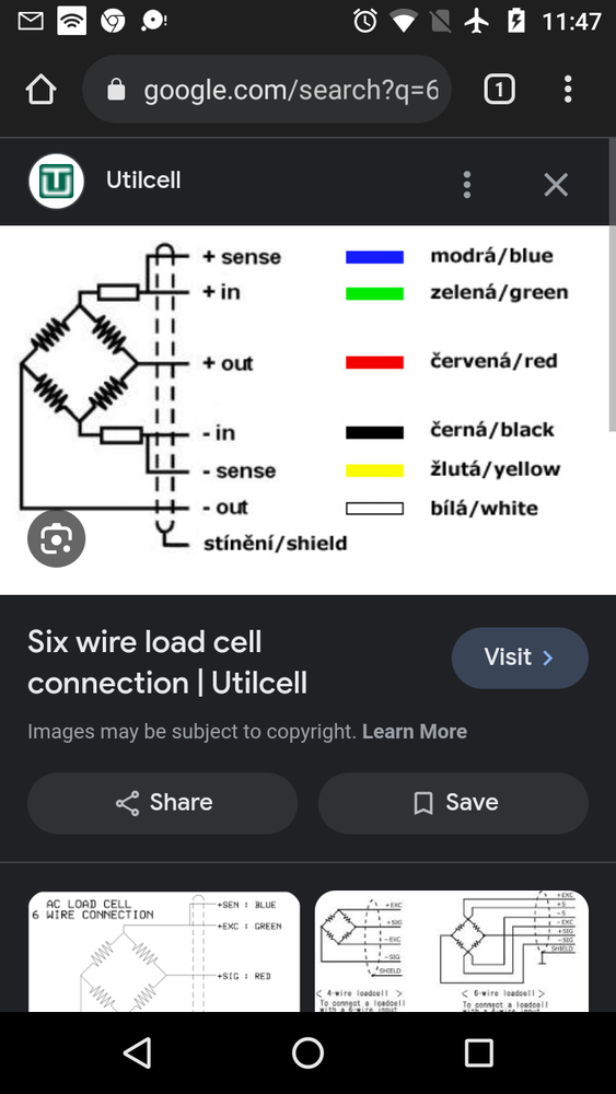

The load cell is this and has 6-wires plus screen:

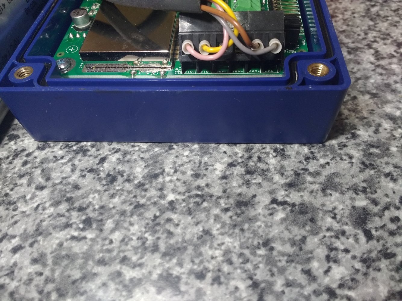

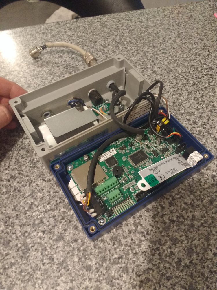

I've looked inside the control box and wired it thus:
Pin 1 - Exct + Green
Pin 2 - Exct - White
Pin 3 - Screen
Pin 4 - Sign + Red
Pin 5 - Sign - Black
I've not connected the blue and yellow from the load cell.

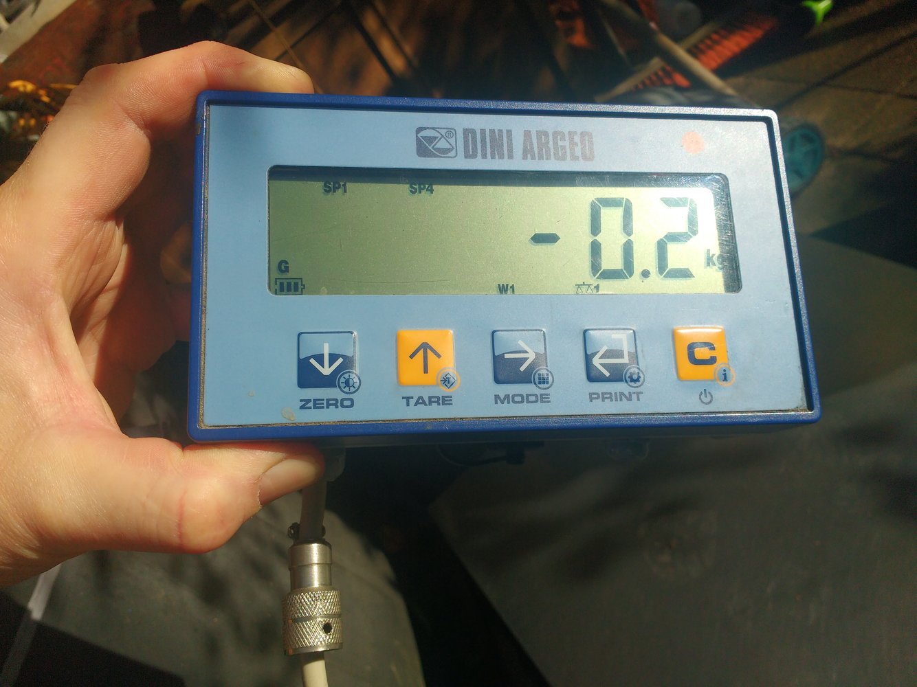

Plugging the load cell into the display and I can zero the unit OK.
Putting any weight on the scale though and it throws a hissy fit. A warbling siren sounds and the screen flashes "under'.
Anyone any experience of these?
Cheers.

Whoops! Just corrected my post. The green, white, red, black & screen are connected.
