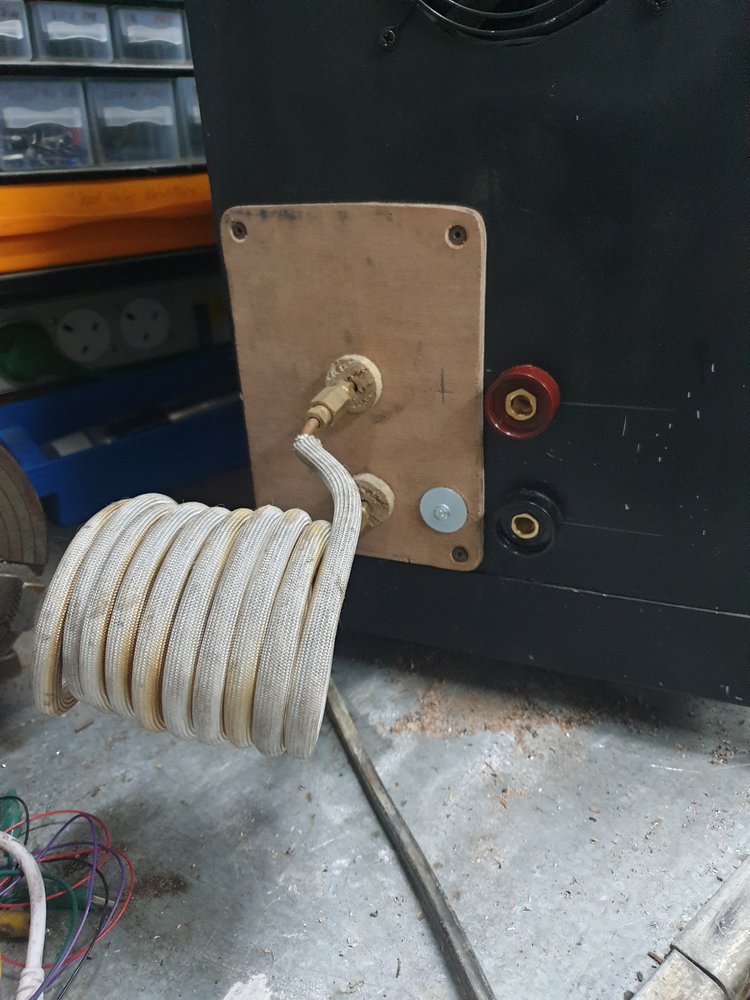

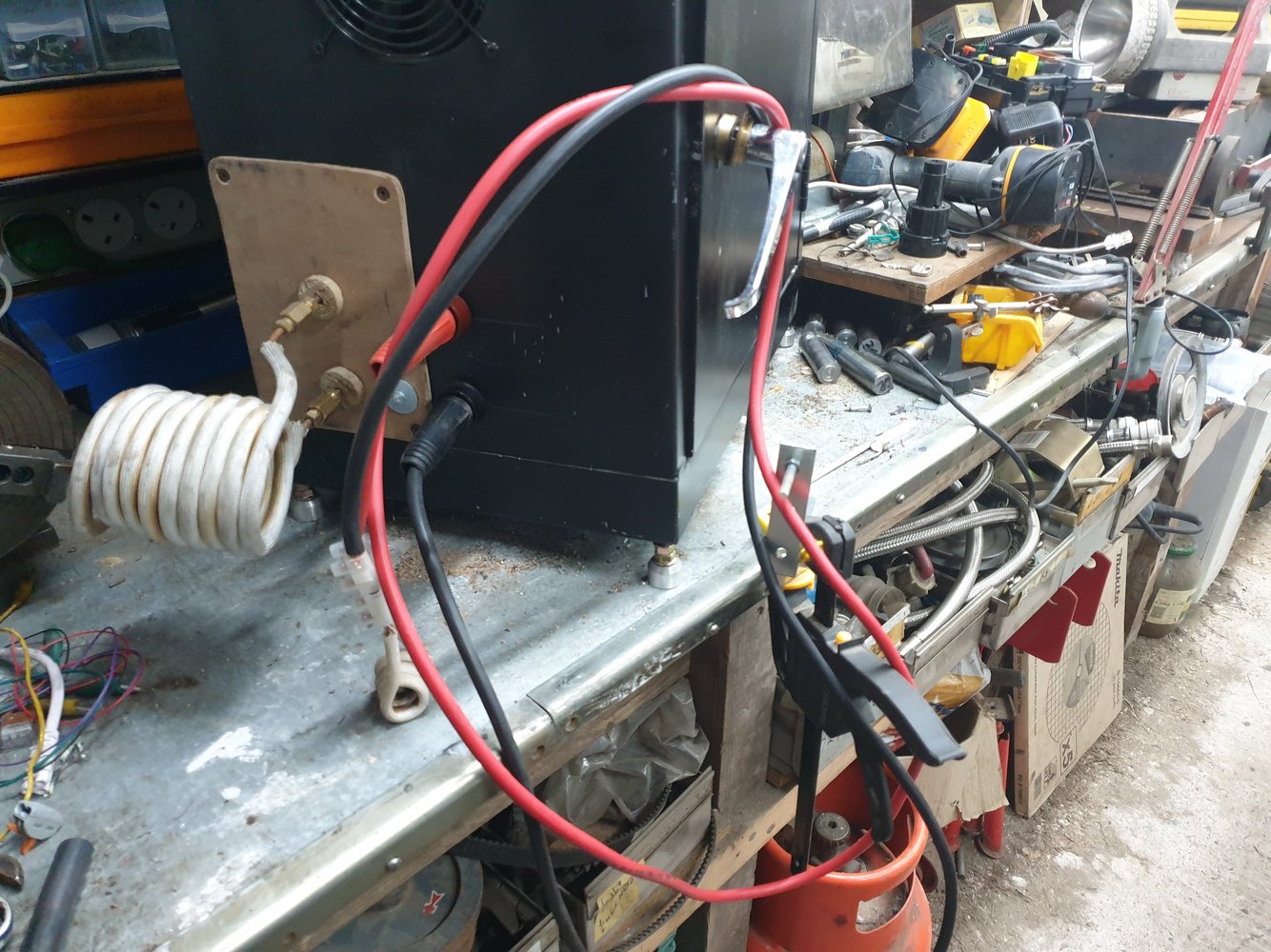

I got an alloy single cylinder motor bike head on the bench at the moment - want to get two studs out of it - both are snapped but protruding - I been patient with it - been heat cycling them/soaking them up - have TIG welded two M8 nuts to what is left of them with 312. They tight...
Been persevering with heat cycles and penatrating fluid - because the other option gonna be drilling on a mill - and this is gonna involve a temp wooden cradle to jury rig the fragile thing at the angle I want on the table.
