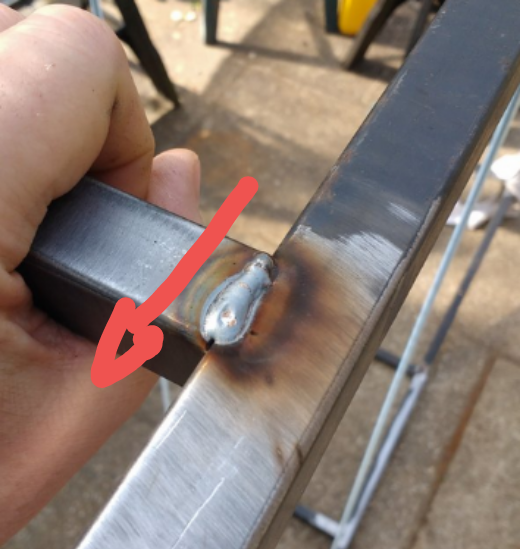

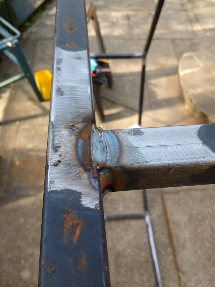

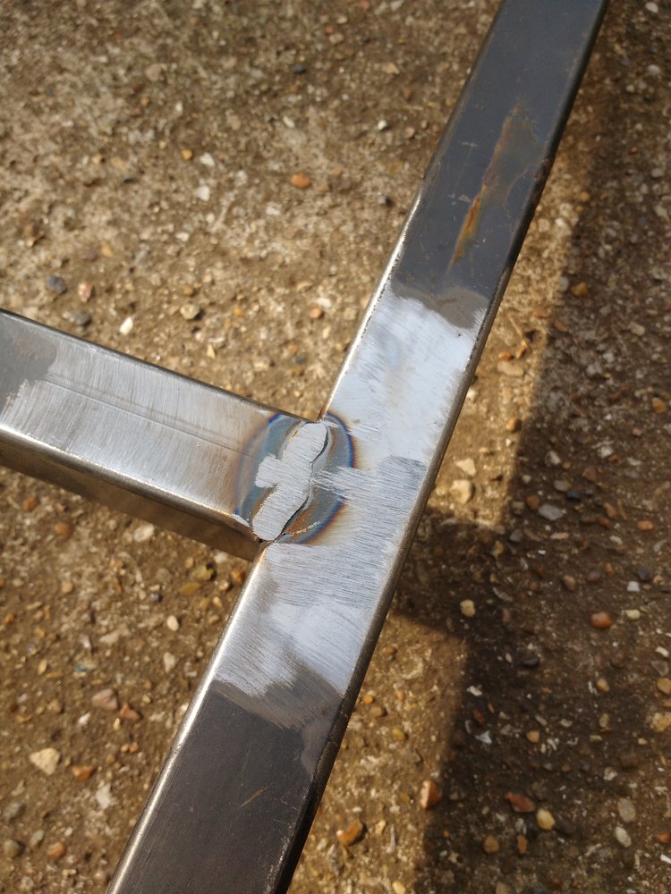

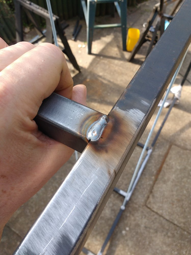

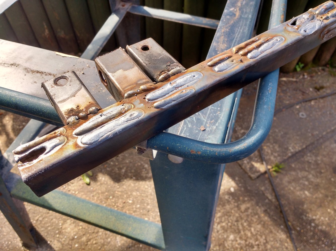

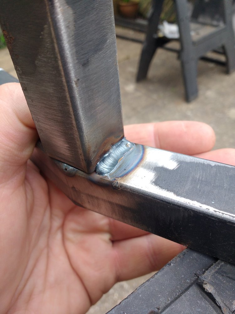

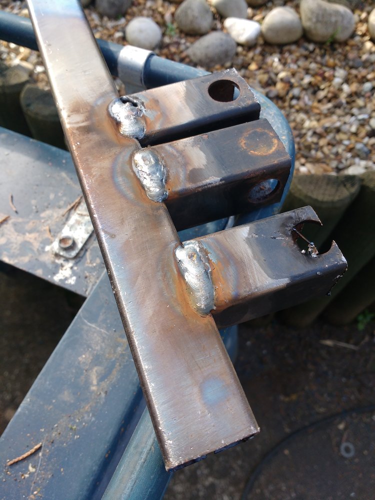

set 3 from left 1 and 3 strips are your best
try a different angle before you change settings again sometimes direct to the weld is putting in too much heat therefopre melts the steel your welding up
A 2 lower your speed to 4 or 4.5
also again change your angle that your welding at
what thickness are you welding ?
as it looks thinner then 3mm box section
Thanks, good tips. The box is 2mm thick.
