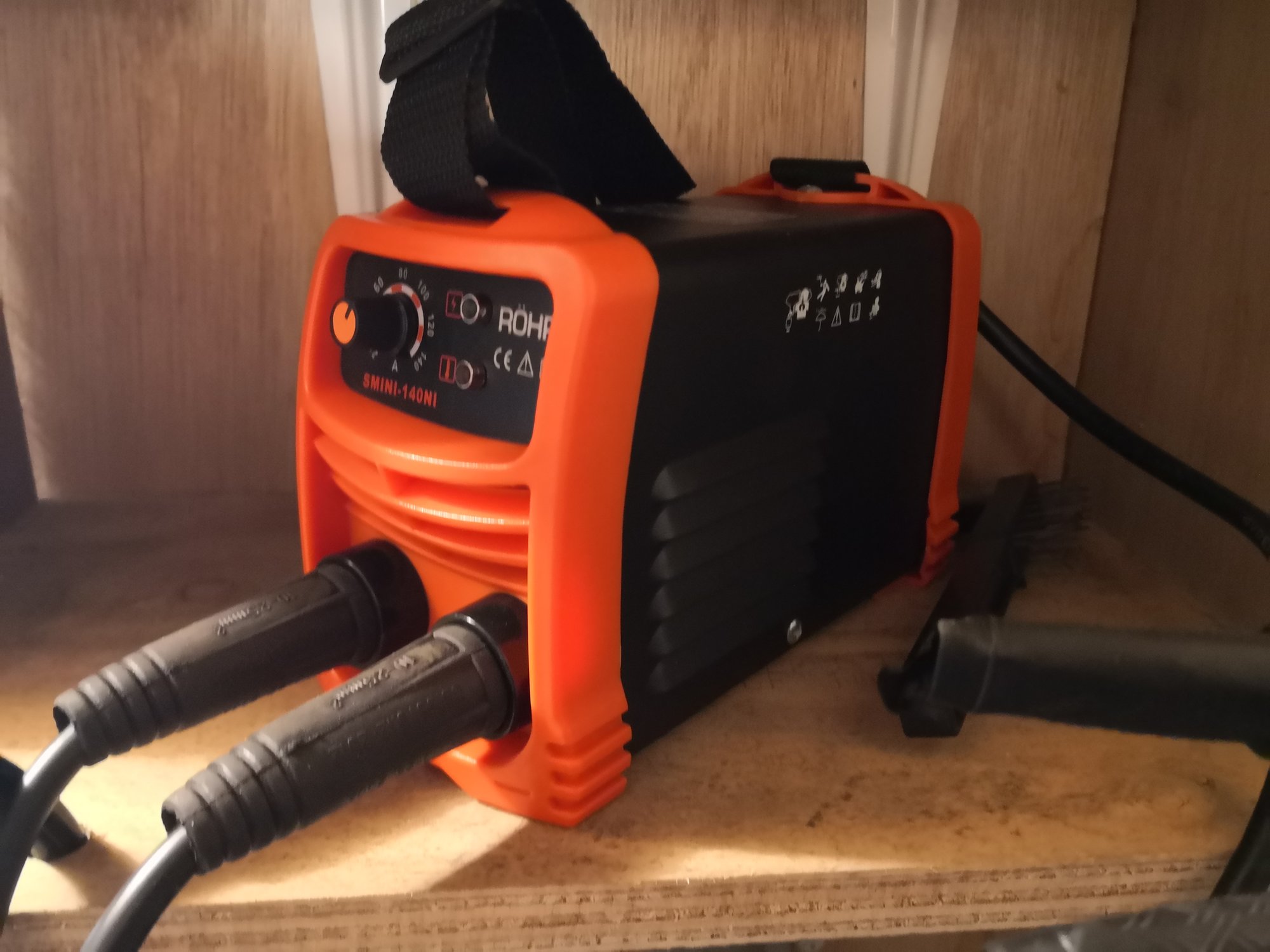

Good stuff, im going to buy one of the mig/mma machines to have a portable machine

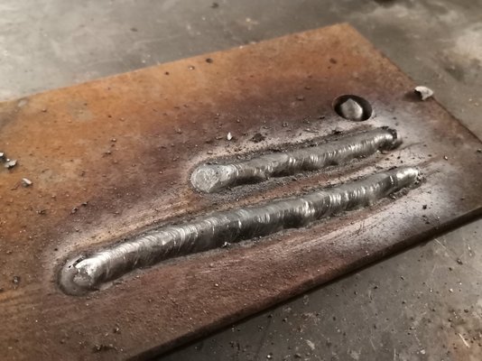

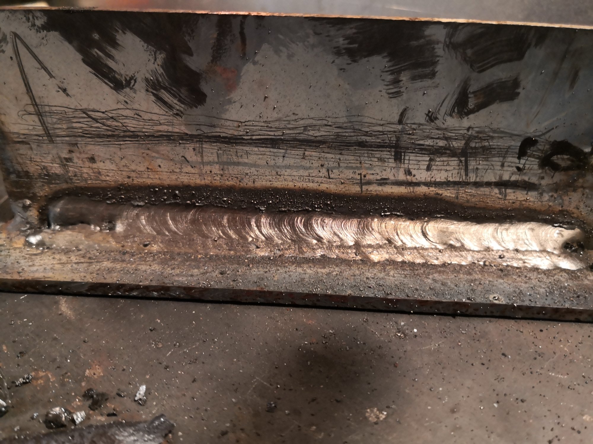

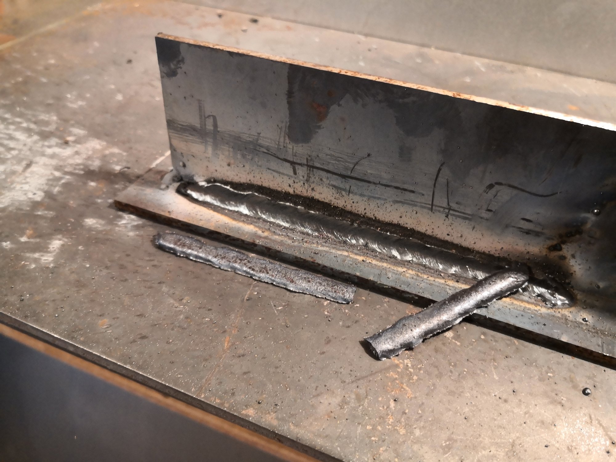

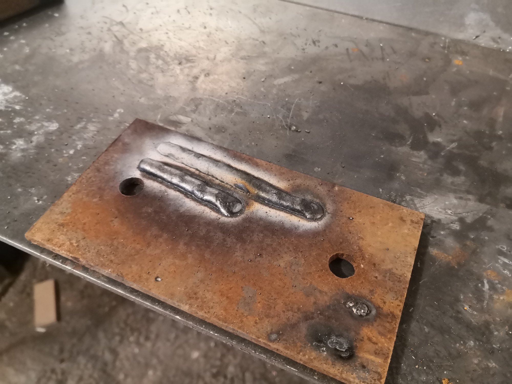

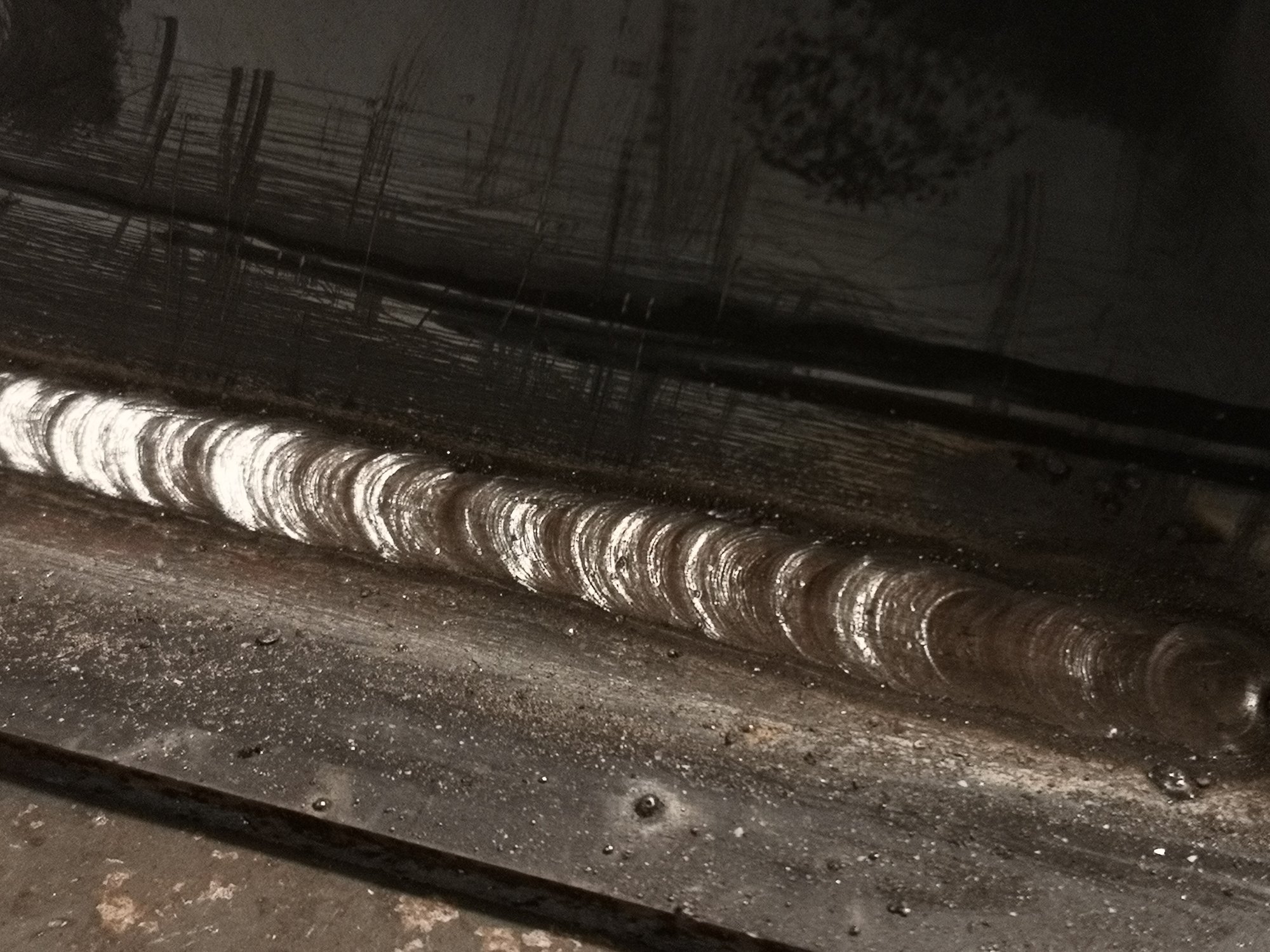

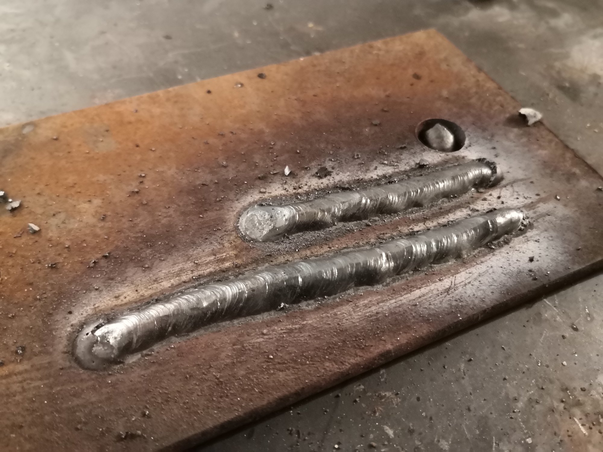

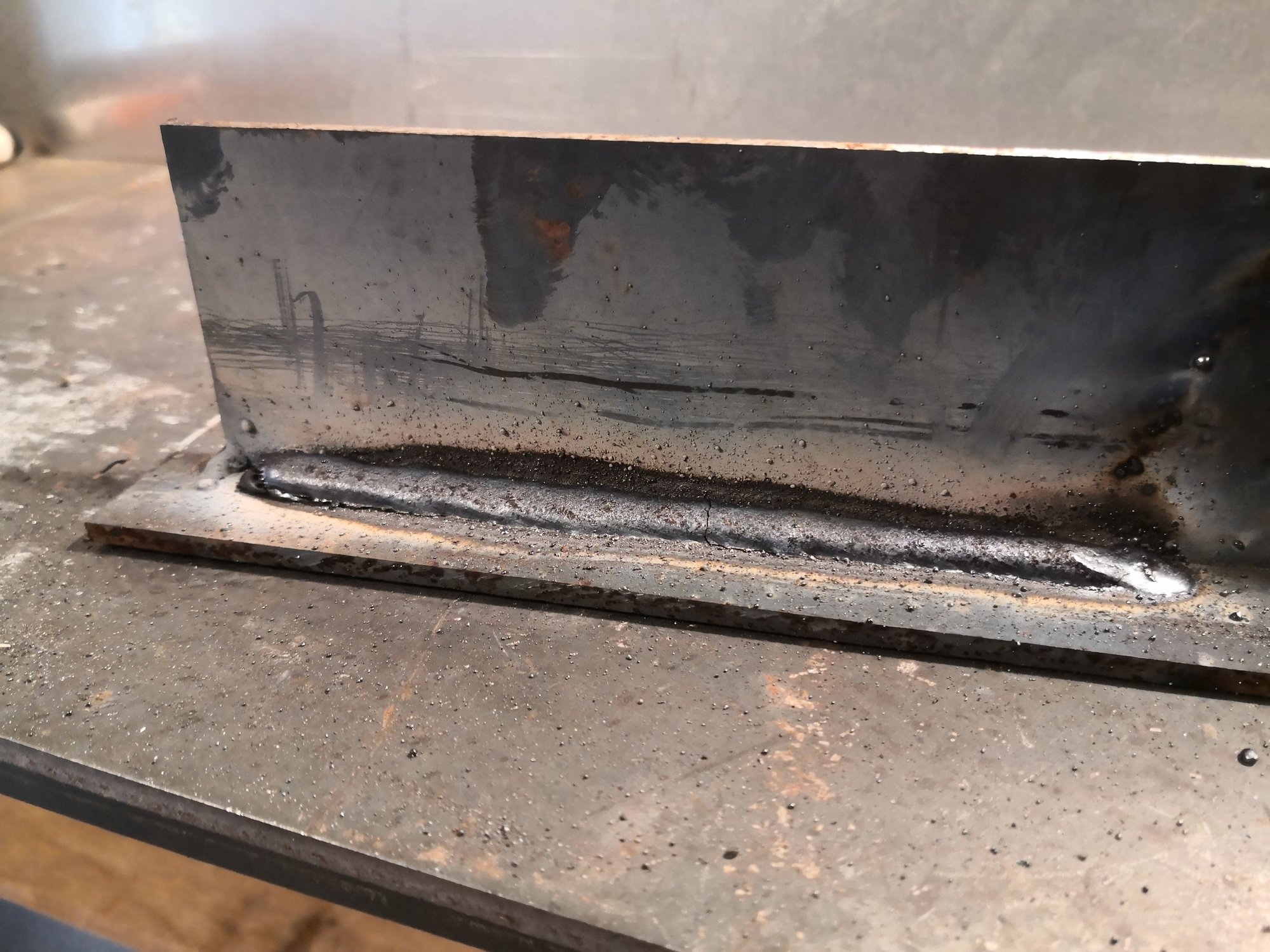

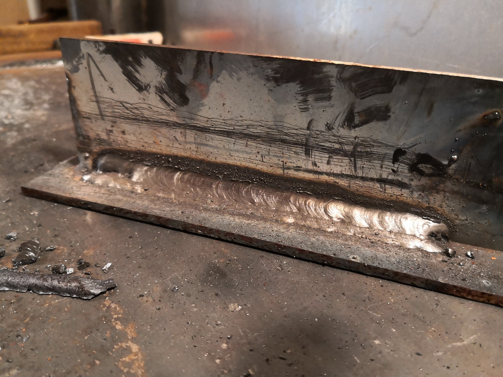

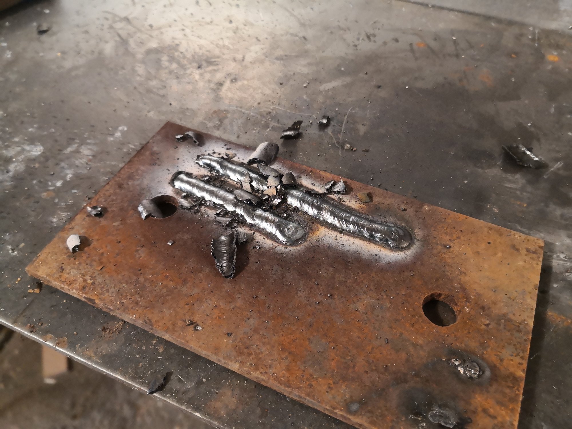

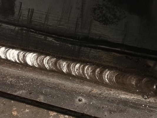

@spaffmonkey do you use use dcep or dcen. I usually use my r tech mig for MBA which I run dcep no problem of siftrode 6013 rods. I finally got to use this little machine a few weeks back and couldn't get on with it, simple t joint but arc violent, wandering alot and weld pool would mostly only use to one side of the joint, packed it up and used my other machine, had a spare bit of time today to have a look at it again, I swapped the leads and ran it dcen and its lovely now, smooth arc and everything seems more controlled and slowed down
Used my welder again today but had the earth clamp clipped on the metal workbench and the weld quality was dreadful. Moved the earth clamp onto the work piece and you would of thought it was a completely different machine.
