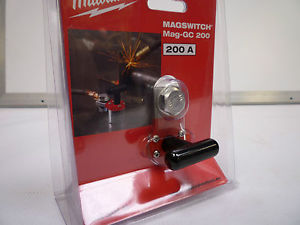

My first bit of advice would be to get a good earth clamp, a good earth clamp IS NOT one of the oversized crocodile clips which come with cheaper welders as usually one pointed tooth is making contact and earthing the full current and begins glowing red hot. A good earth clamp is one with a braided copper strap across both sides of the earth clamp with copper contact pieces on both sides of the clamp, it is NOT reliant on the pivot pin to carry the current to both sides of the clamp, and it needs a high spring pressure to make a good contact with the job.
