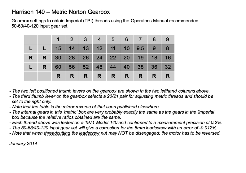

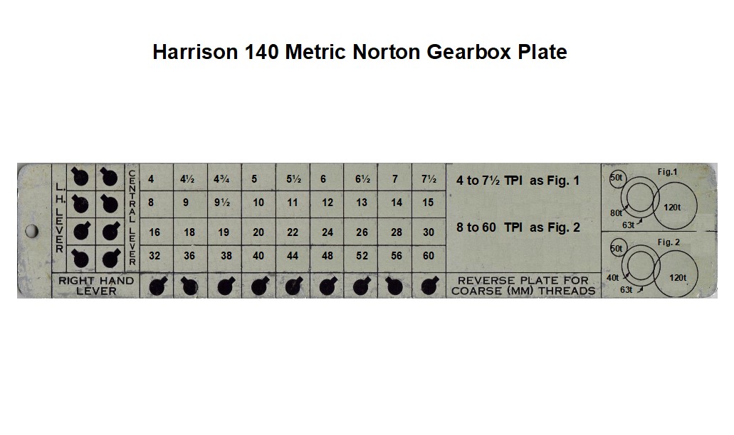

If the graph is to be believed, that has come off the L5 with a two lever norton box. Then I can go 50, 40-60, 127 and get the majority of pitches.
You can't Brad. That chart is for a imperial lathe to convert to metric threads. You have a metric lathe you wnt to cut imperial threads. the conversion is not reversible. Metric to imperial is less straightforward.
