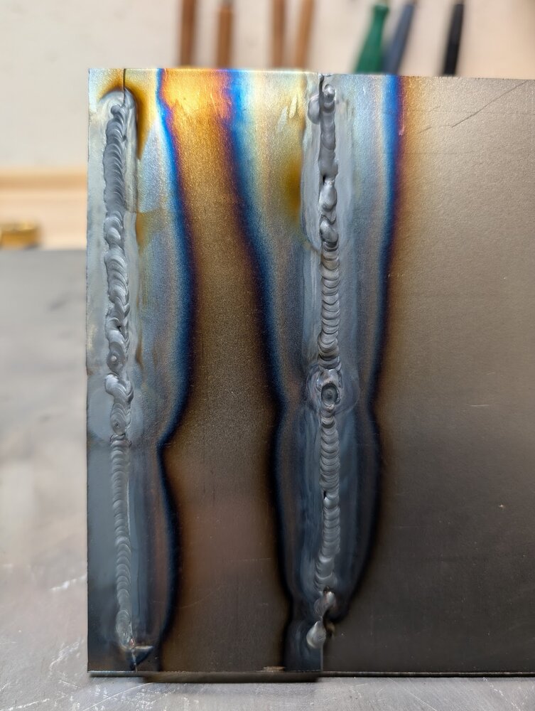

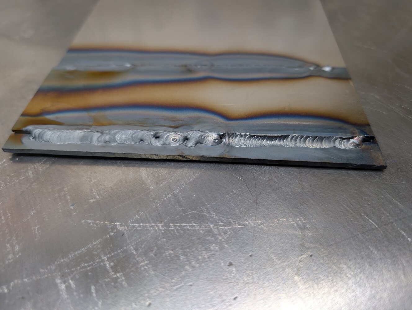

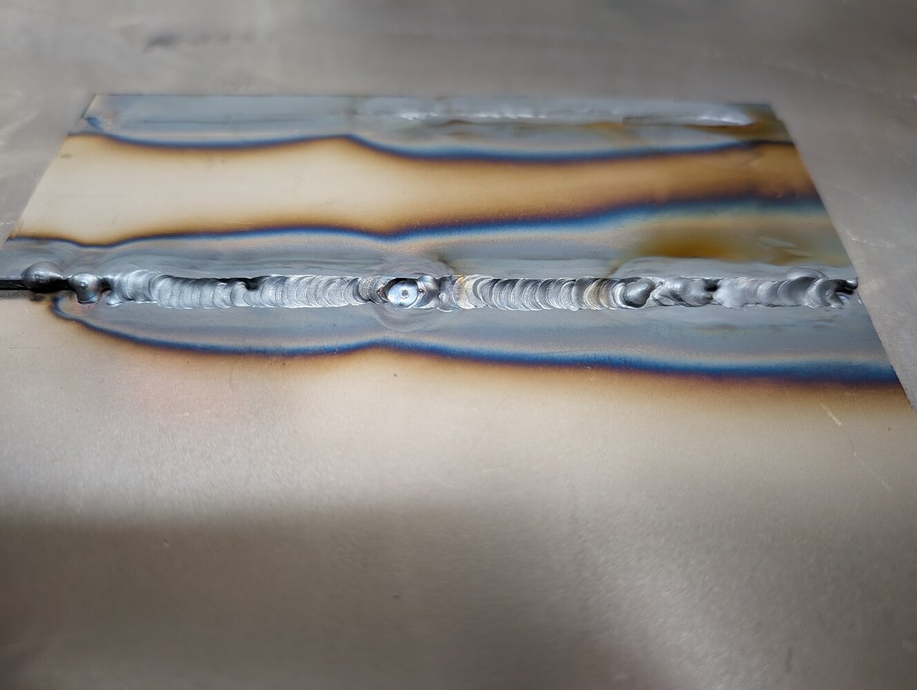

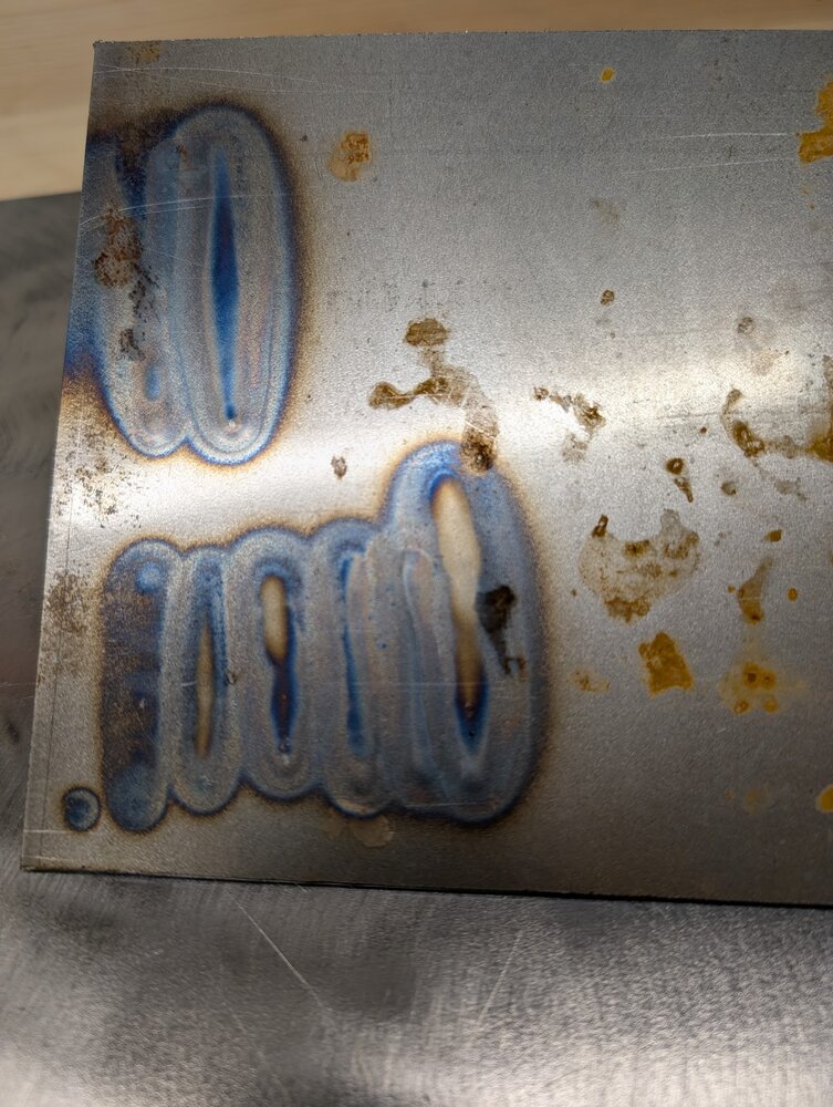

Yeah i did wander a bit in places, might need to play with shade settings for a better view as i dont really see it in 4knot looking too bad, arc length might be a tad long in places but overall looks like you are making progress
More light on the weld area will help. Something like a floodlight about 1 metre away, should help. A 500W halogen, or 50W LED floodlight. Even a bright head torch stuck to the welding helmet can help.Yeah i did wander a bit in places, might need to play with shade settings for a better view as i dont really see it in 4k
I do have a couple of powerful work lights, ill bung one on a tripod and see if it helps, cheers for the tipMore light on the weld area will help. Something like a floodlight about 1 metre away, should help. A 500W halogen, or 50W LED floodlight. Even a bright head torch stuck to the welding helmet can help.
i have a 100 watt halogen lamp on my welding bench that is invaluableI do have a couple of powerful work lights, ill bung one on a tripod and see if it helps, cheers for the tip![]()
i bet you have a lovely tan! im not sure what i have.....checkingi have a 100 watt halogen lamp on my welding bench that is invaluable
I wish...spend more time sweating from wearing a hoody or welding coat than getting a tani bet you have a lovely tan! im not sure what i have.....checking
these things https://unilite.co.uk/product/slr-1750/
im guessing that will be ok close up as they are pretty bright

This is good advice. I find I get best results if I can rest my forearms on something. Helps keep things steady.regarding your welds, are you hoovering above the plate, if you are try resting the ceramic lightly on the metal, get the angles all correct before you start, have a dry run to see how you are going to move your wrist hand as you move along the plates, it might help, well its one less thing to think about if your ceramic is steady.
sadly not, I sit at the bench, i do find it tricky getting a good angle though, ill do some experimenting tomorrow. I do rest my arms now after realising i wont electrocute myselfregarding your welds, are you hoovering above the plate, if you are try resting the ceramic lightly on the metal, get the angles all correct before you start, have a dry run to see how you are going to move your wrist hand as you move along the plates, it might help, well its one less thing to think about if your ceramic is steady.
I am glad your not hoovering!!!! hovering, you'll get there in time, your off to a decent start.sadly not, I sit at the bench, i do find it tricky getting a good angle though, ill do some experimenting tomorrow. I do rest my arms now after realising i wont electrocute myself![]()
I didn't even think about resting the ceramic, I'll give that a go today, might improve arc length.I am glad your not hoovering!!!! hovering, you'll get there in time, your off to a decent start.
