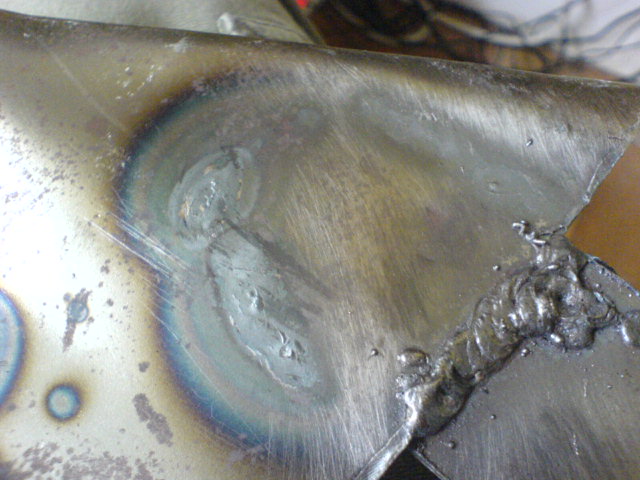

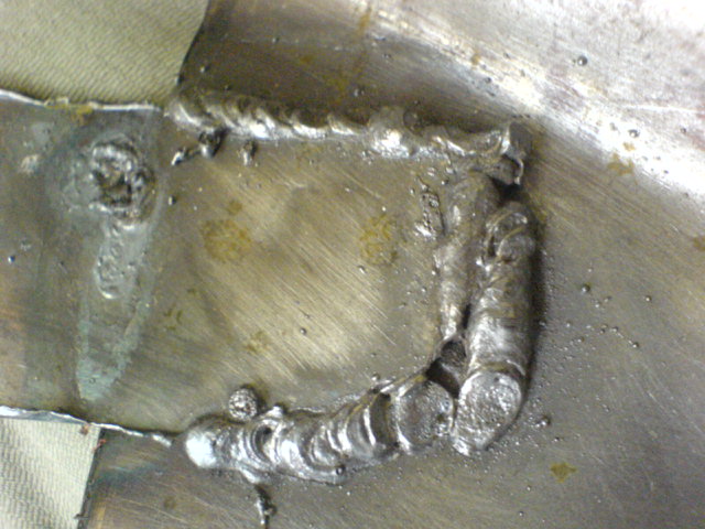

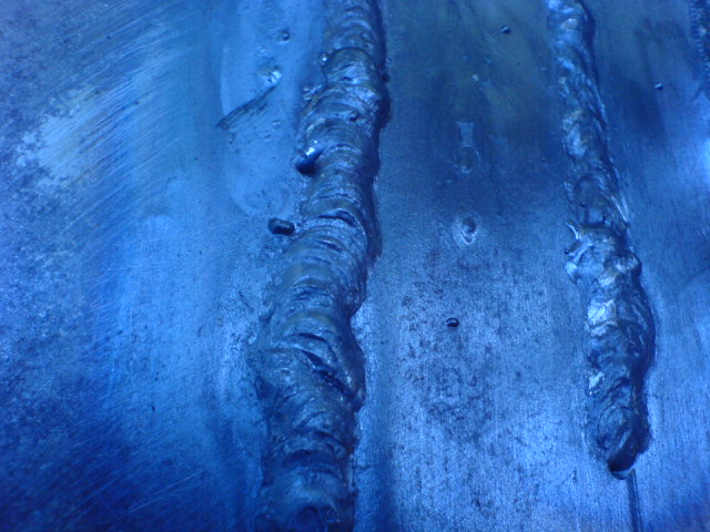

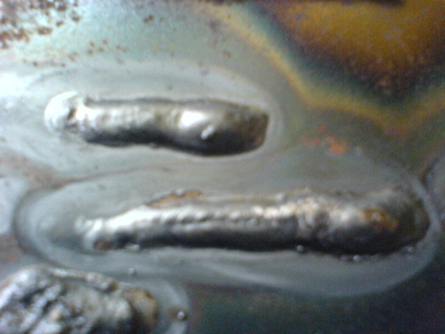

well only managed to get a few bits done on saturday.. I was figuring out how the pervious owner managed to get .8mm wire through a .6mm tip

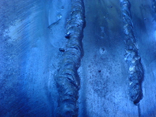

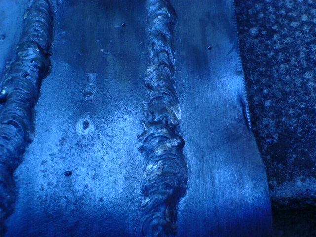

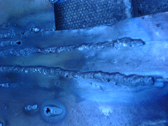

so changed the tip for a new one and carried on with a new roll of .6mm wire. The current was set too high to begin with and I was also using .8 wire on 1mm sheet

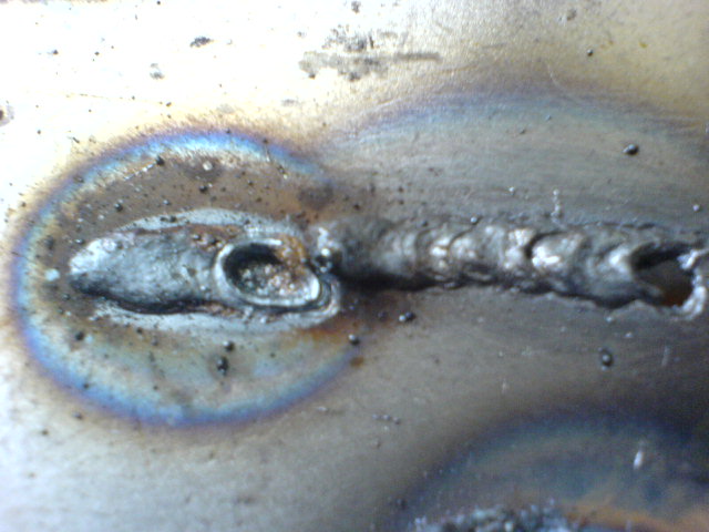

there were more holes that weld
the lap joint was with .6mm wire on the lowest setting...might bump it up a bit because the penetration's only just showing.
anyway here's the pics
