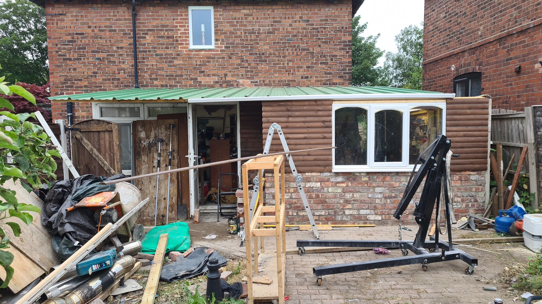

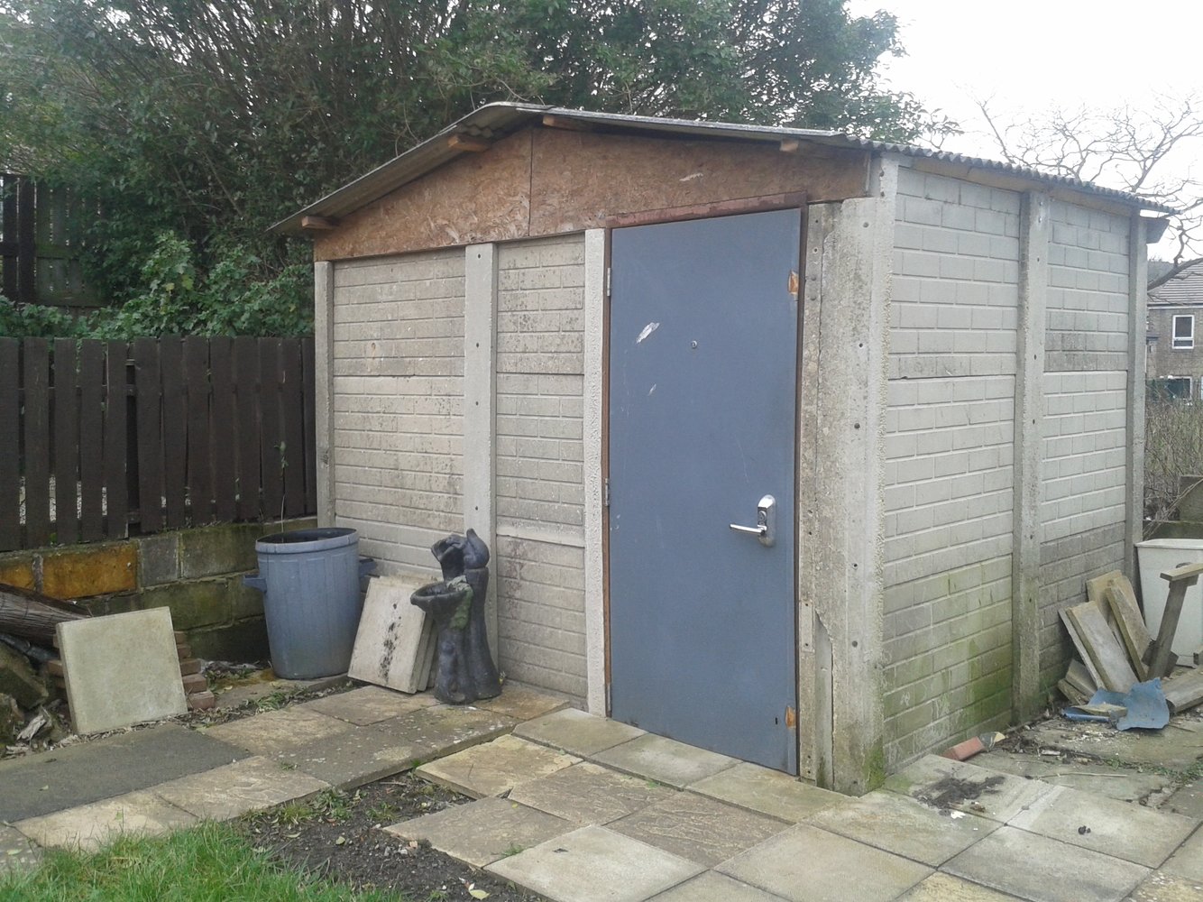

I've been giving this a bit more thought...
I've come to the conclusion that I may as well replace the roof, rather than covering it in some sort of paint. The quickest and cheapest method will most likely be steel/plastisol sheets. Cost of tile effect sheets is around £30 for a 3m length, so about £150 for 15m, plus delivery and fixings etc.
Now what are the nuances about fitting these sheets, or things to be aware of?
There are a few things I'm not sure about:
1. The sheets are available with a plastisol or polyester coating. What's the difference?
2. They come in 0.5mm and 0.7mm thick. Is there a distinct benefit in going with 0.7mm?
3. The construction of the garage is that the back and front ends have a timber wall plate, with a central timber beam that runs horizontally. The roof sheets are fixed to these 3 points. Is this sufficient for steel sheets? At what point do I need to install z purlins?
4. Being a single pitch roof, the back end is higher than the front. The wall plate won't be at the same angle as the roof sheet, although the central horizontal beam is. Logically thinking, screwing through it into the wood will deform the sheet. How best can I get around this?
5. What do I do about the sides? As it is a cold roof, the high and low sides will be left open to allow for ventilation. What about the left and right sides? The left side of the roof butts up against a parapet wall.
6. What do I do if I find that the final sheet has too much overhang? Or is too short? If I cut the sheet it won't be protected by the plastic coating.
7. How long do the screws/fixings last before they perish and start letting water through?
8. It appears that insulated sheets are available for double the price, bearing in mind I already have a layer of insulation under the roof, is it worth going for that?

The Cromapol probably didn't take properly as the sheets were dirty with loose, organic matter and degraded asbestos surface. Brushing off the crap beforehand probably wasn't enough.
Not sure though if jet washing an asbestos roof is a good idea? OK the water would keep the fibres down initially but would it just distribute them over a wider area to contaminate the environment over a wider area?
Ok here goes….
1. Plastisol is thicker and more durable, polyester is basically a thin coating of paint. It’s perfectly fine but is more prone to getting scratched etc.
2. Over a short length and unless you’re going to walk on it probably not.
3. you definitely don’t need Z purlins! The front and rear need to be fixed properly and I’d want a single row of intermediate fixings if possible.
4. Ideally you would add an angled length of timber to the wall plate but as long as you don’t over tighten the fixings it will be fine.
5. The side abutting the wall will require a flashing. The other side should be fastened tight against the wall plate.
6. The sheets are cut anyway and will have bare edges.
7. Longer than the sheets!
8. Not really IMO.
Hope that helps!

For sure. There's nothing wrong with Profile Sheet Roofs (Wriggly Tin(Glassfibre Roof) Seems like a lot more cost and effort than going with steel sheets.
I would just use an epoxy paint. It should last 10 years at least if done right and much easier.
Used on oil rigs and cargo vessels etc.
Can be brush applied.
It will seal the asbestos totally.
For sure. There's nothing wrong with Profile Sheet Roofs (Wriggly Tin) at all. All I was suggesting was that a GF roof was durable and effective. It also looks better and might be said to offer a more insulating (in terms of heat and noise transmission, condensation etc) roof than a Wriggly Tin job.
You could of course go for the Insulated Profile Sheets (or add Kingspan or similar) - but then you are seriously eroding the cost benefits of a Tin Roof.
I already have multifoil insulation. There's little benefit to be gained, especially if the garage gets ripped down in the next 10 years. I've decided i'd rather put up with the looks of steel sheets than invest more time and money into something that I don't want to invest in.
just so you know its better to jack the roof sheeys higher otherwise the material rots from underneathI'm building a shed and putting a sheet metal roof on it, will be uninsulated so condensation might become an issue. If I got my english terms right, I will put a condensation membrane between the rafter and the purlin. That will create a small area between the sheet metal roof and the sheet. Condensation can drip down on this sheet and them runs freely out the sides of the roof and into the gutter. Very simple to add when you build the roof new. Air will also be able to circulate freely inside here and the roof will be vented at the top. This design works for a roof with a big enough slope, not sure if it's applicable to your roof.
