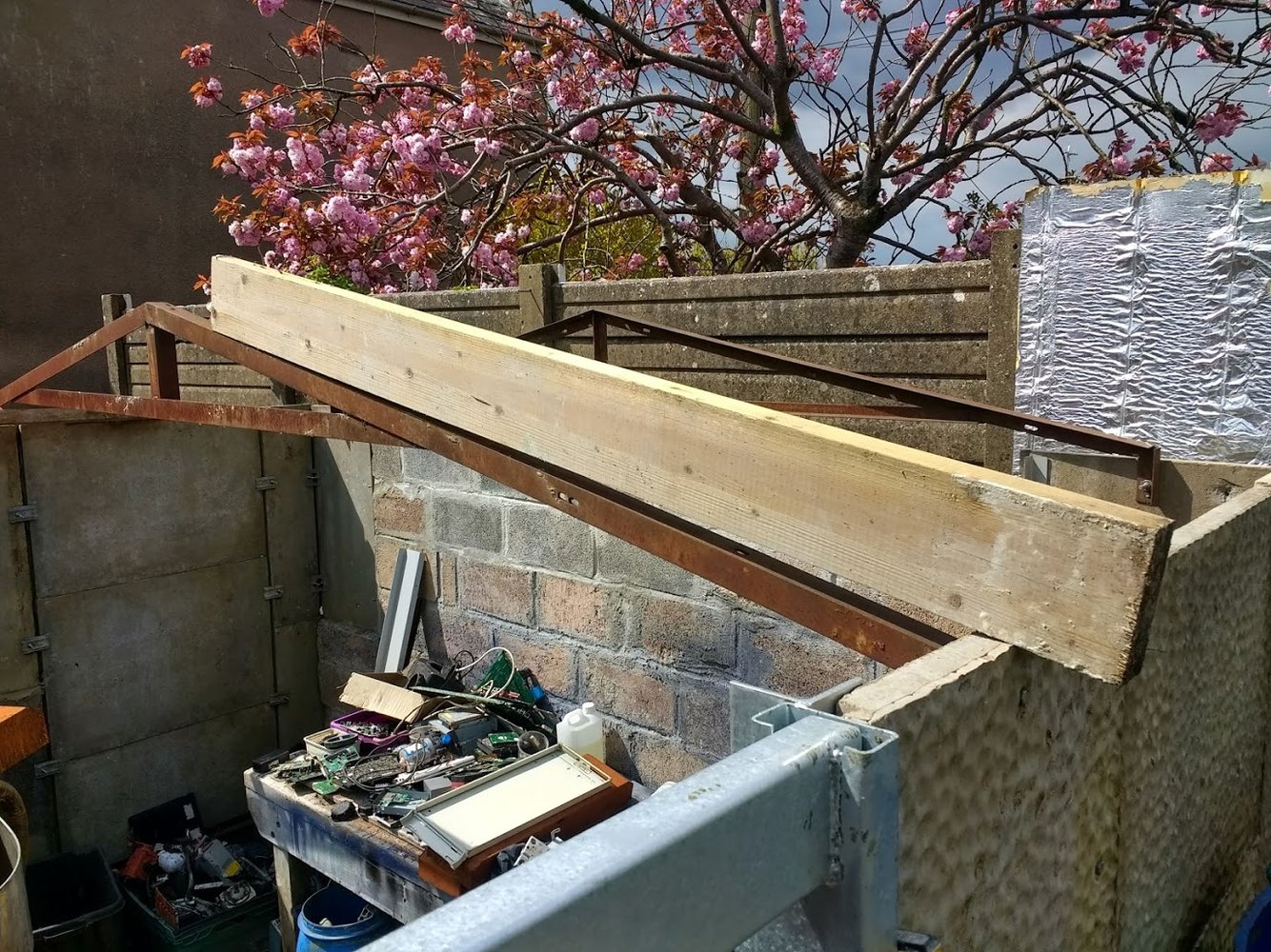

If that was mine I'd be inclined to do away with the steel completely.
Internal 2x4 studwork all the way around. Insulated and boarded and will support the josts.
Joists across the short run and firrings for a fall
