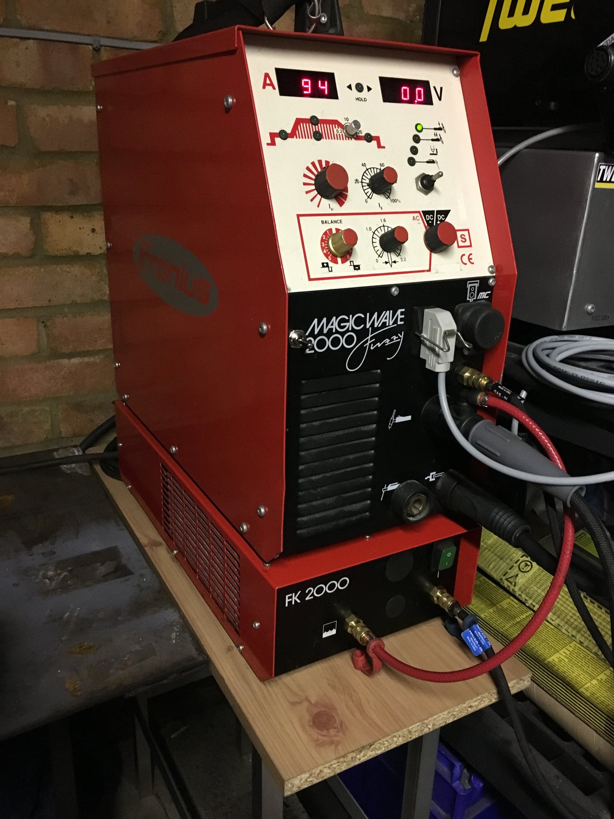

I hope it’s working as it should.I've got a manual in electronic format which I'll print out. First thing is to do some basic tests to make sure the machine is working properly. Back home later and I'll have a good look over it and take the cooler off, make it more portable
It’s only splats on 2mm plate but the unit produces quality splats.
Come and participate in one of my 4 hour tuition sessions and you’ll be splatting to that standard in an hour. Ask @hooblahI would say that is understatment of the year so far!
I would be splatting weld even on stuff that didn't need it if I had that level of skill

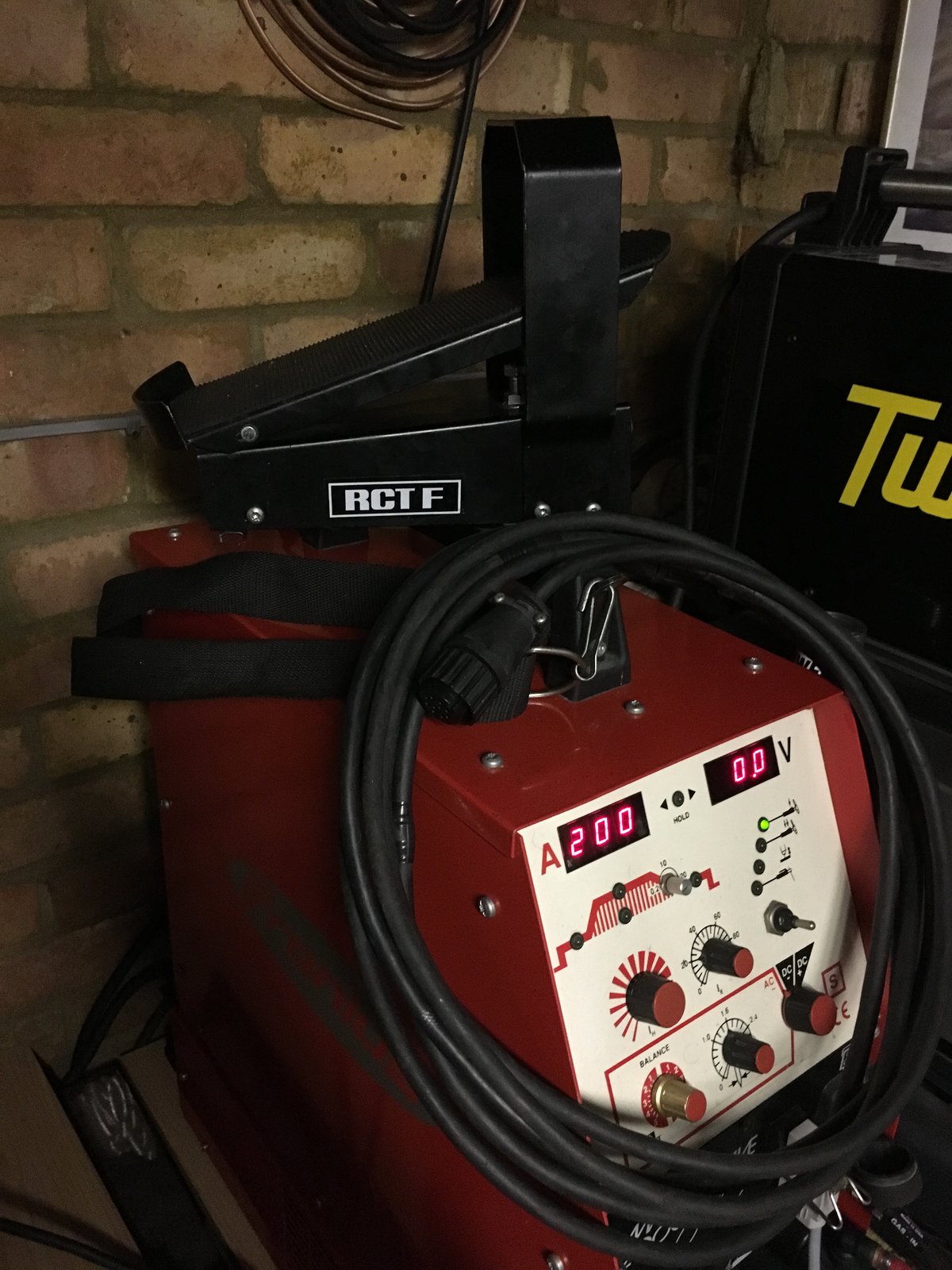

Glad he has got it up and running and it works good... I found the user manual and pointed him at the correct pinouts on the connector, he took care of everything else.Yes I did.
Nice machine. Big but light.
He did a good job of getting that pedal to work with it too. I believe you helped him with that.
If the pedal is at the right price kai I’d take it mate. It has got to be the tr52/RCTF. The tr2200 doesn’t work with the older machines. Pm me a price door to door to considerHi,

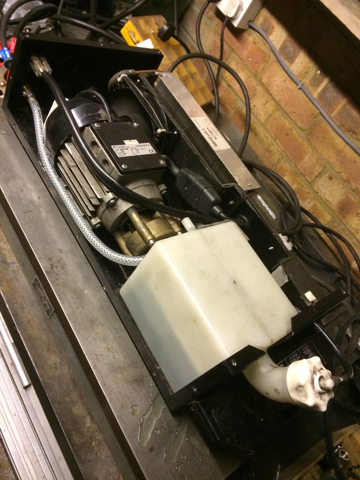

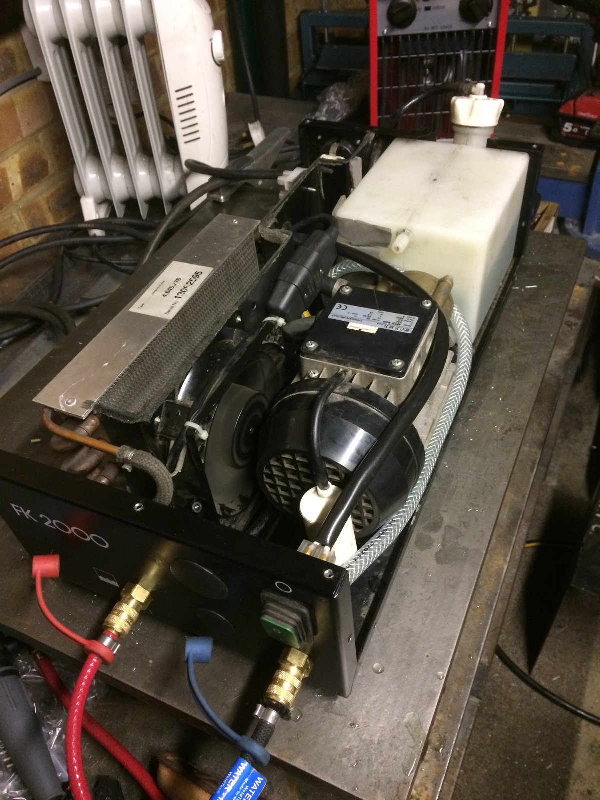

Few little complications but should be kicking out fluid by weekend.How's that cooler rebuild working out mate![]()
Yes it uses a cymbals design accumulator. They are incredibly effective at taking pulses out of the lines. However if they are not working that pump has a mind of its own and shakes the thing to pieces. It’s surging and vibrating like mad. No good. I’m gonna change it quite a bit to suit.Ah, it uses a set of bronze metal diaphragms back-to-back for an expansion vessel? Interesting.
