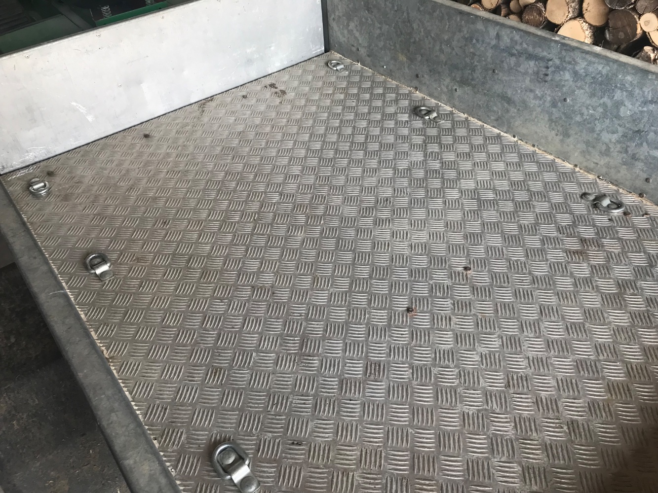

Thats still 1200kg and you know full well for lifting everything has much higher safety margins but thanks for checking.Rummaging through my company standards, some shouldered eyebolt suppliers do suggest you can side load - but the de-rating is considerable. 45 deg from vertical and you are at 30% of the SWL. Just be careful.
Not safe for side loading.
skylandequipment.com
Nope, those neither.
Would love to see that explained standing in front of a judge afterNon commercial and a very old trailer...

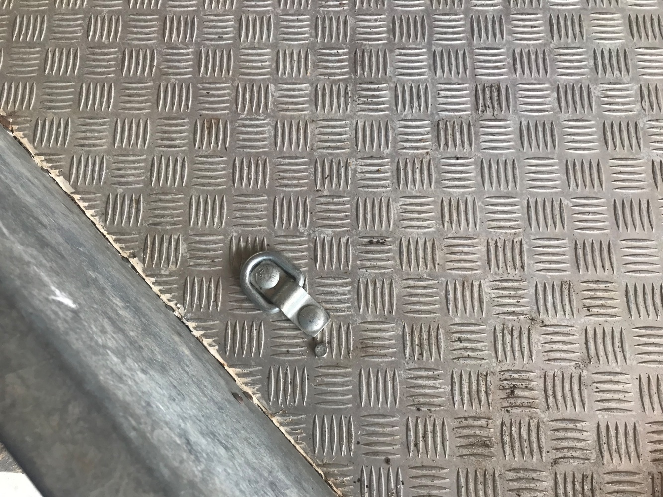

It reminds me of when the ambulance men refused to carry my wife in her wheelchair as the lashing points weren't properly marked. They supplied her with a new wheelchair. Instead of welded on lashing points they were screwed on. With an m5 screw with a standard pozi head. Didn't even have a washer. Ahh but these are approvedWould love to see that explained standing in front of a judge after
they broke, and spilled the load on the highway, causing a wreck/crash ...![]()
