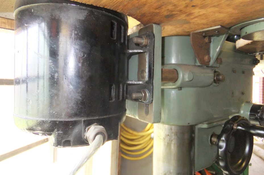

View of the 3-phase motor and its mount:

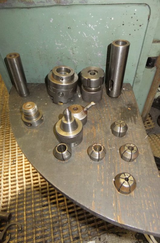

Tooling storage inside the lower cabinet door (fly cutter and centring device in the niddle, 2MT spindle at rear right, various Imperial ER collets):

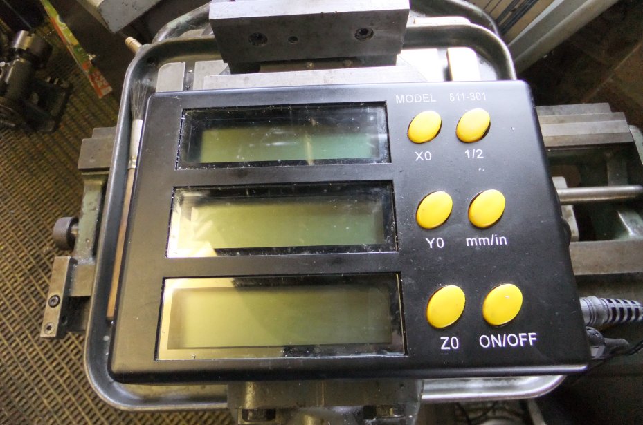

I fitted linear scales to the X-Y table but haven't yet worked out how to install the third one on the quill, here's the DRO for them... the X-Y table nuts are not wear-adjustable so the DRO lets you ignore a bit of backlash here and there
