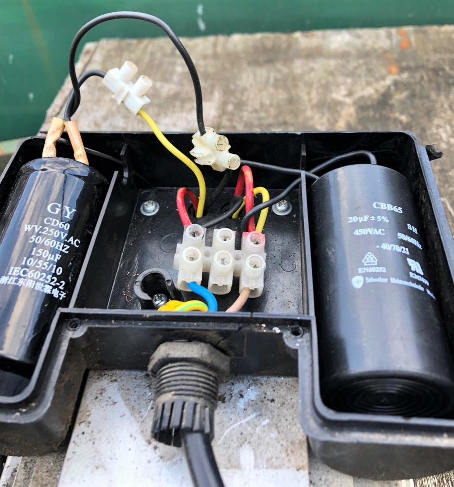

Thankfully I was aware of this and happy to have earthed the start cap before disconnecting, it produced a blue spark like a motor spark plug and a loud crack like a stick breaking.@Bsmith be careful with those capacitors unless you are absolutely certain they hold no charge. They can be lethal.
My mistake, apologies, last time when getting no reading I was testing the run windings with the capacitor connected.I know but in the pic above the red winding is showing 2.6ohms so I figured that 'no resistance" meant no reading.

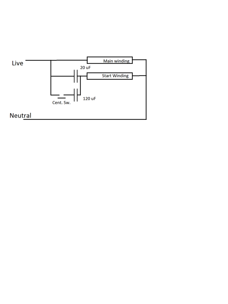

Nope, the start winding needs to be connected through the run cap (20uF), AND through the centrifugal switch and start cap (150uF) - otherwise it'd only have a single cap in it...That motor has been wired up for being reversible.
If you don't need to reverse it cut all of the connections, identify the two windings and connect it as per 6ply's diagram. If it turns the wrong way reverse the start winding wires.
Both caps ------> start windings?Nope, the start winding needs to be connected through the run cap (20uF), AND through the centrifugal switch and start cap (150uF) - otherwise it'd only have a single cap in it...
yep the windings should be almost a short, if you can spin the motor shaft quickly the centrifugal switch will open - go from short to open circuit (wrap a piece of cord around the shaft and give a mighty yank on it?)
If you need it to reverse, swap both leads to ONE of the windings - the 3-pole drum switch is a good'un for this
That's interesting, and I'm happy to be corrected. If that turns out to be correct, the "start" winding will really be an auxiliary winding which also serves as a start winding. I've had a look online and that setup appears to be common.Nope, the start winding needs to be connected through the run cap (20uF), AND through the centrifugal switch and start cap (150uF) - otherwise it'd only have a single cap in it...

Current will be the same, before and after the capacitor.Ok if I was wanting to reverse the rotation it would be a case of swap the wires over on the start windings as I don't see it making any difference swapping the Live and neutral on the run windings? Maybe it does though?
Think I would put the centri switch inline before the start cap as less current would be going through the little contacts then.
