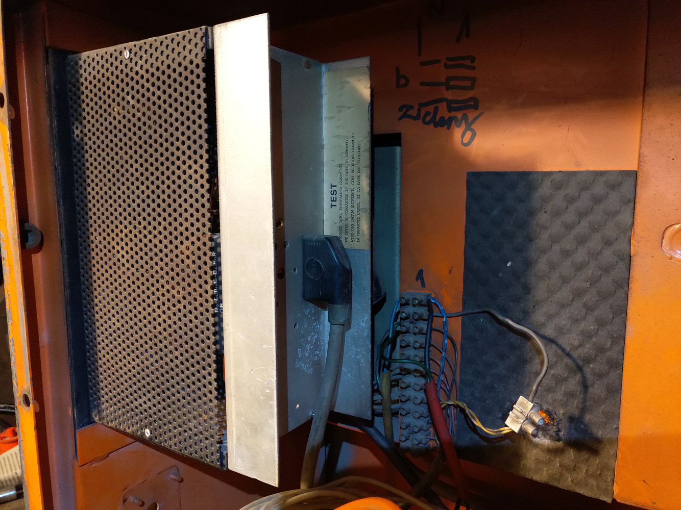

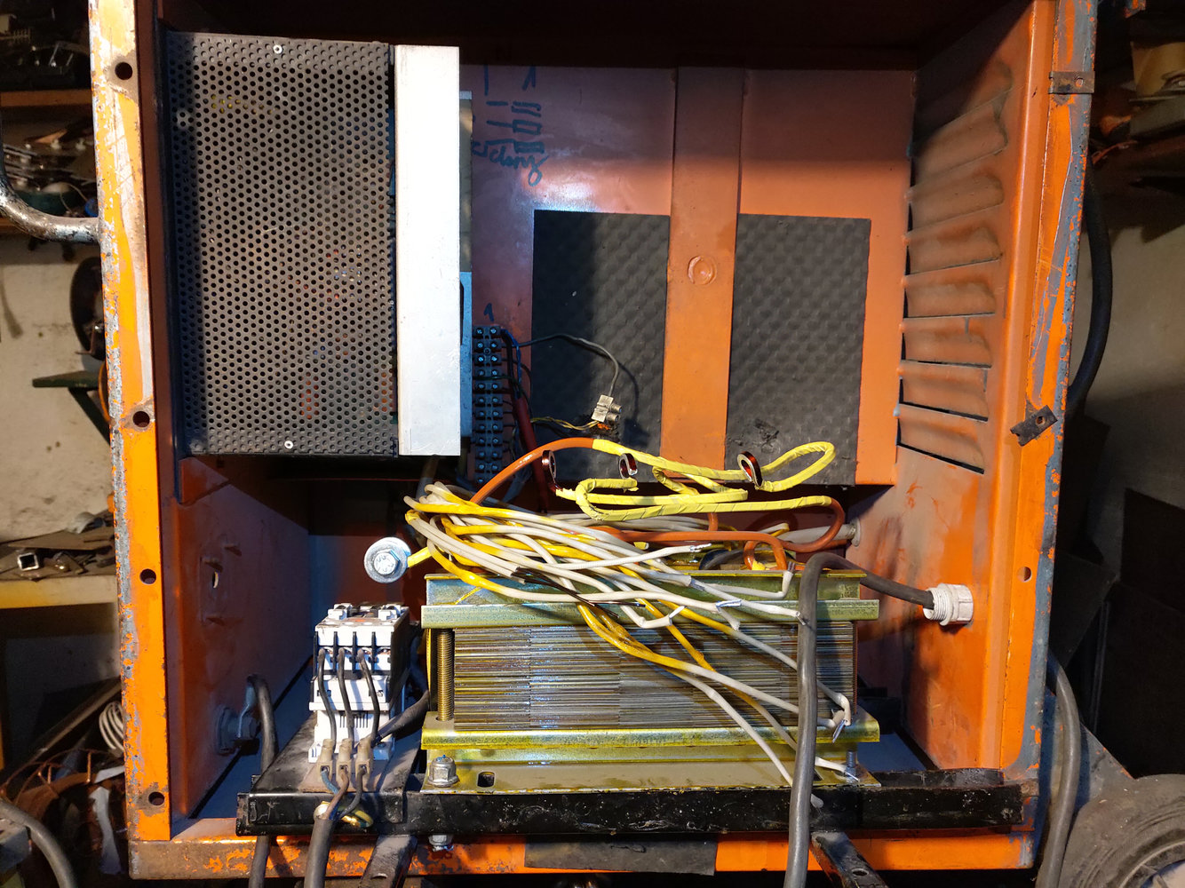

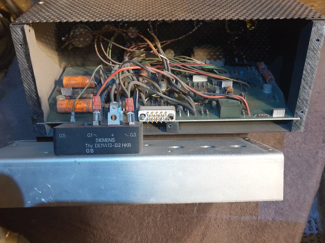

I need to rebuild an old MIG, 3-phase, estimated at approx. 160A, (the switch had 6 current ranges).

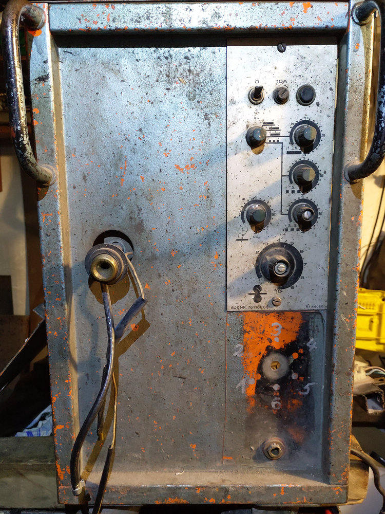

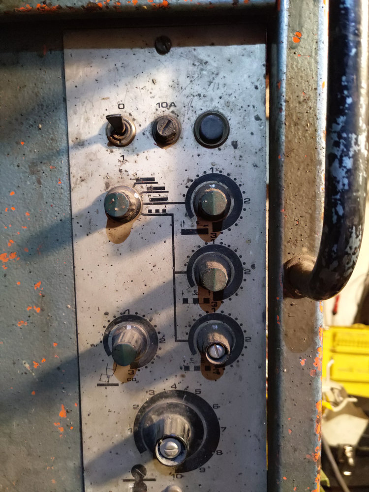

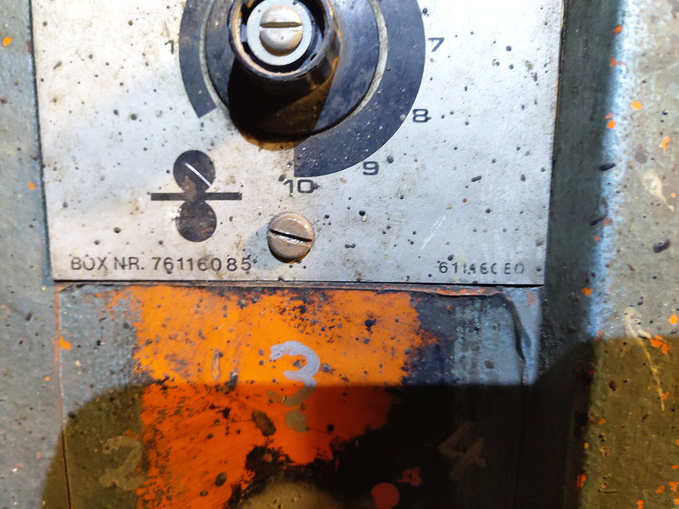

Unfortunately, there is no nameplate anywhere, only symbols/inscriptions on the control panel.

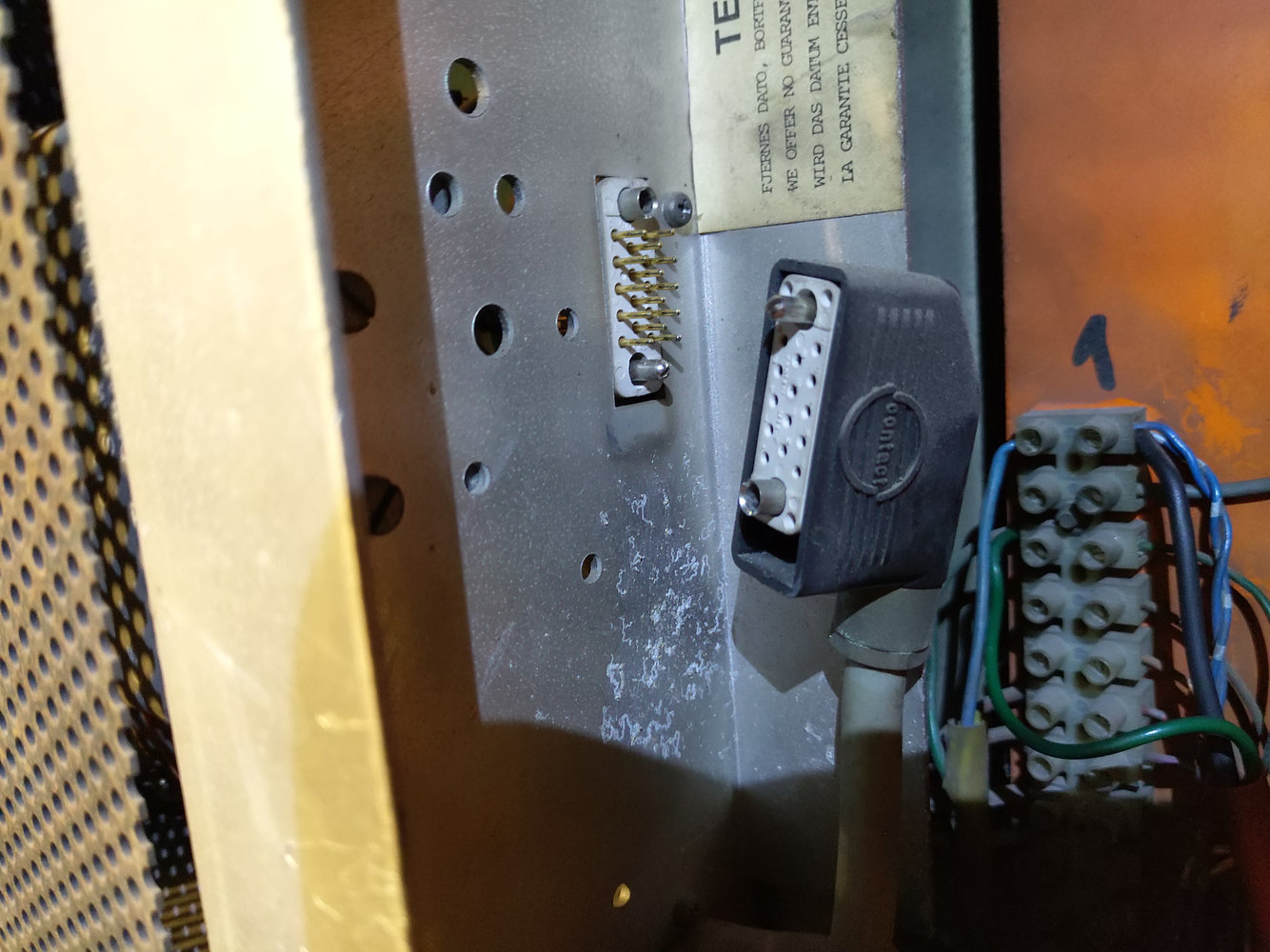

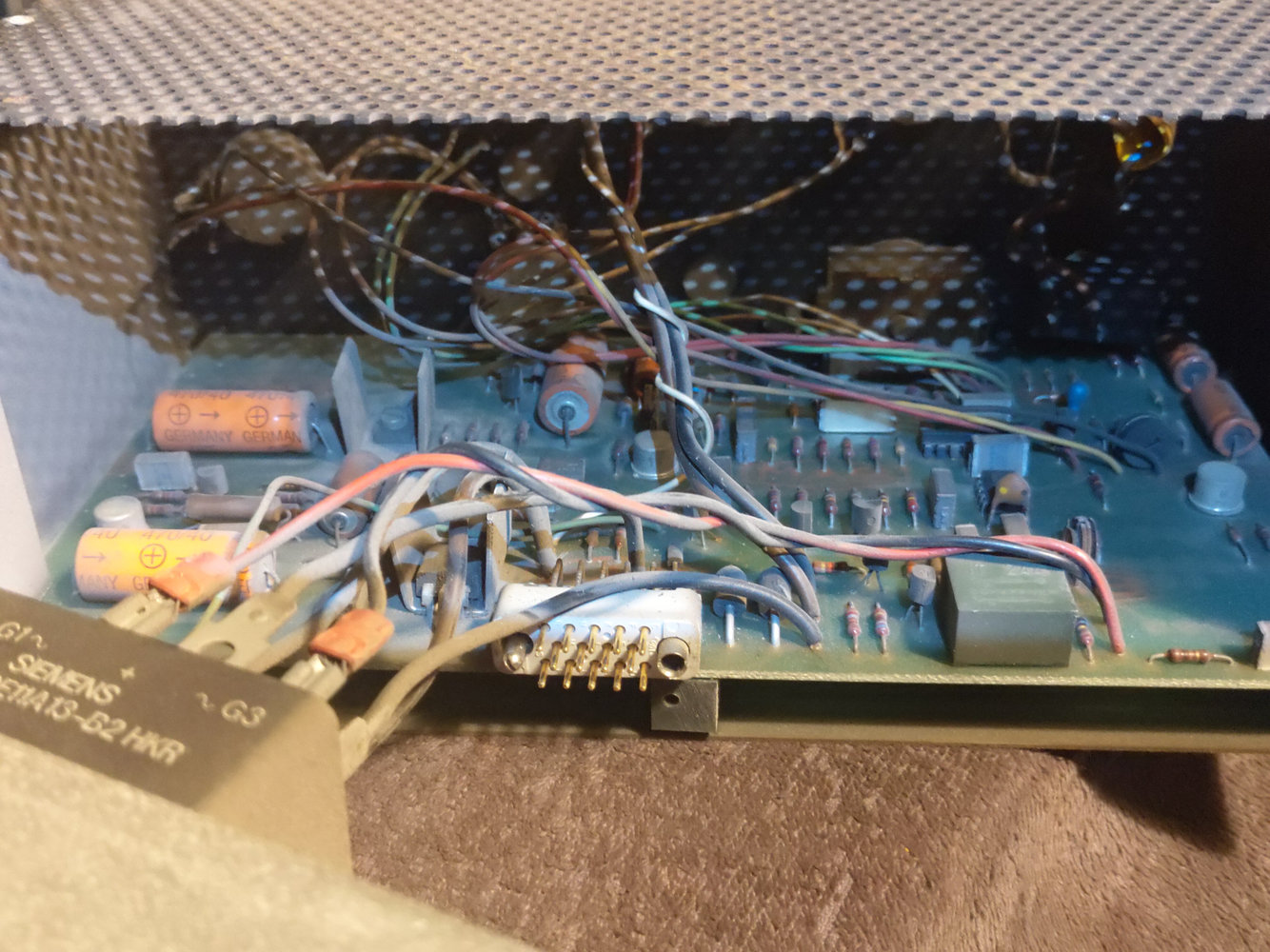

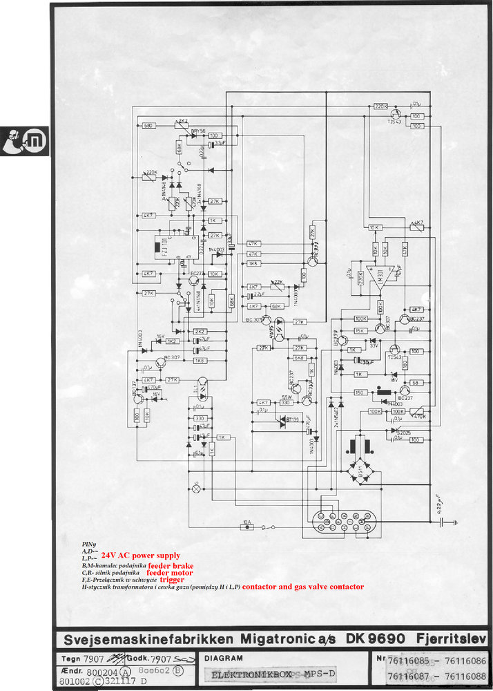

Does anyone recognize someone like that? I need a diagram of the control board, the board has a characteristic 14-pin connector.
Specifically, I don't know where to connect the power supply to the control board (my friend cut the wires together with the burnt main transformer and didn't note anything). The plate is powered by a small 400/24V transformer, approx. 40VA, and the feeder is powered by the main transformer.
Regards
