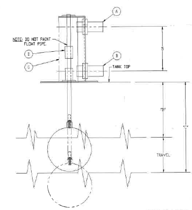

This is a quick shot of a level switch assembly used by a US company I started work for in '99 - a rummage in my drawers produced a drawing:
Stainless steel ball float, rod, collar etc. Exactly the same idea as the UK company had (except they used three switches - in descending order - operating level, fill level (ie call for fill) and low level (stop machine, sound alarm to protect pump, heaters etc). The only time they didn't work reliable was aireated water, or extreme foam - they would then just sit on low level as the float didn't . . .
One of the floats we used was made from chipati tins - lid and base tigged up - cheap, worked, and available just up the road from our factory in Bradford).
Conductance probes worked pretty well (could even use the tank as one of the electrodes) - but if they get covered in crap, as I suspect the flux might do, you get false readings.
Only used a few ultrasonic level sensors - they were sod ding expensve over 20 yrs ago and customers didn't like paying for them.
Gaz's ball float valve - might not be as daft, although I suspect "gloopy flux" might not allow it to work as well as hoped - any seals in there won't be happy either. But certainly still used in industry as a cheap, quick, pretty reliable method of tank level control (one of our competitors does - our equivalent has been attacked by someone with shares in IFM . . . )

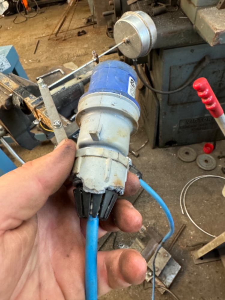

It eats plugs for fun this media. I replaced this plug with a brand new one and it done the same in under a week.

it will be the fumes and then when the system goes cold it will turn back to a solid acid flux state with each cycleHow is the plug getting covered in flux anyway, or is it fume?
Its not fumesit will be the fumes and then when the system goes cold it will turn back to a solid acid flux state with each cycle

The machine is not very good, flux gets spilt everywhere during the filling cycle and during the cleaning process.Time to hardwire into a nice stainless isolator...
Not all plugs are the same plastic either, some will likely have more resistance against certain chemicals than others.
