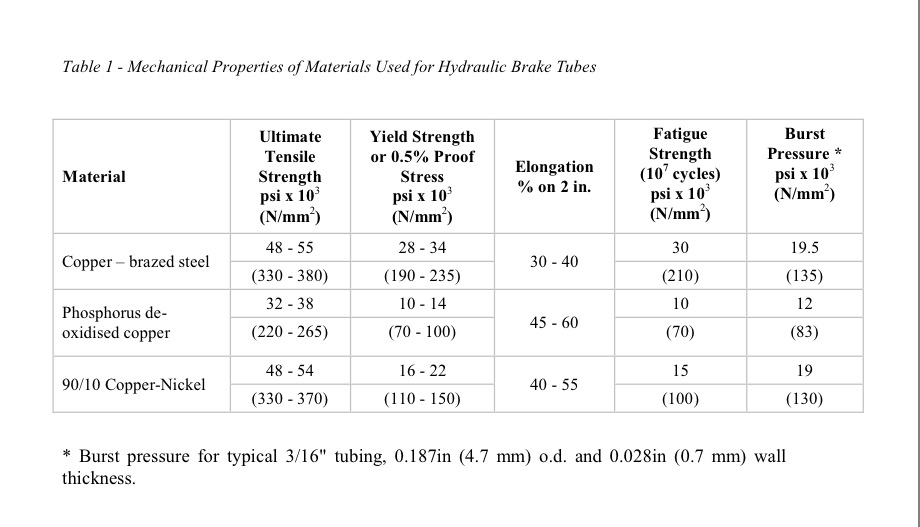

Won't be long before I need to mount new copper brake lines to my chassis. The plastic OEM clips won't as my plumbing has been altered from original.
So these are the standard method, will do the trick if I can't find anything nicer which would also hold both my brake lines with one clamp.
These are much neater, will hold both my brake lines. But no rubber mount which is apparently important on copper lines to reduce work hardening.
These fit the bill but no way at £20 a part:
Also need some way to mount my fuel lines, which now run in plastic, and the thick cables that supply power to my winch. This seems easiest solution, but something more solid would be nice:
