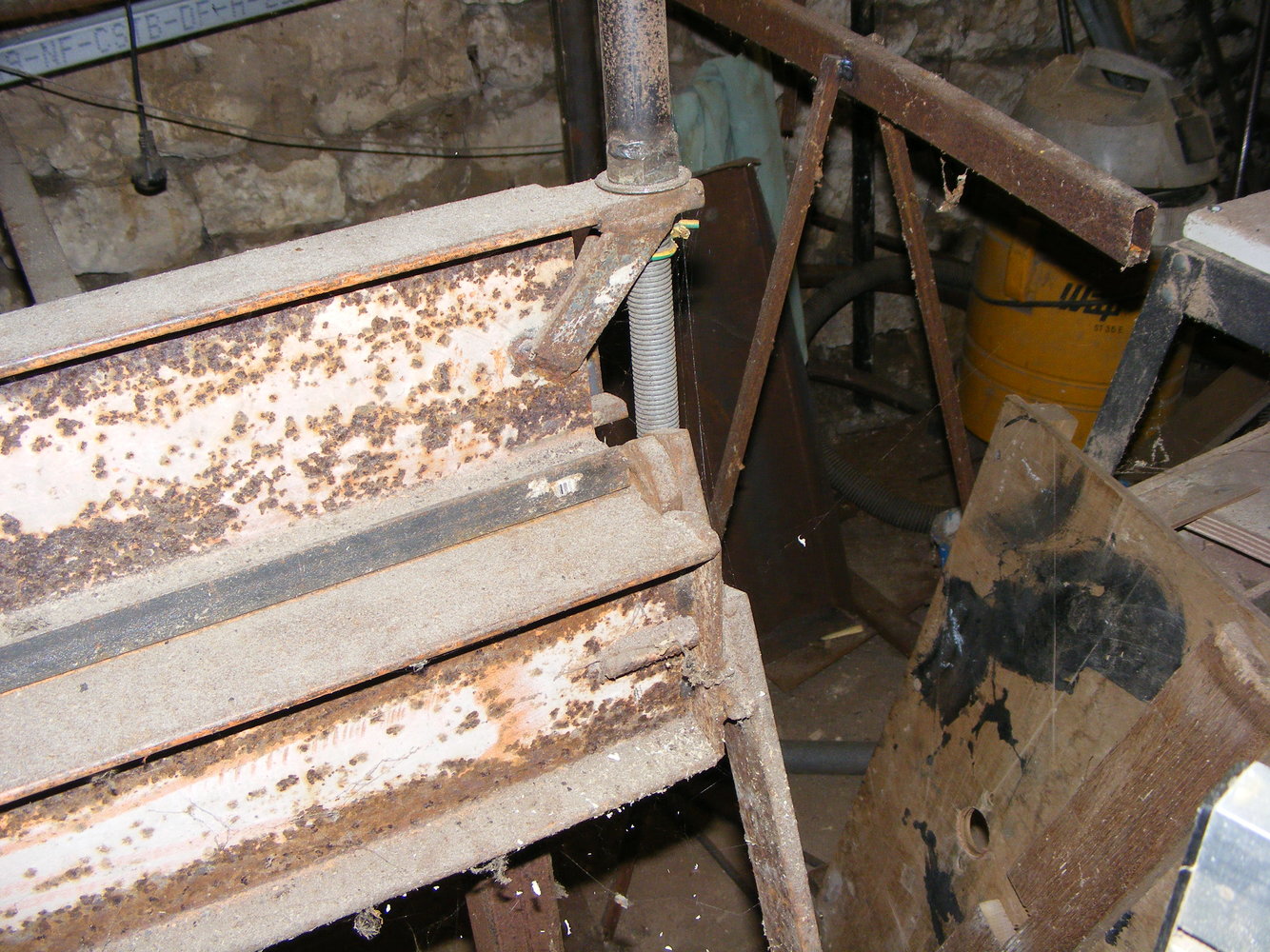

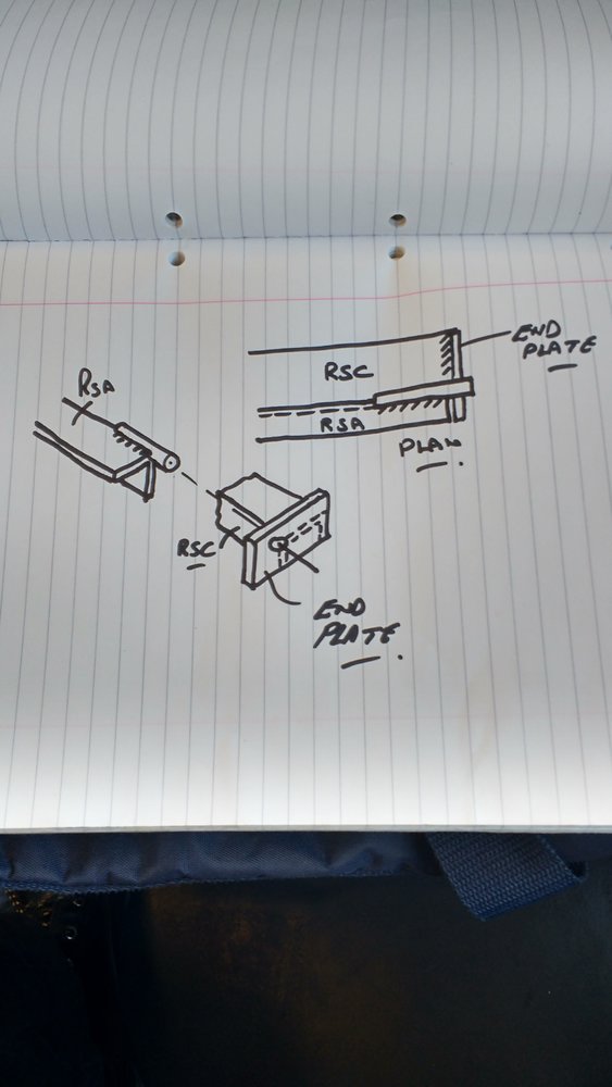

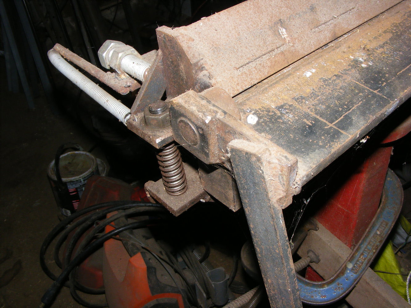

The folder needed to be a bit wider. All I had was an old bit of 76x38 galv RSC. That and some more of the 50mm equal angle.
Hinges will be 20mm galv conduit with the plain shank of an M16 bolt shoved up. A tad loose...might tap the BiL up and see if I can turn down some bigger dia pins at his place.
Got to grind that galv off for welding of course.
