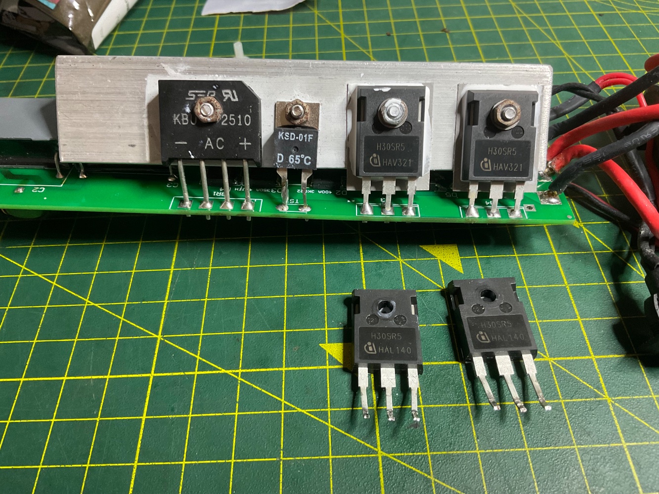

Ah good to see you got it going.These IGBTs had shorted (new ones fitted):
The thermal fuse (second from left) had a broken leg, so perhaps that prevented overtemp shutdown. Reattached.

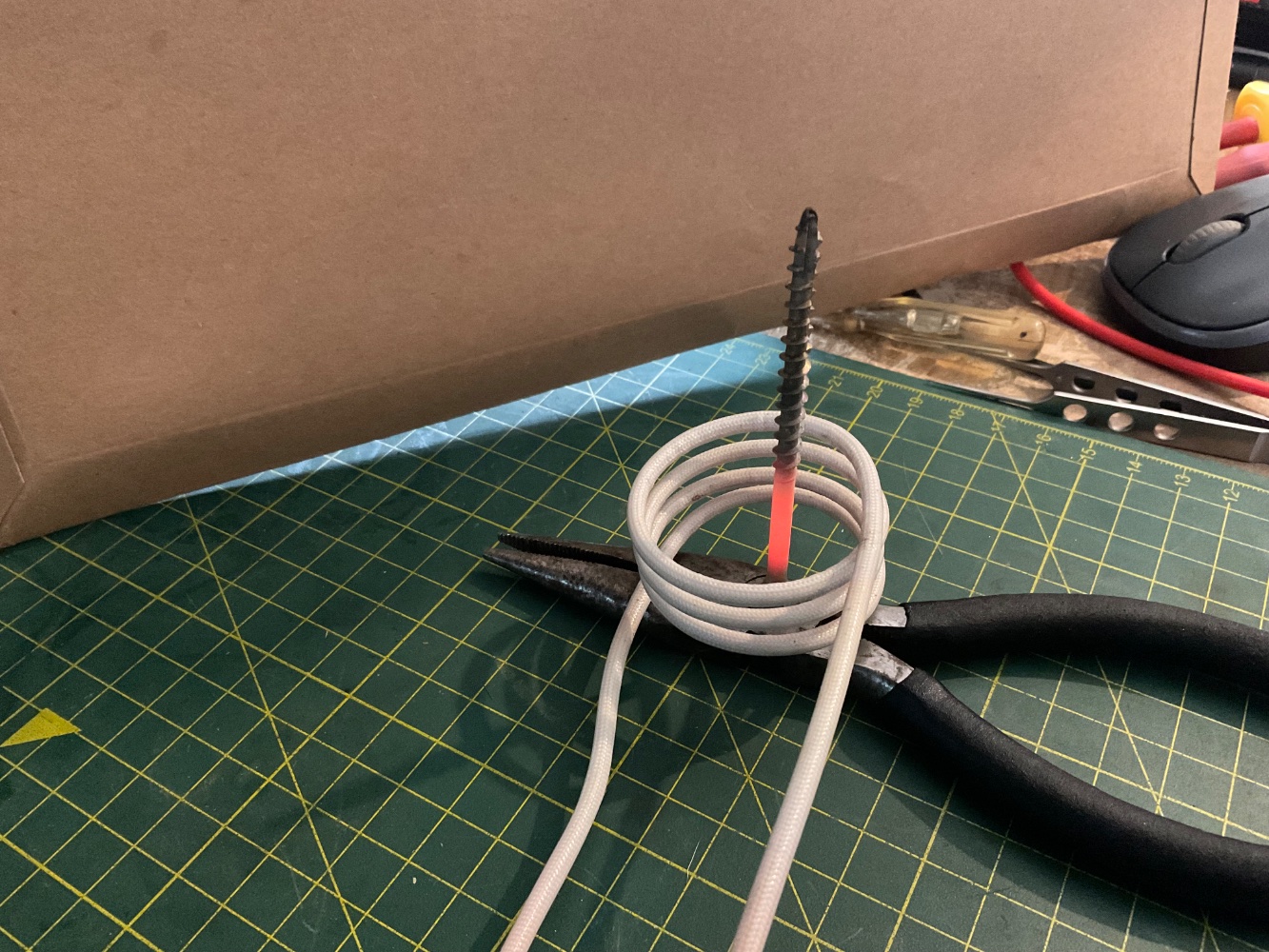

Seems to work:
While heating the screw, it was drawing about 1.6A, equivalent to 380W or so. Power factor was close to one.
A little bit different from the claimed 1000W, but maybe it draws more when heating a bigger thing. I couldn’t be bothered replacing the board fuse, so it will run with a 5A one in the plugtop.
