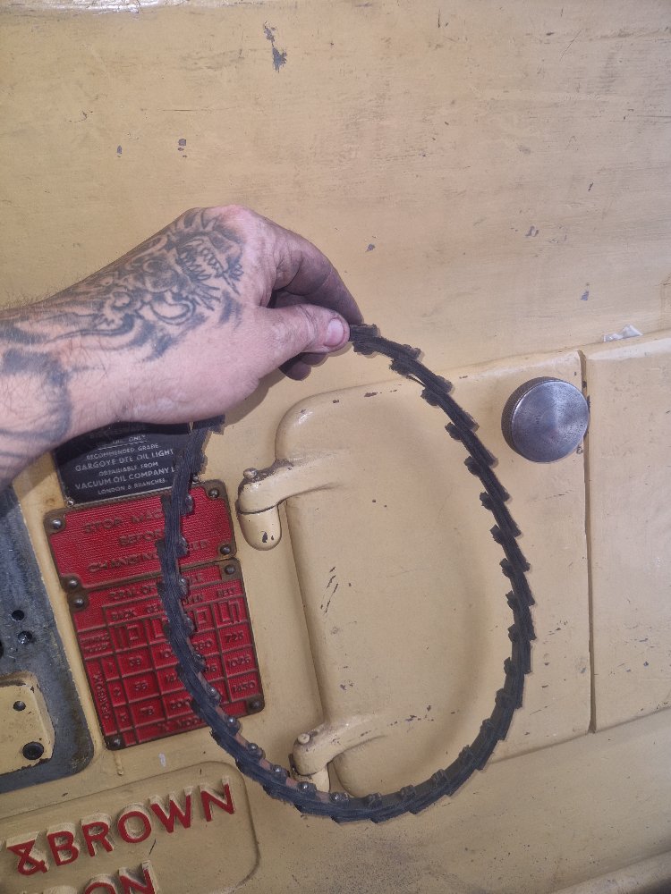

Motor to gearbox belt on the lathe.
Appears to be slipping, and on inspection its not in the best of conditions.
Top measures 14mm then tapers down to roughly 8mm, approx 825mm length. Can I replace with a rubber v belt?
I always thought link belts like this were all the same width but haven't really used them much in the past.

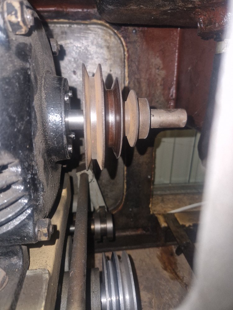

Photo of top pulley from motor for extra reference, you can see which one is been running on.
That pulley was hot when I took the belt off, motor, shaft and bottom pulley all cold.
Also worth noting, not the original motor for the lathe so I massively doubt the pulley is original. Looks like it's off a drill
