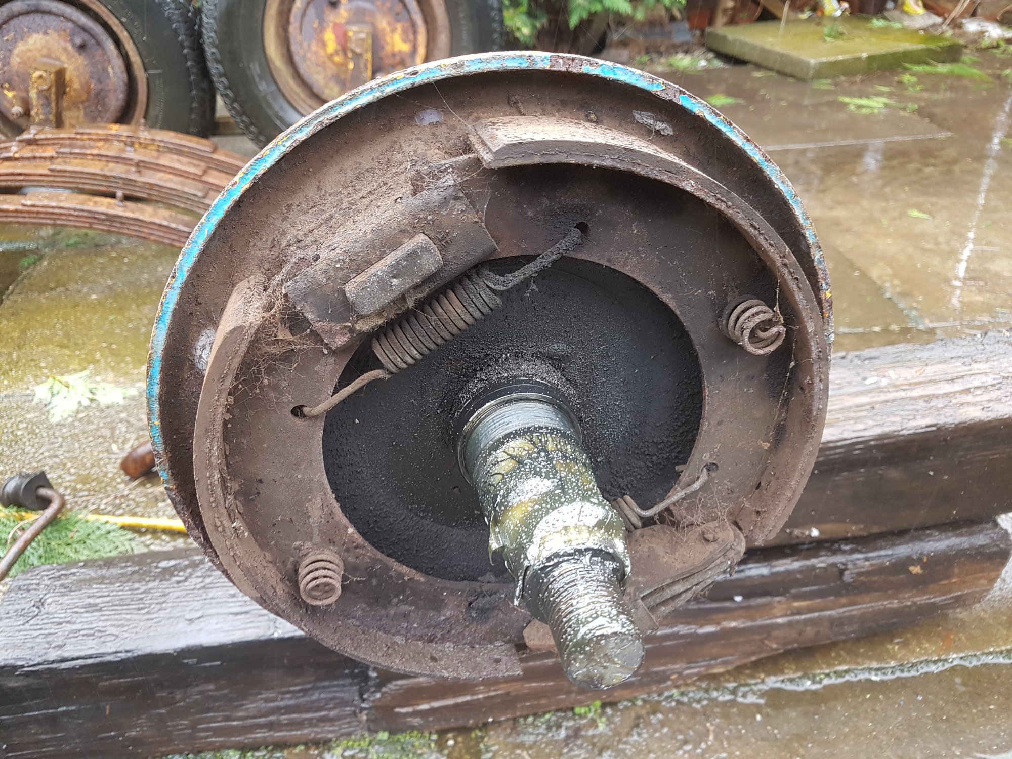

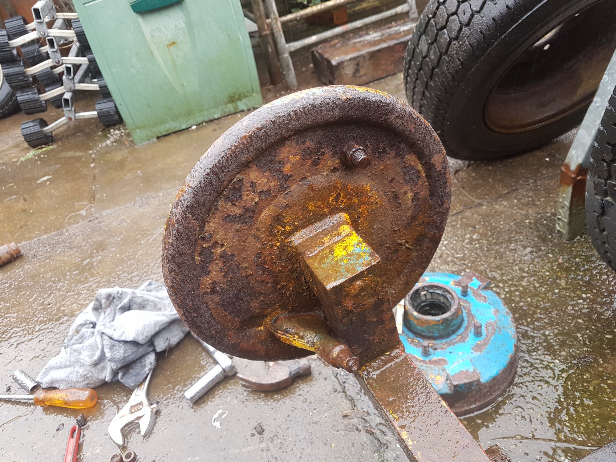

Looks to be a fair bit of friction material left on the shoes unless they're contaminated.

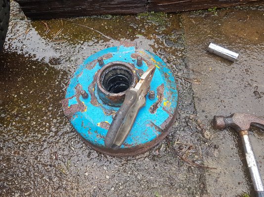

That was cheaper than having them relined !I am trying to refurb these trailer brakes and as there are no markings i can not see how i can find a set of replacement shoes.
can anybody ID them for me please.

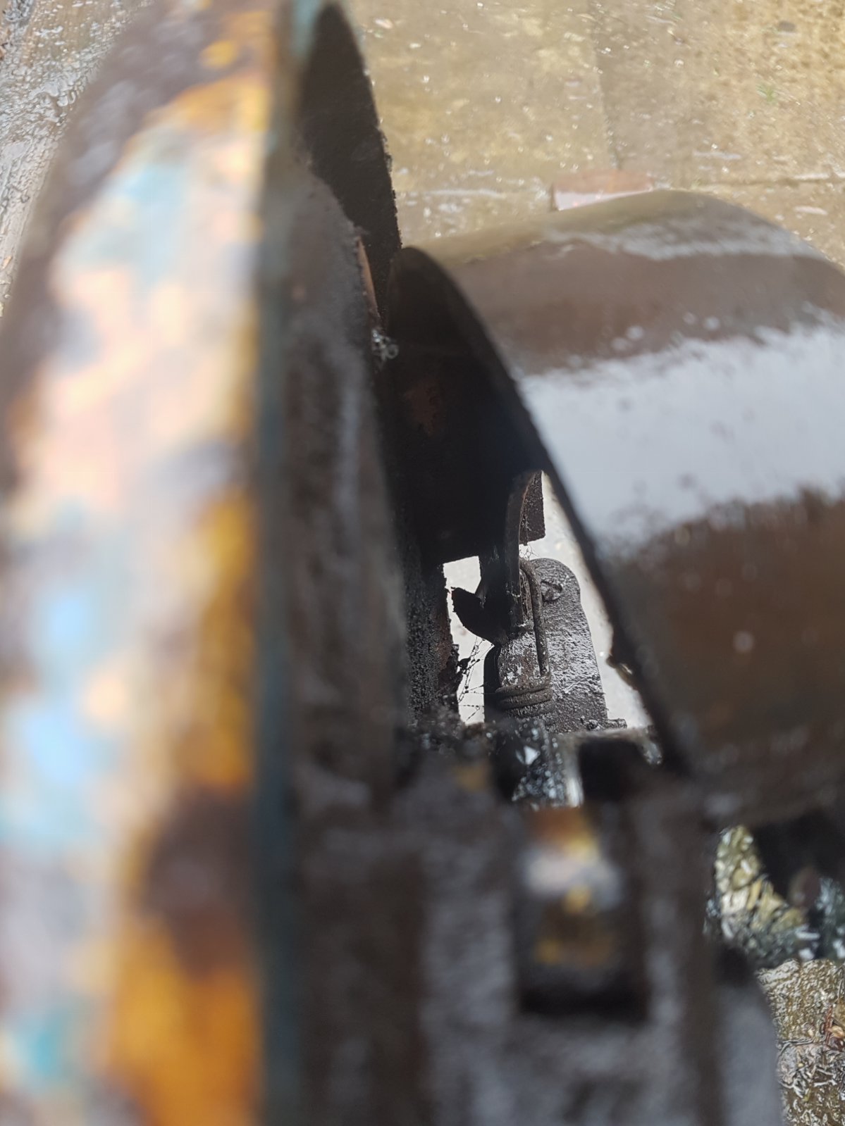

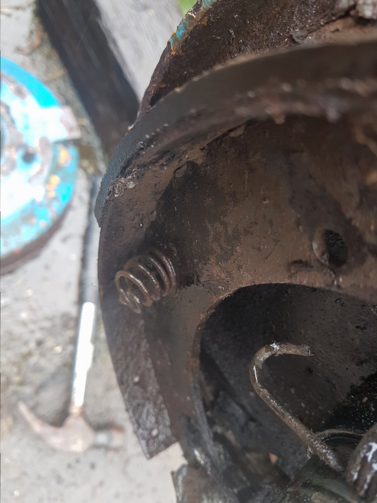

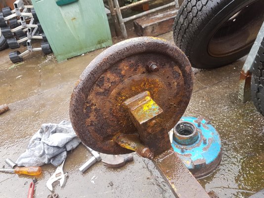

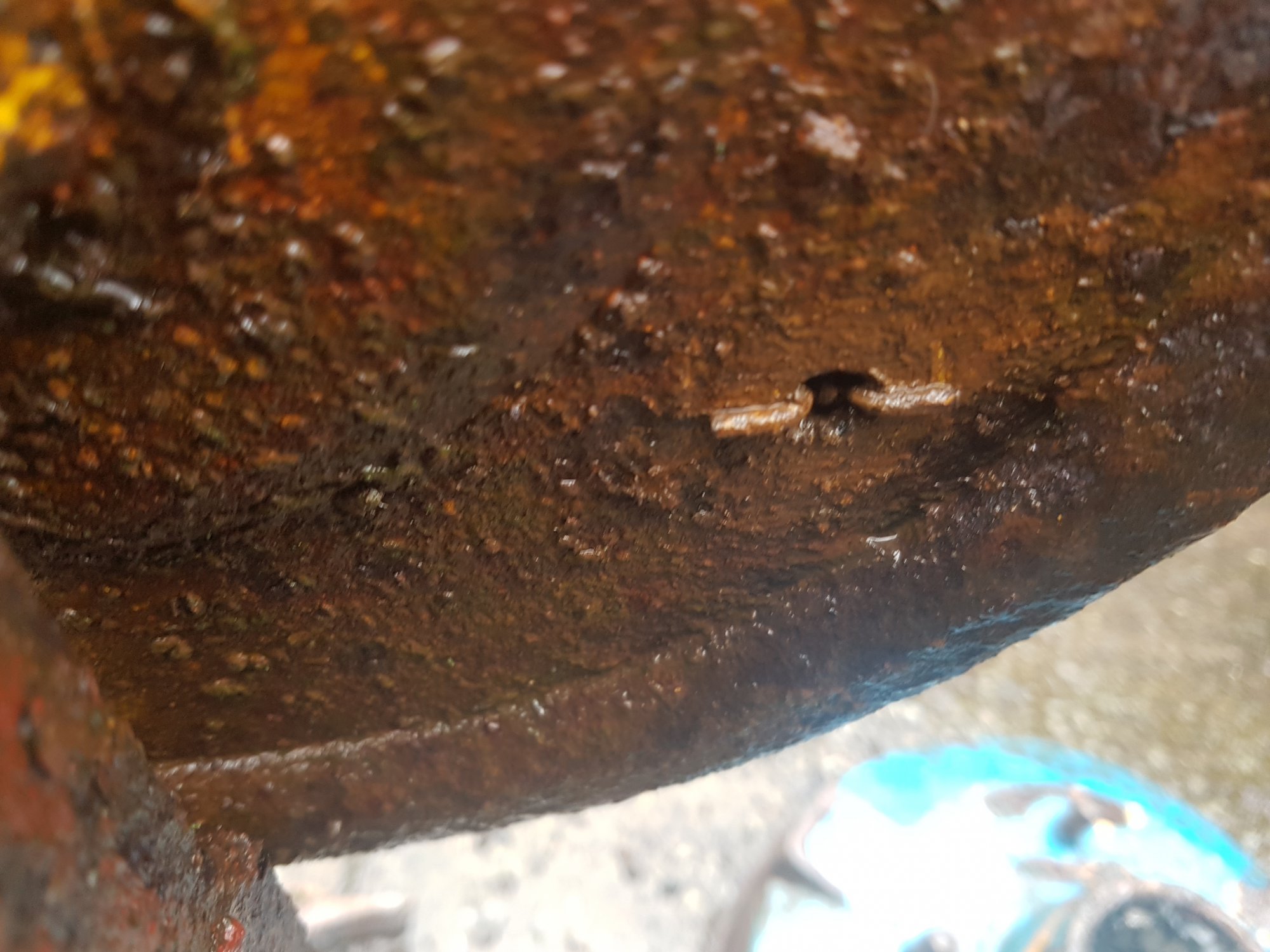

these area close up, ,
I'd just unwind them like a screw...
Those spring retainers are in two parts, the bit you see in picture two is just a loop on the inside of the backplate, the spring retainer on the shoe has a hook on the end of it. Put a finger on the bit you see in picture two then push and twist the spring inwards.

Looking on traliertek, it's looks like they are Peak drums given the 3 raised points on the edges
