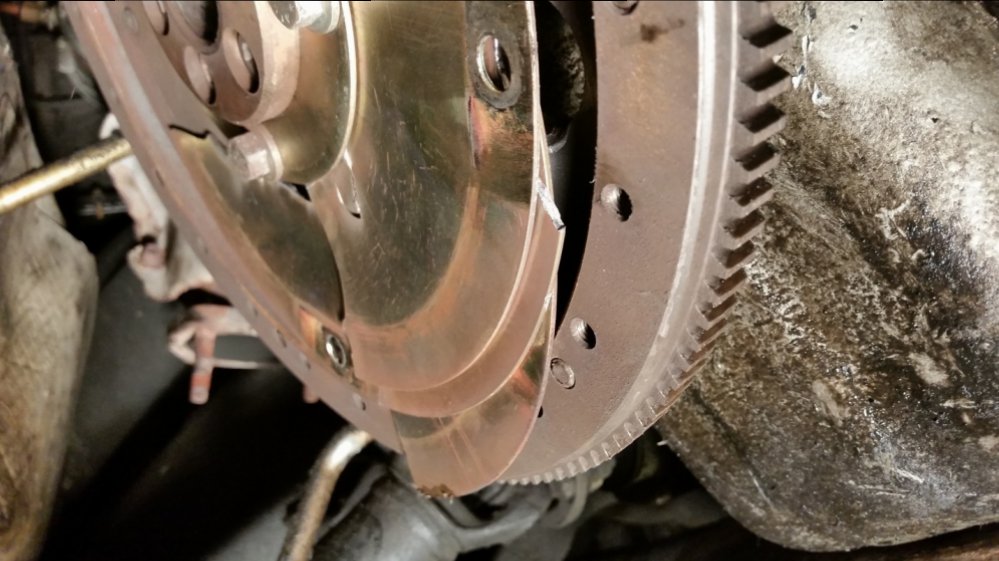

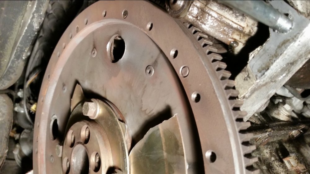

Split the gearbox this afternoon and this is what I found!
There were two bell housing bolts missing and the rest weren't that tight. I suspect that excessive movement between gearbox and engine over a period of time just over stressed the flex plate.
I should say that I bough the car, cheap, as a set of spares for mine, but when I heard it and talked to the seller about the symptoms - I suspected the flex plate.
Nice to have it confirmed!
Cheers
Peter
