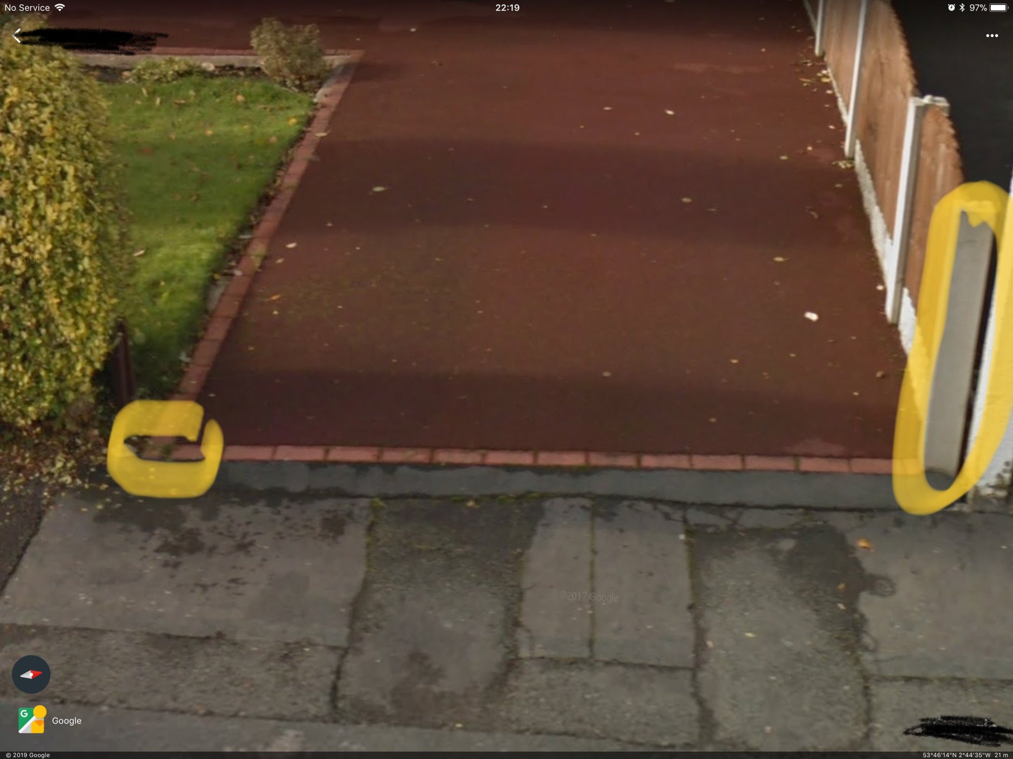

    a friend of mine has recommended me to his neighbour
    He wants a double drive gate making but it’s goibg to need steel posts, the problem is I’ve been Lucky enough so far to be able to hang gates of posts that where previously there but this job is going to require 2
    The issue I have is they want the post right at the very edge of their garden boundary so when I’m digging the hole out I might have to dig some of the public footpath out too. The have a nice drive which I don’t want to spoil
    What are the chances of coming across underground services if I was to dig 2-3ft deep aswell?
    I’m not sure if I should walk away from this job or just quote them really high to put them off using me?
    The experence on the other hand would be useful !

    The areas highlighted are where he wants the posts, on the right he wants the concrete post removing and replacing with a steel post, I sudgested a bit of channel on the back side of the steel post to hold his wood fence in place, on the left he wants a post to sit where the corner block is on the block paving edging
    Can’t say I’ve ever had to remove a concrete post that’s been concreted in either, I don’t think it’s going to be an easy task. 35101902-63B5-4013-8358-6FB8E92FFFF1.jpeg

    No way your getting posts in and out without touching that drive.
    I'd recommend them a couple of foot of granite sets or blocks and cut the existing drive back for decent access to work.

    I think it’s block Work, what are the chances of finding block Work that colour, each batch is different isn’t it? Even so it’s aged so what ever I did it’s going to stand out

    I don’t know much about ground Work but is that drive (from the looks of the photo) red tarmac? Or resin...

    It's tarmac with pavers edging.
    Cut it back a foot and put granite sets in or match the blocks and have them over the threshold.
    Your gonna need room to dig the old post out and install new. Not gonna happen with that drive intact.
    What's the other side of the existing post.
    Looks like another drive

    I couldn’t even put surface mounted posts in because the drive is not level, I’d still have to cut a section out to put a level concrete pad down

    Yep another drive with another concrete post, it’s not in use but I can guarantee it’s all concreted together in one big blob

    Why not get the neighbour to get a builder in to do the posts...that way you are only on the hook for the gate?

    Yeah good idea, the fabrication side of it no issues at all but with very limited experence in setting steel post in concrete I don’t really want this to go tits up because it may put me off for good

    Why not simply tell the client that they need to provide the holes ready for the posts, as you do not wish to deal with unforeseen utility or underground issues.

    Definitely get a builder in for the posts....thats what I did with mine. A builder will be able to dig a good hole with vertical sides....my holes are like craters!
