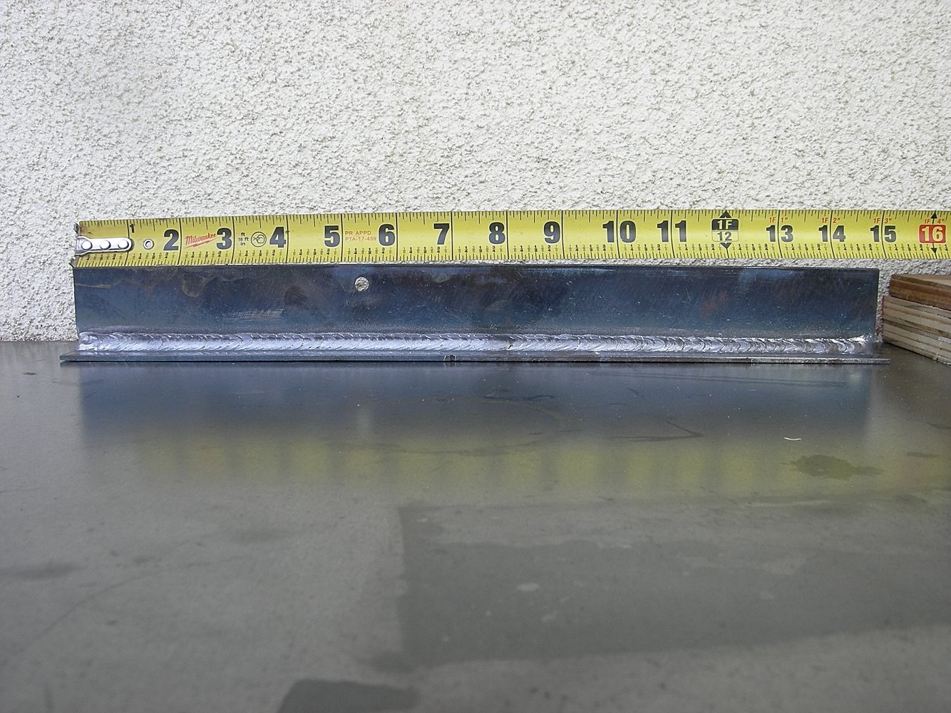

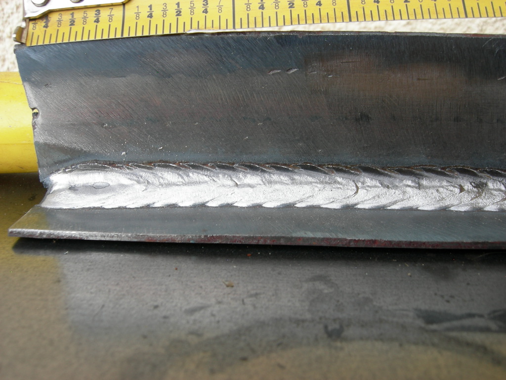

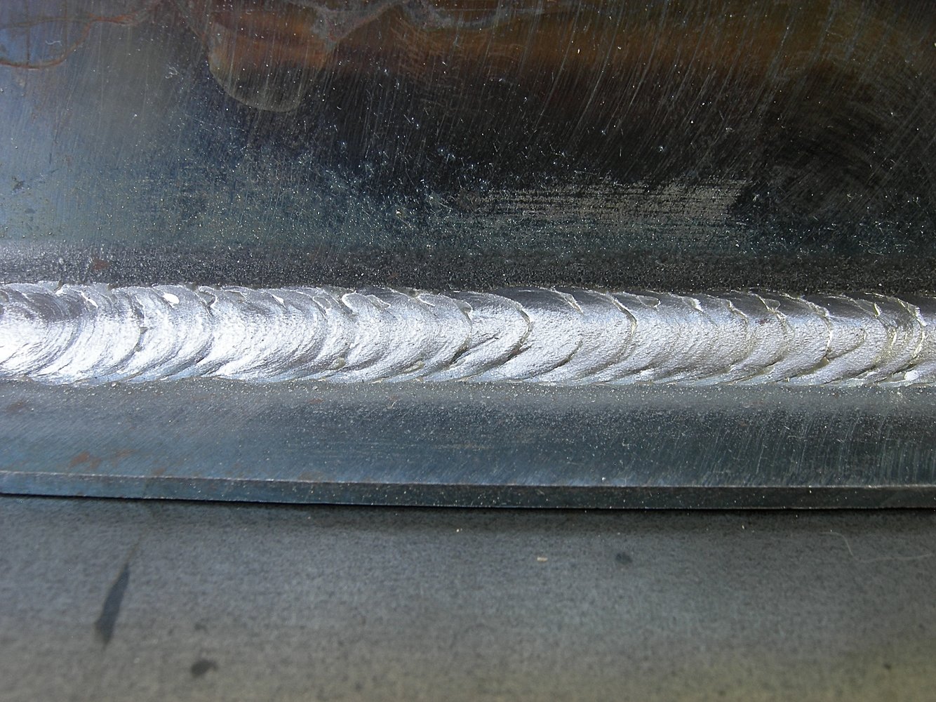

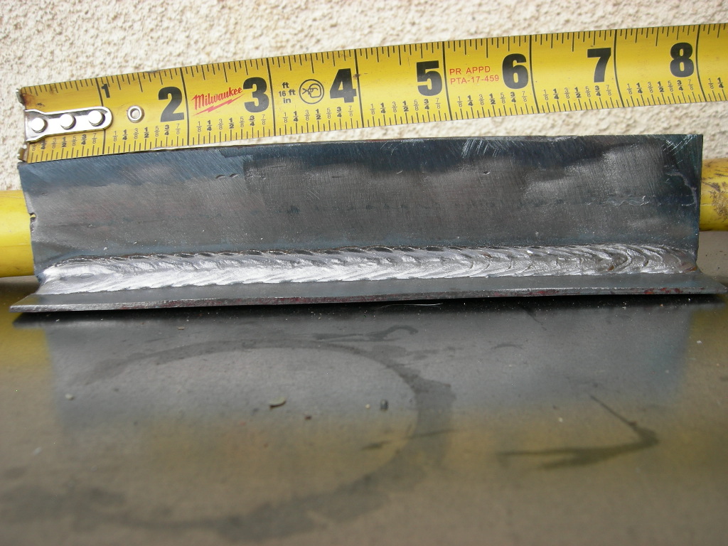

Just a bit of advice try to fill the crater at the end of the weld, possible point for the start of a crack just where the heat mark is...other than that looks good. Can you post up some photo's of the backside of the weld joint to judge weld penetration,please.
