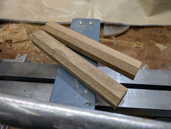

The experiment started with two left-over bits of walnut (from when I made a lot of chisel handles a couple of years ago):

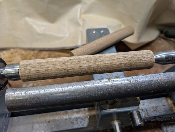

They both got turned into cylinders with a roughing gouge:

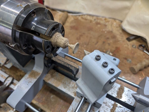

I then got the spindle gouge out and attacked one of them in a rather random manner and with no particular shape in mind:

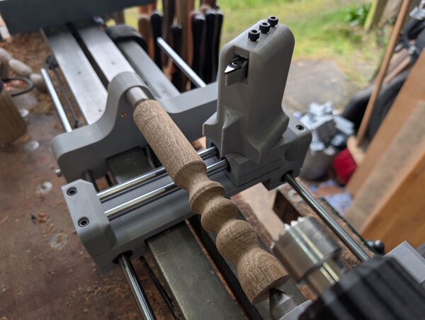

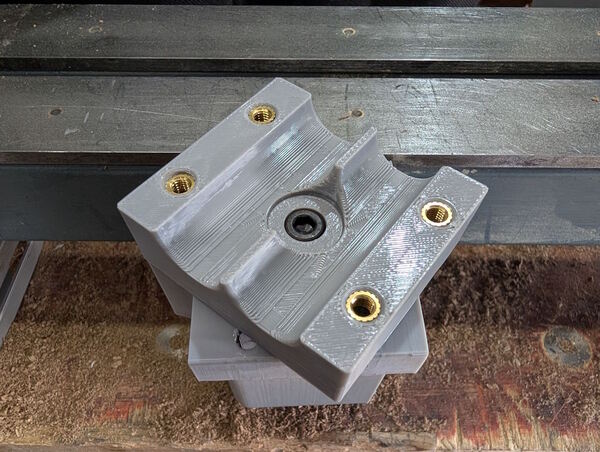

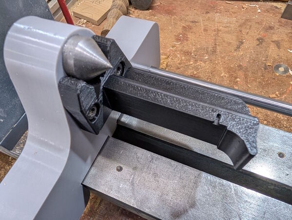

Off the lathe it came and a contraption that was almost entirely made by my 3D printer got mounted onto the lathe:

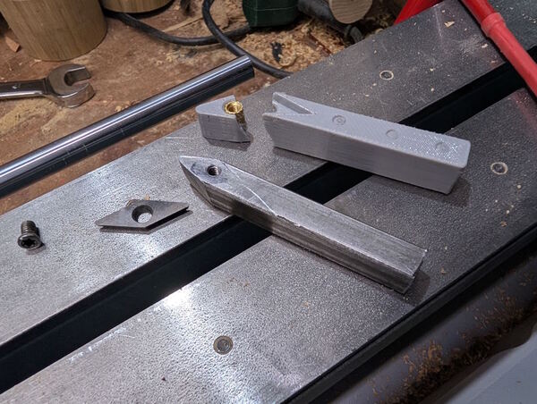

The only bits not 3D-printed are a cheap insert cutter from ridethebevel.co.uk, the four steel bars along with the LM10UU linear bearings that run on them, the two centres (turned on the metalworking lathe) and lots and lots and lots and lots of brass threaded inserts and steel screws. The linear bearings allow the tall bit of the assembly to move smoothly along and across the bed. The tool post thing has a pointy-out bit that touches the first (lower) turned part and stops the tool post (and hence the cutter) from moving too far in.

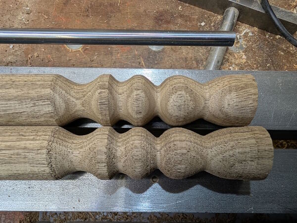

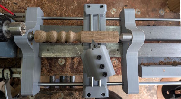

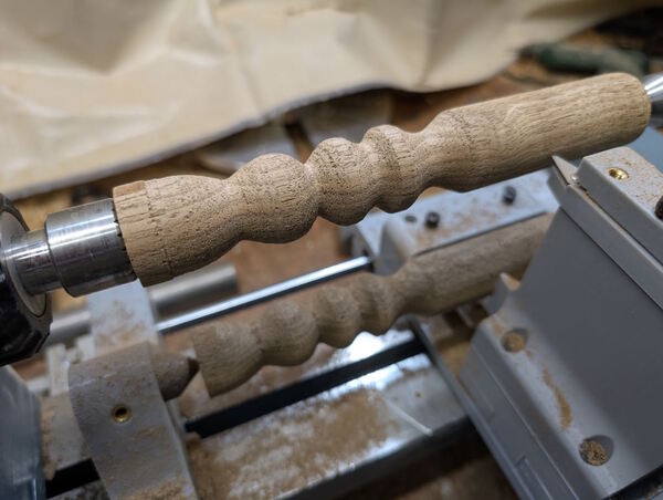

I was expecting it to shake itself apart or just vibrate too much to be of any use, but it just worked, with the cutter easily skimming down the workpiece to the right size:
The finish isn't amazing, but it's good enough that it wouldn't take much sanding. If/when I use it for real, I'll probably leave sanding of the "master" part until I've done all the duplicates and then everything will be sanded from the same base shape. A more direct comparison of the two parts:

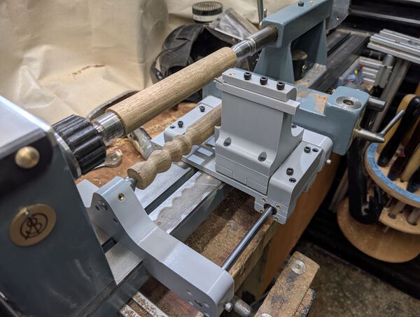

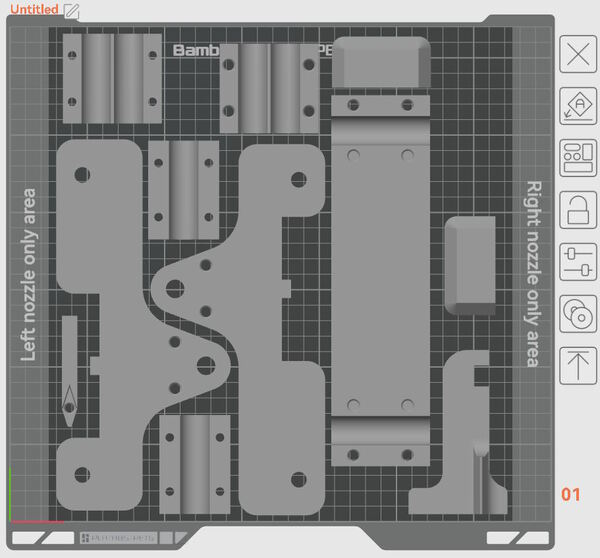

Tonight I'll print version 2 with a few minor changes (mainly increasing the maximum part diameter to about 70 mm instead of the current 40 mm, but also making the tool post and cross-slide narrower). One nice thing about the design (and my new big 3D printer) is that all the parts fit easily on the printer bed in one go:
