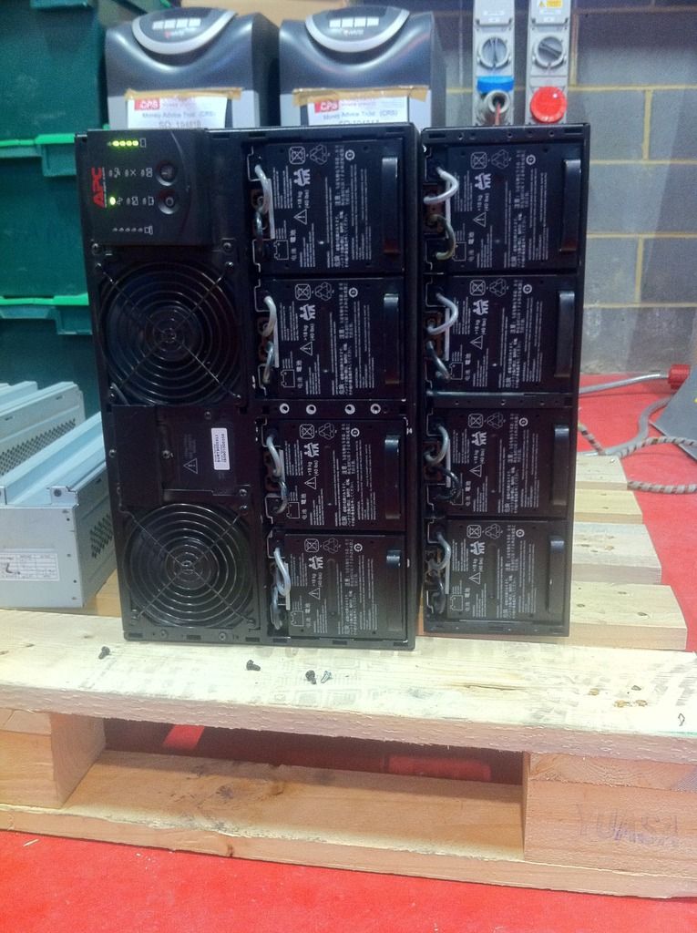

Another UPS, coming my way (this one works, but i am having to pay for it) -
8kva, and has the additional add-on battery pack. You would not want to put your tongue across those terminals!
Why do i want one?
Firstly, to keep the cnc machine running through brown outs etc.
Secondly, i have a 1950s single cylinder lister. Ive been trying to get that hooked up to the house electrics for some time, but have never been able to work out a way to not just cause issues (a grid tie inverter was my first plan, but then the engine wont track the load. i then thought about current shunts and servos, but never got around to it)
Anyhow, a large ups between the generator and the house will allow for short term overloads (ie pulling more power than the generator can supply) without needing the generator on full power all the time.
