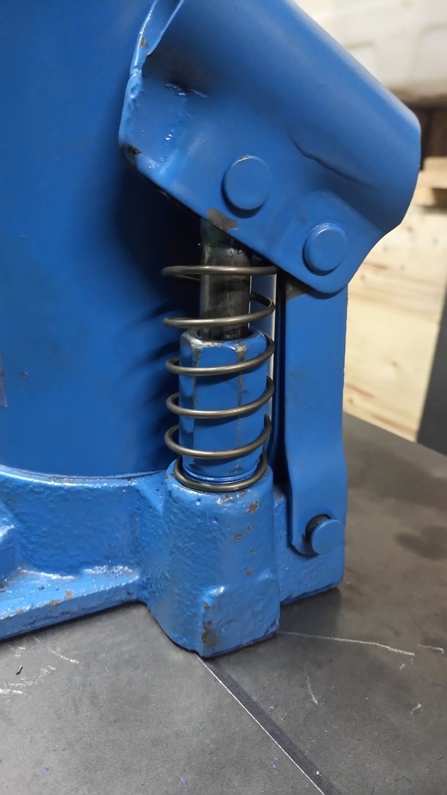

They list 27mm, So with 2mm wire it should give me around 23mm ID
If you try em let us know how they were mate. Gonna be in need of some springs soon.They list 27mm, So with 2mm wire it should give me around 23mm ID
Looks like he's got an eBay store:If you try em let us know how they were mate. Gonna be in need of some springs soon.
Ordered one off eBay guys, So will wait & see if its any good when it arrives!
This one:Which of the sources linked to above did you use? Just for future reference.
Arrived today, Problem sorted!
No spring originally!Did that have a spring on originally? Don’t think I have ever seen a bottle jack with a spring there.
I wanted to fit a return spring to make life easier when I fit the foot jacking pedal. Otherwise I would have to lift the pedal up & down rather than just keep pumping it.
Possibly!You might need a bigger spring for a pedal return, depends how heavy the pedal is and how you link it.
