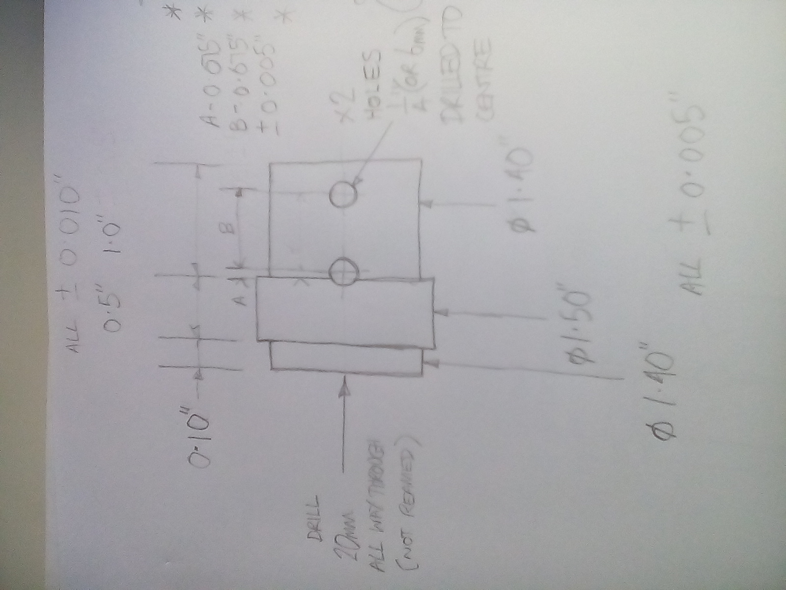

Mild steel a bit hard to get a decent finish on the bore with my tooling.View attachment 231356
1. Mild or any weldable carbon steel.
2. No surface finish required , part won't be visible.
3. No holes are reamed.
4. Bore is to press fit or weld in place 20 mm steel conduit ( .780" OD +/- 0.005" )
