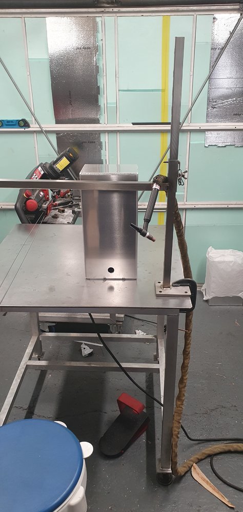

Practicing the MIG welds today. I'm pushing the gun from right to left with my right hand, while resting my right hand on my left hand. My left arm is propped on the weld table. I'd say the most difficult part of maintaining a constant travel speed is finding a way for my left arm to slide across the table at a constant speed. If I could do that, my welds would improve a 100%.
