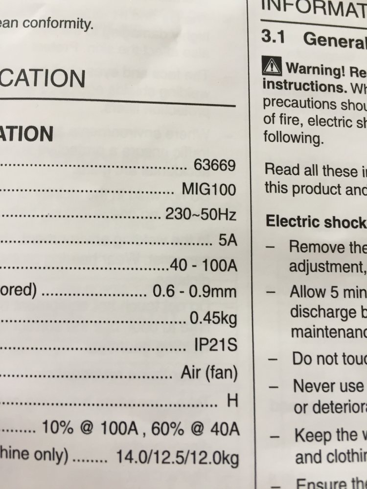

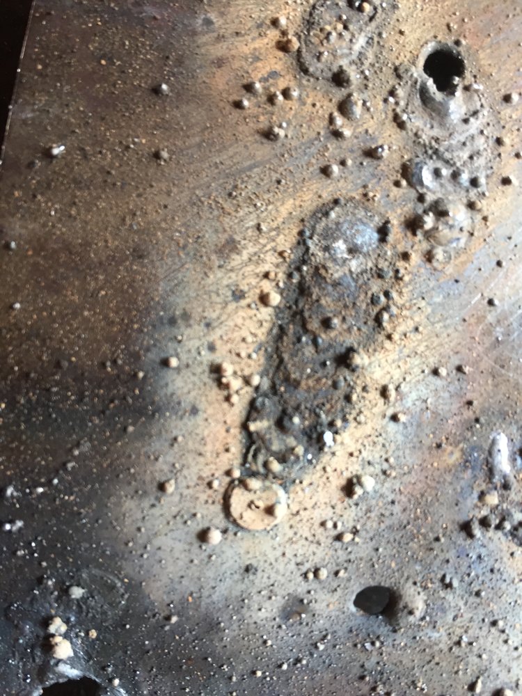

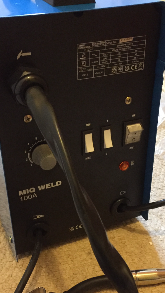

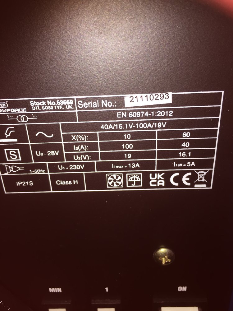

Ok shouldn’t require any fiddling with links then. Assume you have decent earth connection, gasless wire and have the tension settings ok?It’s a gasles mig welder .draper 100

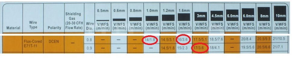

my welder went to the scrap man and i bought a decent machine mart welder back then and never looked back, just a thoughtNot common but you can get it, Lidl quite often have it in and it’s actually reasonable quality.Forgive me, I might be wrong on this, but is gasless wire smaller than 0.8 even a thing? I've never seen it at the likes of rapid welding etc?
