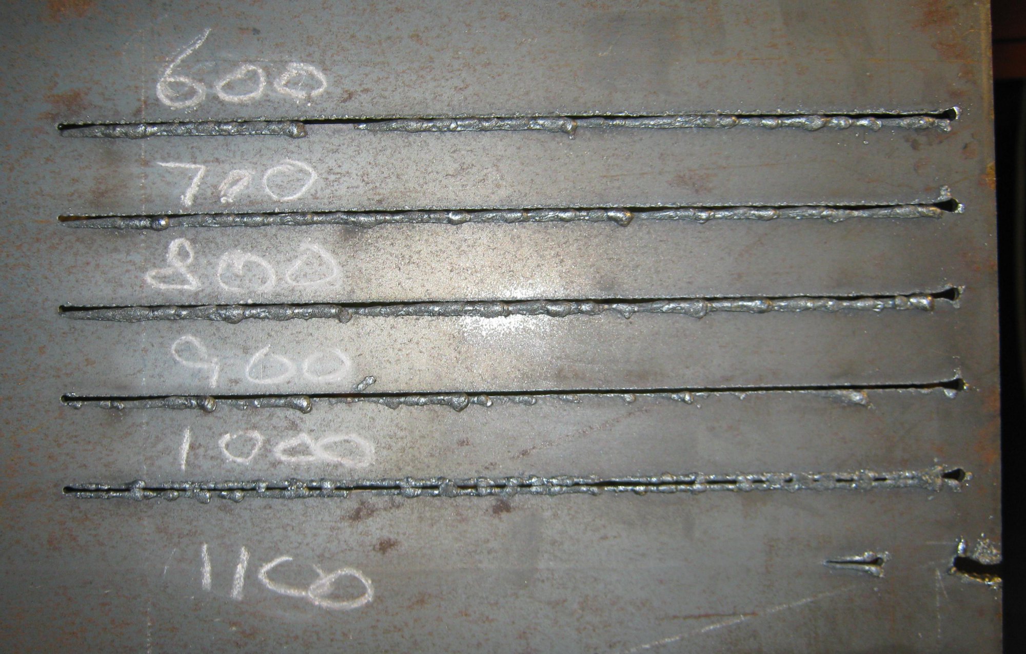

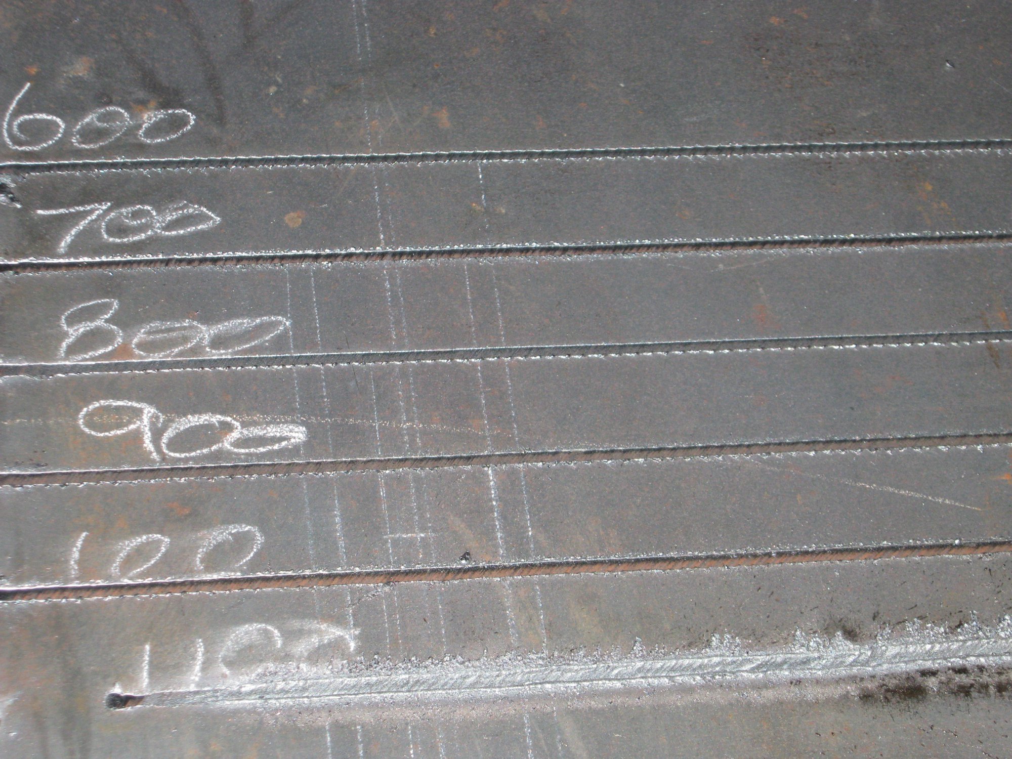

Here is a picture of the top of the cuts.
The true story is on the back side of the sheet.
This is prior to removing any dross, it all came off easy, I could slide a chipping hammer across the back and all would chip away, easily. It does tell me I will not get rid of the hassle of removing it from the back side of anything I do, but 900 mm per min was the least to remove on this test.

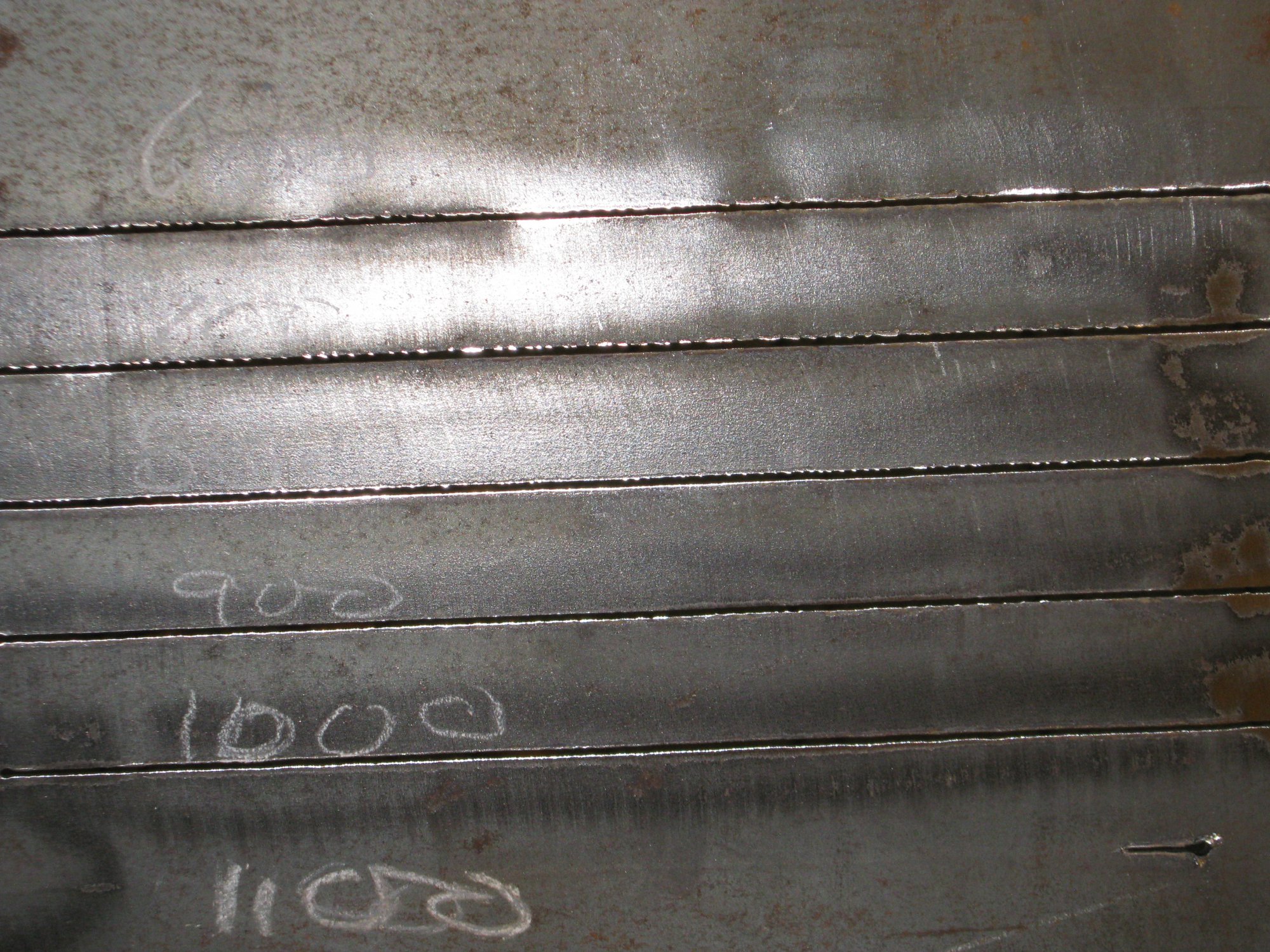

Next I ran a flat flap disc over the back side to determine what the cut slots looked like without being hidden and we have this final picture.
Again to my mind 900mm looks the better cut to me at least, so I have a base setting for one thickness.
