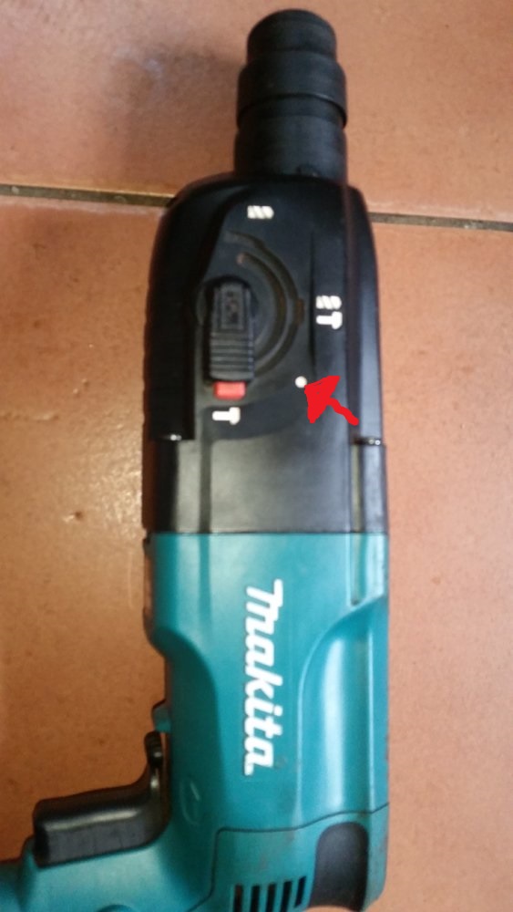

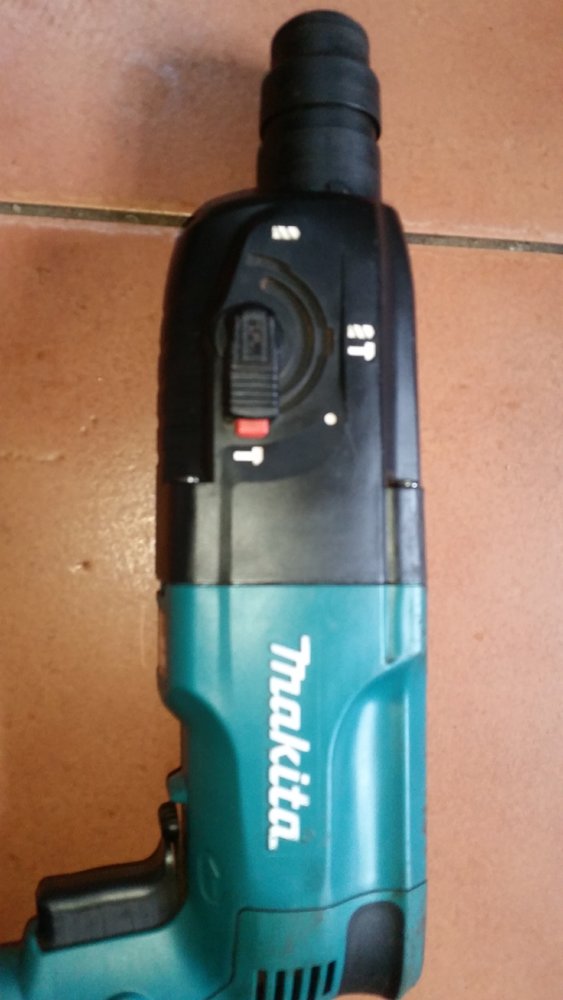

I have meticulously fitted a new field & armature. Of the 3 or 4 positions that the switch can be in, there is only one position that pemits the gear assembly to slide fully home . If I try to insert the assembly in any of the other positions it only goes in the housing about 95% of the way.
When the the gear assembly is fully home, I've tried to turn the selecter switch before closing the case up to make sure it works. When I turned the selecter it forces the assembly out of the casing.
So I close it all up and screw it down, only to find the selecter is 'stuck' in that one position in the photo. What could the problem be?
