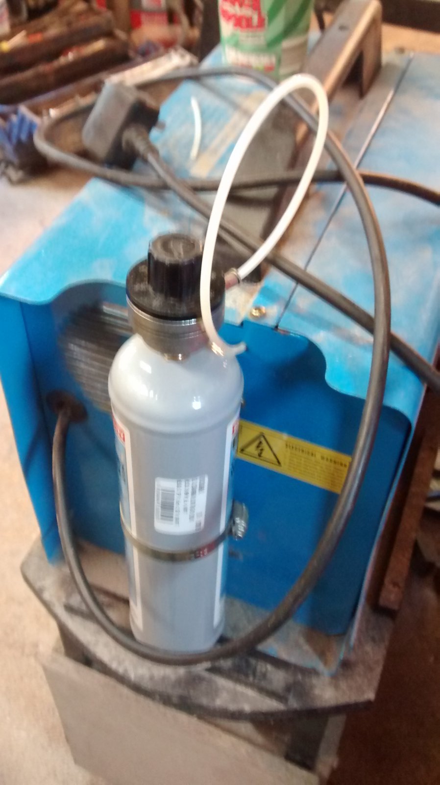

yeah bin them dont buy them again
get a contract bottle either hobby weld or a boc gas account via the volkzone offer

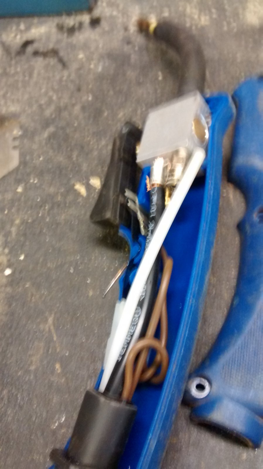

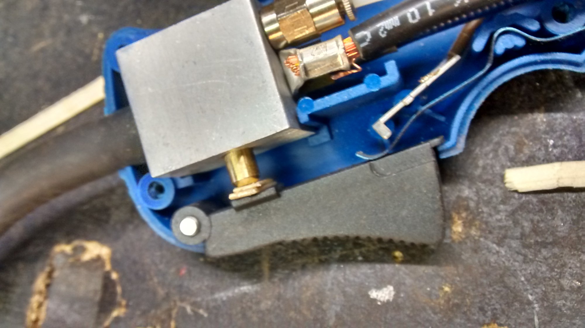

I opened up the torch and took the gas pipe off then took the end off the bottle. I then blew through the pipe and placed the other end in water and there were bubbles so the pipe isnt blocked. i then put the old regulator back on and i had to really force it round to get gas top come through but eventually it did. The next thing to try will be to take the valve off and have a look at that.
