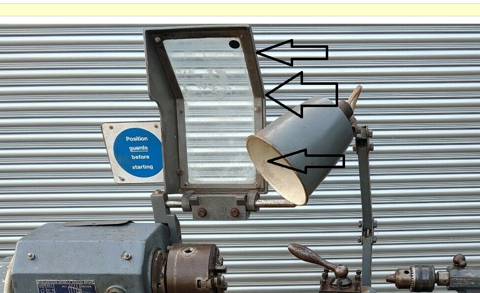

Too wide in my opinion, it should just be as wide as the jws, any further obscures your view and serves no purpose,
that one has a lip on the front edge,I would also have a lip on the front edge.
Doesn't look to be much of a lip if any, I am meaning along this edge.that one has a lip on the front edge,
ah that edge i thought you said the front

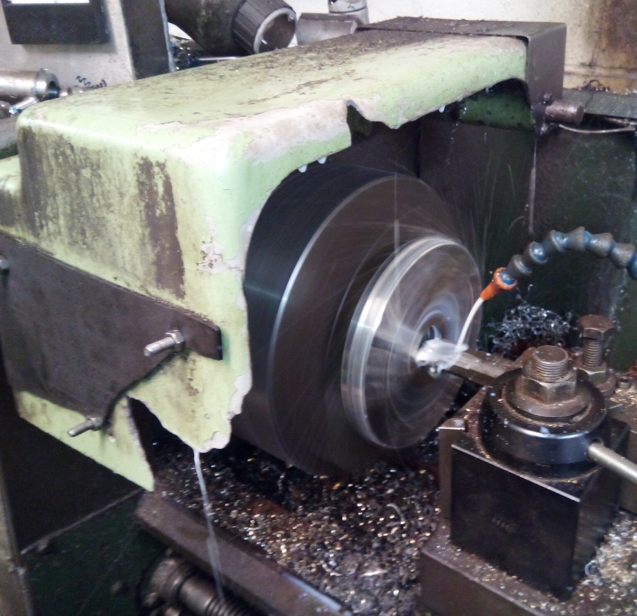

I would also do similar to the way the Triumph one I have works.

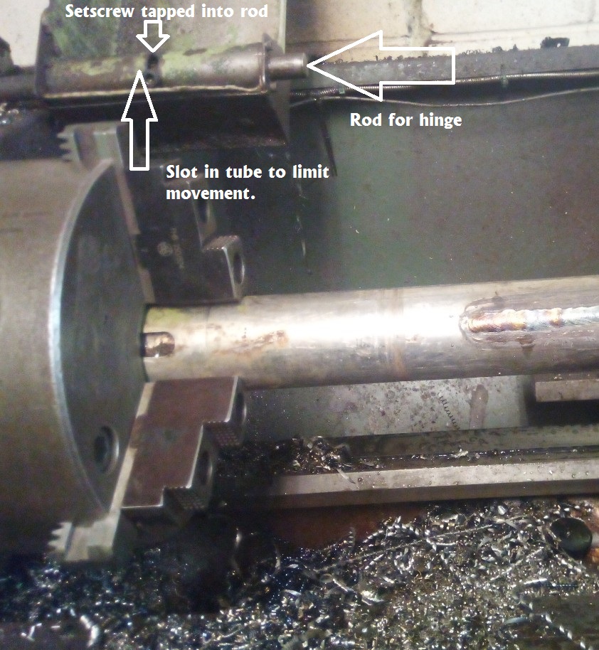

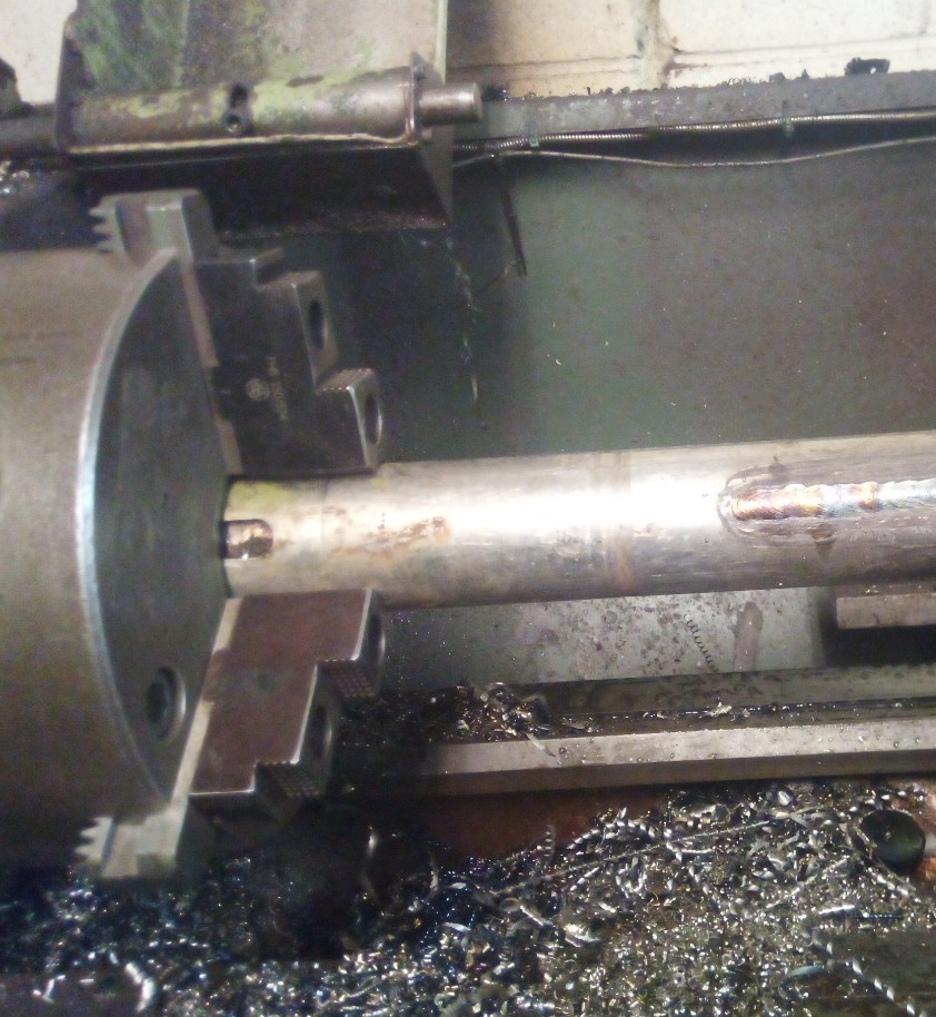

The Image above that you posted is very similar in function to the one that was on my Colchester Student (Round Head) and as I said I felt it too wide. The mechanism for stopping it was also similar in that it came down on hard stops. That in itself worked well but for ease of manufacture the Triumph way is easier. A rod for the hinge, a tube attached to the guard which slides over the rod and a slot in the tube that a setscrew protrudes through and allows only enough movement to set it up or down. Very simple to make and if you find the slot is slightly too long you can rotate the rod slightly to offset.
