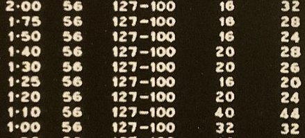

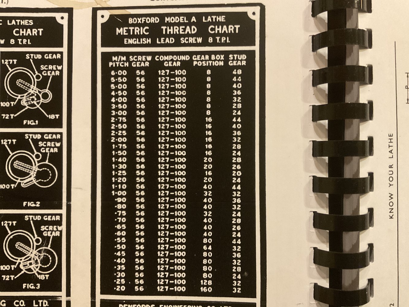

Normally turn it over to mesh on the outside of the big gear as shown in the diagram, ineffect using a gear not in use behind as a spacer.true i want to learn
will I need another gear then if the box gear is not 56
no I do notDo you not have a set of change gears as well?
You need the right one for your model lathe. Itgives you a larger range of feeds and pitches with fewer change gearsgreat thank you I will print this off later.
what does the gear box do then
I think that is. Mine us a Aud I will have a look tomorrow.You need the right one for your model lathe. Itgives you a larger range of feeds and pitches with fewer change gears
I did go out to the workshop especially to take that photo. My translation great stays in situ.Sorry, I meant it was a photo you already had in your computer ('in stock') that happened to show the translation gear in the correct place, but not being used as a translation gear. You had not gone out to the shed specially to take one in answer to his specific question about how to set up for cutting metric threads.
As you say, the smaller gear acts as a spacer for the 56t, which engages on the 100t wheel.Normally turn it over to mesh on the outside of the big gear as shown in the diagram, ineffect using a gear not in use behind as a spacer.
is that the lower wheel in the stock picture! with 46 on it?As you say, the smaller gear acts as a spacer for the 56t, which engages on the 100t wheel.

A point to note, @a111r came to me few months back for me to cut a special screw for him. I looked at the wheel and thought, that's not a 56 (it has 44 cast into it). I spent ten or fifteen minutes in a fruitless search for my 56t wheel. Later on, having found another way around the problem, I counted the teeth on the wheel. Yes, 56![]()
