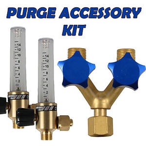

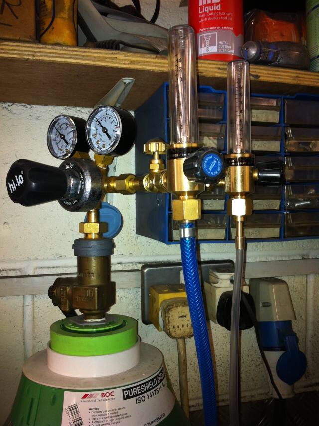

Could some brave soul pls explain what I need to have a second argon line from the bottle to enable purge for ss welding .. I can see the set up at the workpiece but what's needed to have two lines off one bottle pls X
