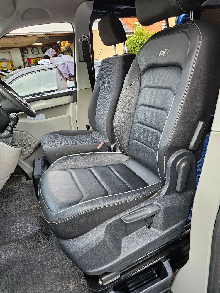

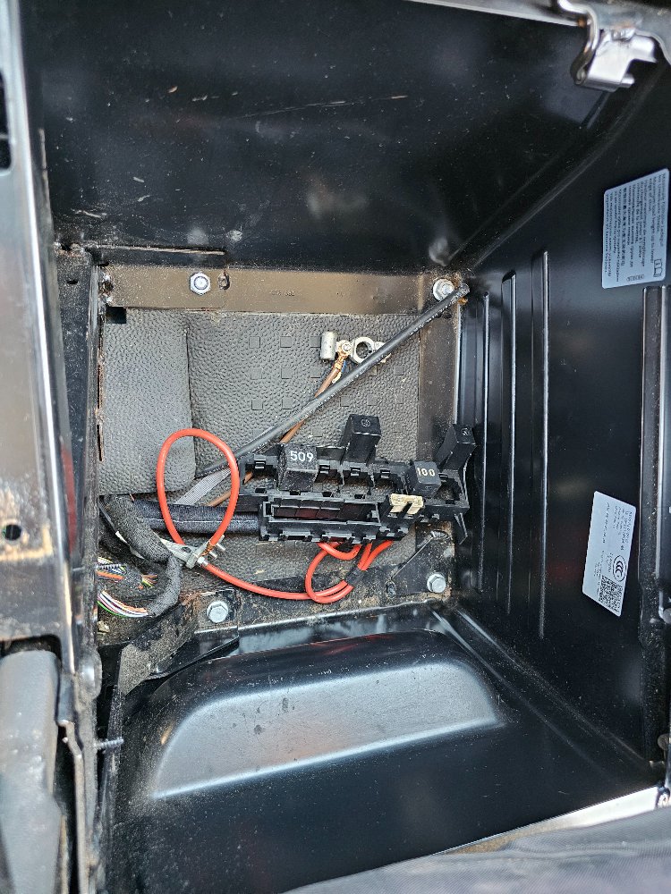

I saw a cutaway Range Rover seat to display how they're made, I'm sure it had more wiring inside than the whole of my first car had!I have been scratching my head with the wiring for the drivers seat. Its out of a Tiguan, wiring on the seat base is all there but obviously the Transporter does not have the corresponding wires. Its go the memory function and it needs wiring into the BCM and the van being told its there for it to work. I did poke around with a power probe to see if I could at least get it into a position where it fitted me but no success yet. Time was not on my side as we were getting ready to go away so its now on the roundtoit list

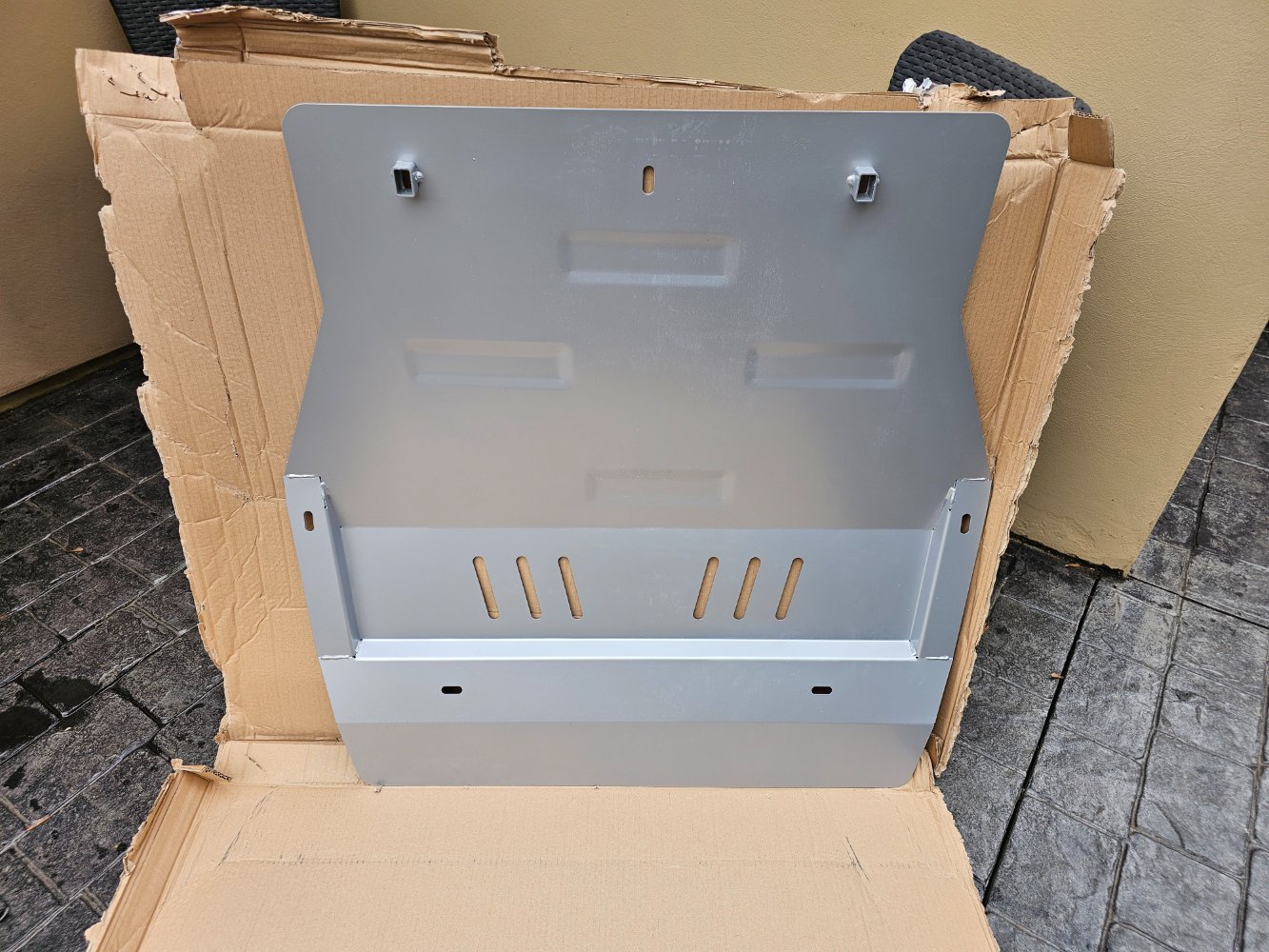

It may not have been missing the under-tray, they were an optional extra after about 2012The van was also missing its undertray, they are only plastic but do cut down on crap covering the engine. More of a concern is the AC pump is the lowest part of the engine
Ordered this steel one from eBay and fitted before Christmas
Who's kit have you got, PF Jones? the wire that tells the BCM is only for the silly light in the dash. got a 2009 4 motion and its never been a problem.Why am I not surprised, seems that everything is an extra on a Transporter
Annoyingly, tow bar prep is an option mine doesn't have, so instead of just plugging the tow bar wiring to a connector above the rear wheel arch and telling the van its there, I have to run a loom from the tow bar, all the way under the vehicle to the engine bay. There is a section that T's off through the floor under the passenger seat and another that goes through the bulkhead to the BCM![]()

Yep, PF Jones, mine has park pilot reversing sensors, not sure if the BCM stuff is to turn them off when you are reversing with a trailerWho's kit have you got, PF Jones? the wire that tells the BCM is only for the silly light in the dash. got a 2009 4 motion and its never been a problem.
And I have not attempted fitting of said loom, I keep looking at the inside of the van and could I run it through the van rather than underneathWhy am I not surprised, seems that everything is an extra on a Transporter
