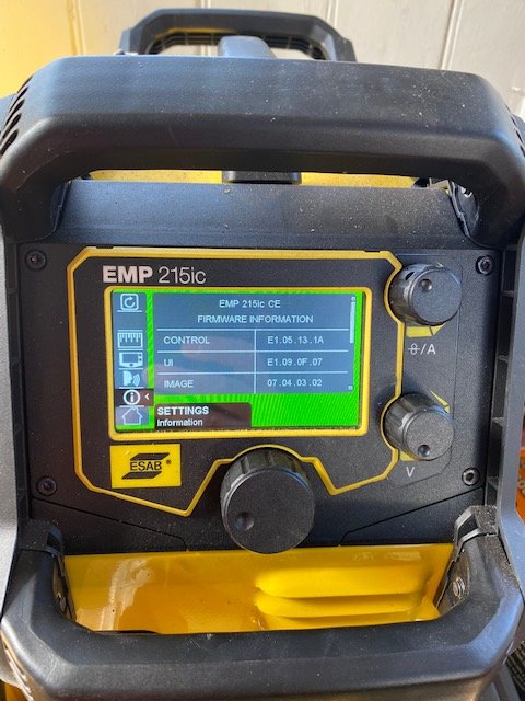

for those interested page 24 & 28 contain all the infomation re the spool gun https://www.manualslib.com/manual/1244401/Esab-Emp-215ic.html
A quick look at the Aus manual does show that you should have an option on the left hand side of the screen (in s-mig or manual-mig mode) to switch between torch or spool gun.
This is on a machine with euro connector.
It looks like this is showing all the time (regardless of having a spell gun connected) so more than likely at least a software solution is required.
If yours is triggering the mig (presuming there are NOT 2 little pins inside the euro connector on the spool gun?) It would suggest at least some of the wiring on the 8pin is in place.
Get the wiring diagrams and see what's what.
Or, as earlier, plug the tig torch in and see if that will trigger the wire feed motor in mig mode. That will at least give you more of an idea on how it works.
There was never a spool gun option in the UK. That’s probably why it doesn’t work!
thanks Hotponyshoes, you can now see why I thought that it would just work, the machines look identical, and the spool gun said made for the rebel emp215ic, so I am sure it is just a software thing

I don't understand why anyone in this day and age would make hardware that can't be simply flashed with a USB file etc.
Upgrades like spool guns etc - in this case it would have worked well, if the firmware had been designed properly?
Because it’s chineseI don't understand why anyone in this day and age would make hardware that can't be simply flashed with a USB file etc.
