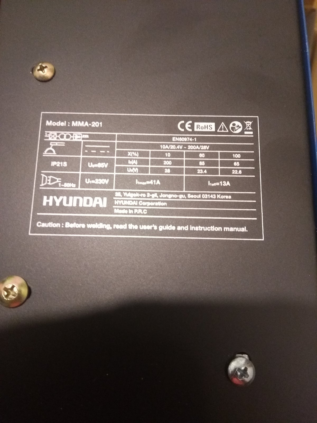

I had a closer look at some picks on Hyundi website and at least one of the cables seemed to say 16mm squared, so they'll probably be using a 10/25 Dinse connection for those. I'm in the process of adding another Dinse socket my welding machine, so thought if I'd match what this machine uses, I could use the one lead for both in the event I buy one. Thank you for checking that for me.
